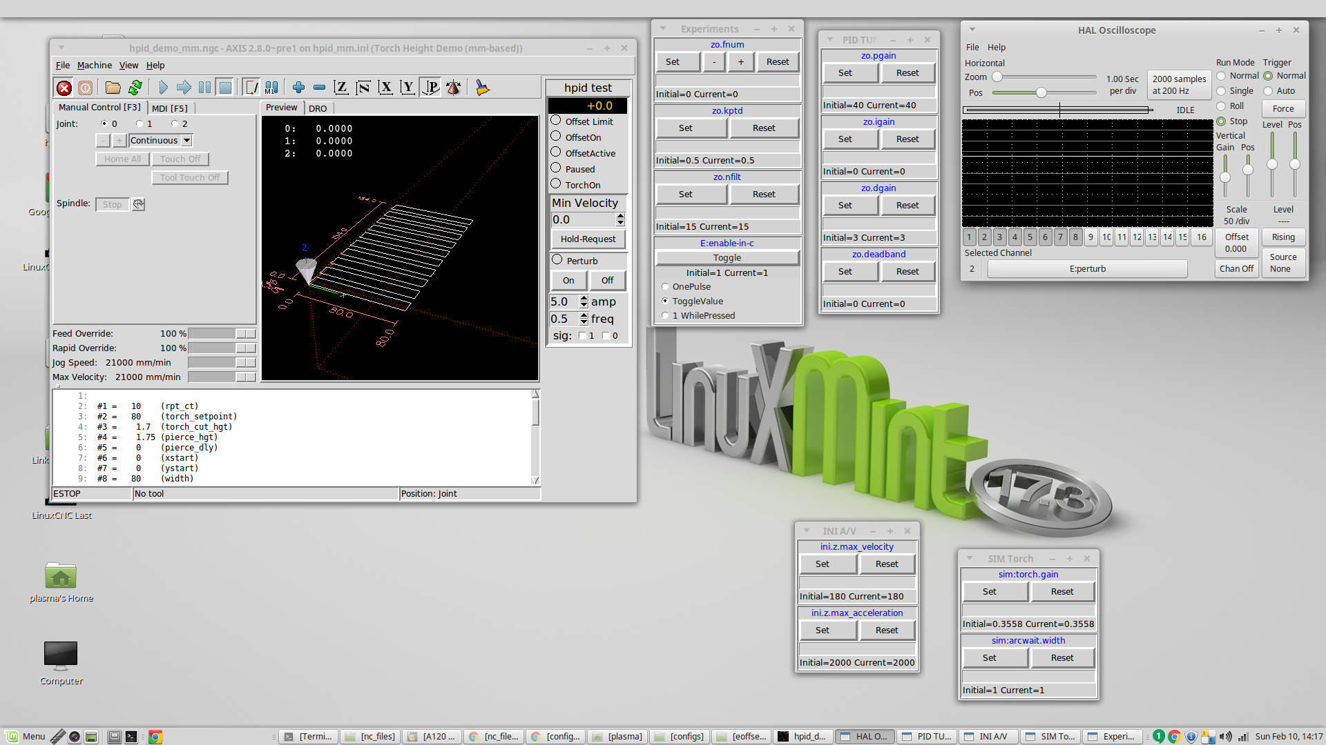

John, thanks I don't really need examples of shared homing. I've had it working for ages until this week! I don't expect metal thickness will change the pid settings from earlier experience.
Well, I think I have a remap working on a sim. I tried to get it going once before and failed due to my inability to do a simple cut and paste from one config to another but I had more luck today. If I am going to persevere with the eoffset code, it expects a minimum velocity to be set to act on the corner lock.
I now suspect poor air quality as being a major factor in tuning issues I experienced in the past. I'm just waiting for an electric tank drain to arrive to complete my air setup.
Its only +34 degrees C as I write this, not looking forward to going up to my workshop to implement this....
Tommy, this is not really a useful gui at all. It resembles a Frankenstein lab as it opens up countless tuning windows on startup to change configs on the fly. It also opens up the Halscope Oscilloscope with all key signals traced. I think the only useful part on the GUI is a LED that shows if the torch is on (in case you can't see a shower of sparks!)
I'm sticking with it for now to keep all of the config as close as I can to Dewey's original eoffset-pid config from the external offsets branch as he removed this component from the branch when it was merged with master branch. Hopefully, a working config will encourage him to republish it in master branch where it deserves a second chance!
I've seen your updates and will have a closer look when I get the chance. I don't want to change anything now as it will be a distraction from getting a working machine that I really need right now!

I think you've hit the nail on the head. My GUI and PP have every possible adjustment available to the operator. In routine production cutting I make no adjustments. I only make sure that the torch is enabled (I intentionally made this a required user setting) and that I choose to use cutting parameters from the cut file or the GUI. I know that if I was running a job shop that cut many different thicknesses and materials every day that this wouldn't be the case. I think this is because we all have such unique systems that we don't know the cutting parameters until we actually start using them. If you look at some of the attempts by commercial offerings to simplify things by using many tools in the PP to cover all possible combinations of materials and thicknesses you will see how plasma cutting needs a wide range of settings that need to be set some place.
