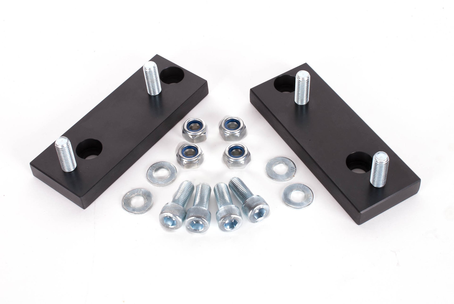

This one is holding me up. A bash plate for a 4WD that makes more room for a relocated swaybar
I've already made the swaybar relocators and had the aluminium anodised. This was cut on a CNC mill by my neighbour.
I'm not very good with sheetmetal designs.
