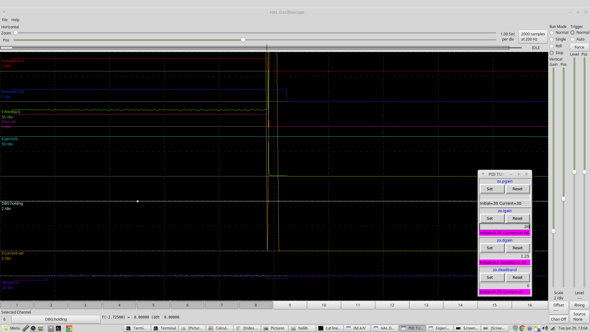

Andy, thanks for that. Yes I spent many hours of testing both in Dewey's sim and on the table itself. I even plotted voltage and height with a 16000 point data set to get the sim scaling correct. From memory, I think Dewey said in the docs I gain was not likely to be useful as it was running inside an outer control loop or something. I did try it and it went crazy with small amounts added. In the Sim, it seemed to move the voltage plot up or down from the set point. Maybe the Inner/Outer loop stuff might be behind PCW's theory.
Replied by rodw on topic Rods "Spaceship" Scratch built Plasma Cutter build
The reason I want to slow down the THC thread is that Jim Colt from Hypertherm has said trying to control the Z too tightly or adjusting too quickly results in oscillations. Also, a paper I found on Industrial PID control said that motors should not be controlled too tightly
You wouldn't normally do that by slowing the thread, you do that by turning the gains down.
Have you tried lower gains? I think I would expect it all to be handled mainly by I gain.

I had a look at an old .ini file of yours from last spring. In that file you have a Z axis step scale of 1000 (1000steps/mm?), if so that is about 4 to 10 times more resolution than you need. As I recall you have a belt driven reduction driving a ball screw on your Z axis. Reduce the micro stepping on your drive by a factor between 4 and 10 and you should see a torque increase. I don't know if your drives do step morphing but my Geckos change from 10 to full step at about 1/2rps motor speed to get morel torque when moving fast. The max speed on my Z is 220ipm or about 5.588mpm and when cutting it is limited to between 1/2 and 1/3 of that for stability, I don't cut corrugated sheet.

Microstepping doesn't decrease motor torque.

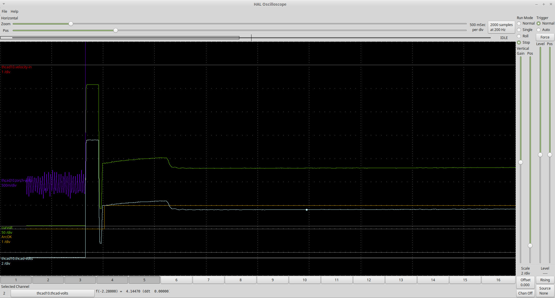

They don't make it easy for you. I had problems earlier in the week getting a voltage into the THAD board. So after a good few hours this morning starting with a 9 volt battery, wiring in a multimeter, reverting to raw arc voltage and adding the appropriate scaling resistors, the problem was the polarity of both the raw arc voltage and divided arc voltage were reversed from both the manual and the diagram on the machine itself. This is the second machine I've had with incorrect documentation.
This looks about right. 126 volts vs book setting of 131 volts for this cut
So now a question for PCW. With the 30:1 divider selected, the THAD is hitting its full scale briefly at the beginning of a cut. You can see that in the halscope plot above. Is this anything to worry about or should I change the divider settings so it stays in range?

You can overrange the the THCAD10 input 50X (500V) continuously so there's nothing to worry about. As a matter of fact, overranging the input is a valid way to get a bit better resolution if you dont expect to run the height control at say >200V
