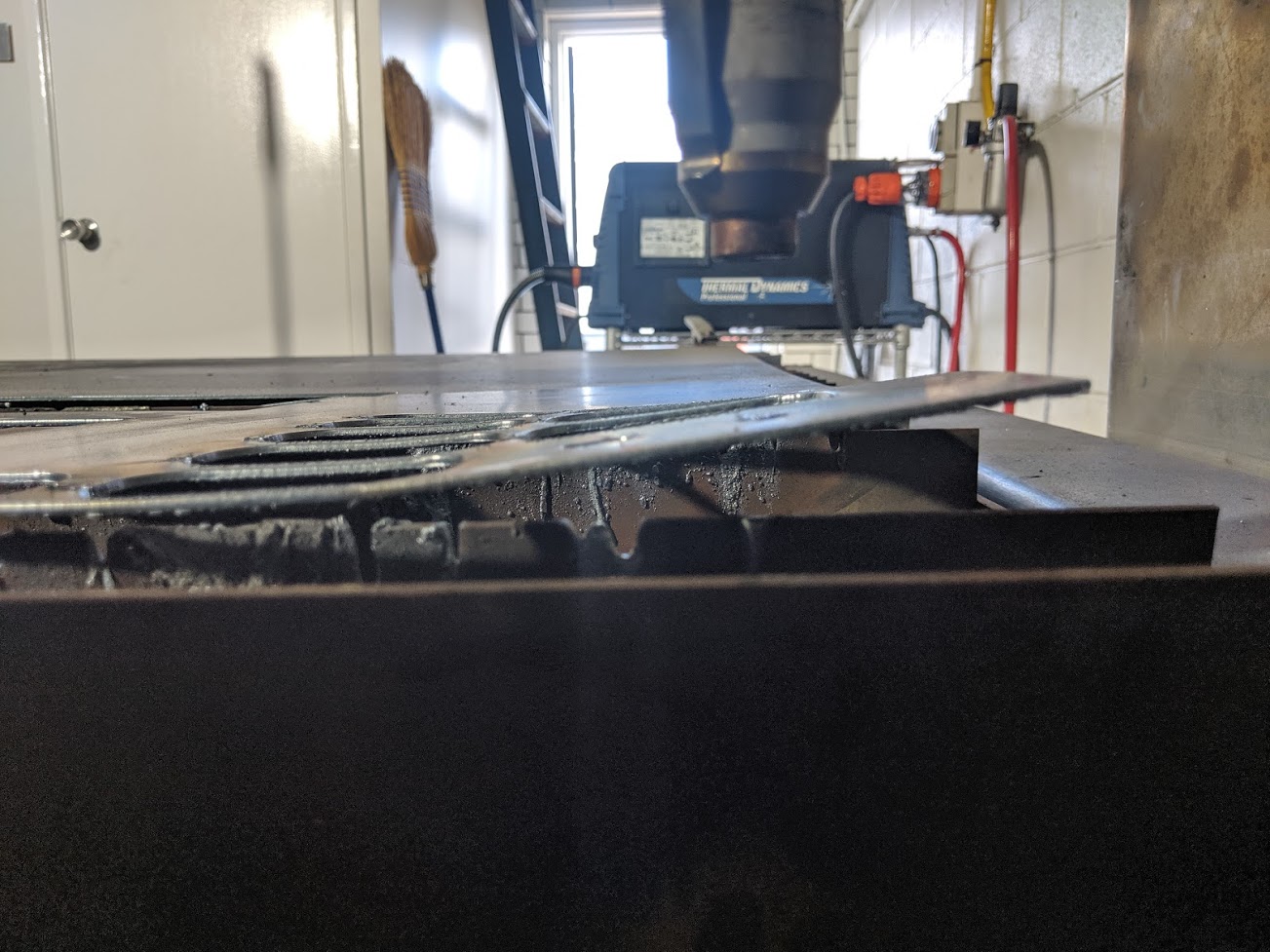

24 May 2019 23:46 - 24 May 2019 23:47 #134859 by rodw
Here is another video for Grotius with the probing time a lot faster. I still need to start fairly high upon this 2mm thick material as at the edge of the sheet can lift by as much as 30-40 mm due to warpage. Particularly if you bump the amperage control accidentally and cut at 120 amps instead of 40 :)
But even cutting at 40 amps, the warpage was similar. A couple of times near the end of the run on the far edge I held the material down for it to probe and plasmac kept the torch cutting even when I let it go and let it spring up 30mm or so. So its very responsive to changes in material height.
I'm still learning about Sheetcam. It would be good if it cut an array of parts in the X axis direction and I think it would warp less.

25 May 2019 03:44 #134869 by rodw
Phill, the biggest issue is endless Z axis loops on probing if the ohmic sensor is triggered before you get to probing height. This can happen due to warpage. Holding the material down flat allows it to probe correctly and continue.
An example where it occurred.
I think I have some video I'll send you.
25 May 2019 03:54 #134870 by phillc54
Rod,
Yes, I got the video.
That is quite a bit of warpage...
If you decrease Ohmic Probes in the Run tab it will fallback to float switch quicker. I probably should rename the Ohmic Attempts
That does show why I am not 100% happy with probing.
Cheers, Phill.
