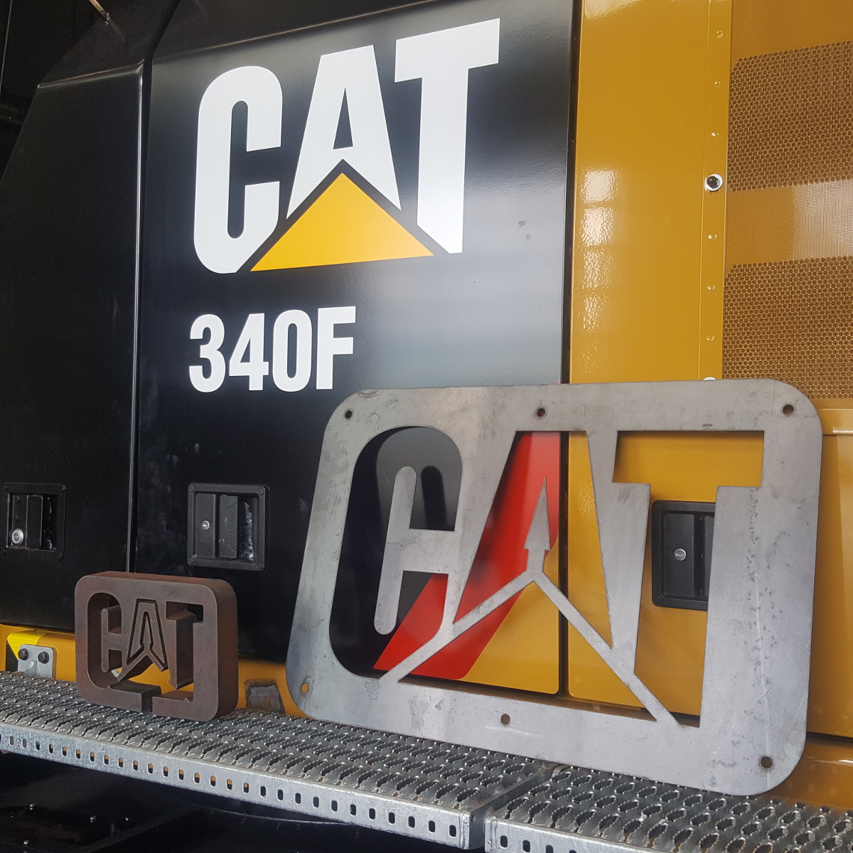

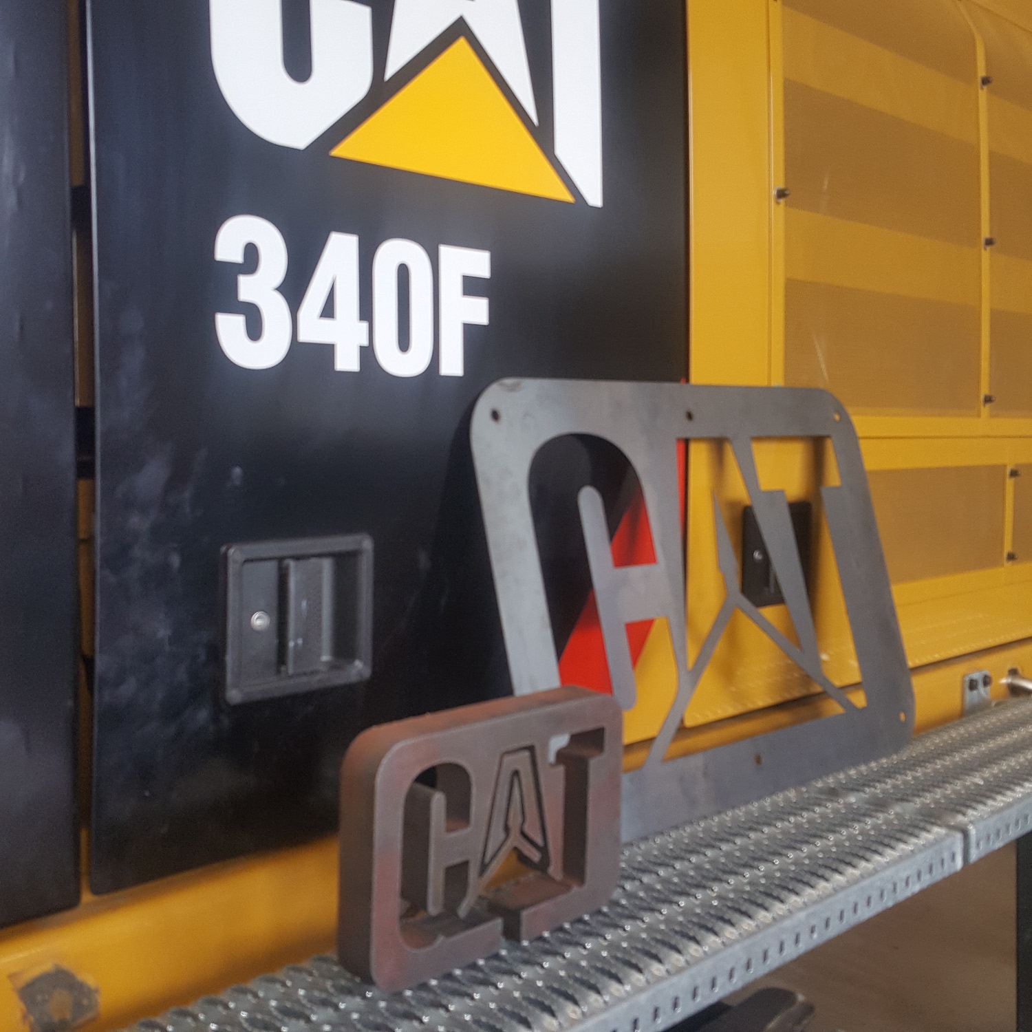

Rod,
Thank you for all your work so far to the plasma topic's and your own plasma topic !!
Thank's to your examples i made a c component earlyer.
You mailed me explaining code examples and so on. So i am thankfull to you !!
So credit's for cutting this 40mm thickness piece with bridge 6mm go's to you, it's cutted at 200 amps.
The picture is made during the plasma training course today.
Linuxcnc is used by Pon Catterpillar. They are very happy with linux.
It's cutted with a Thermal Dynamics XT200 today.
The big logo was cutted as a present for a 25 year employee.
We have official approval to use (integrate) the Thermal Dynamic's cutting chart's into open source software.
This approval is sent to me by in.linkedin.com/in/matthijs-piersma-61942a14
He can add Tommy to the OEM list. I have done some work for Tommy. They can sent to Kosovo.

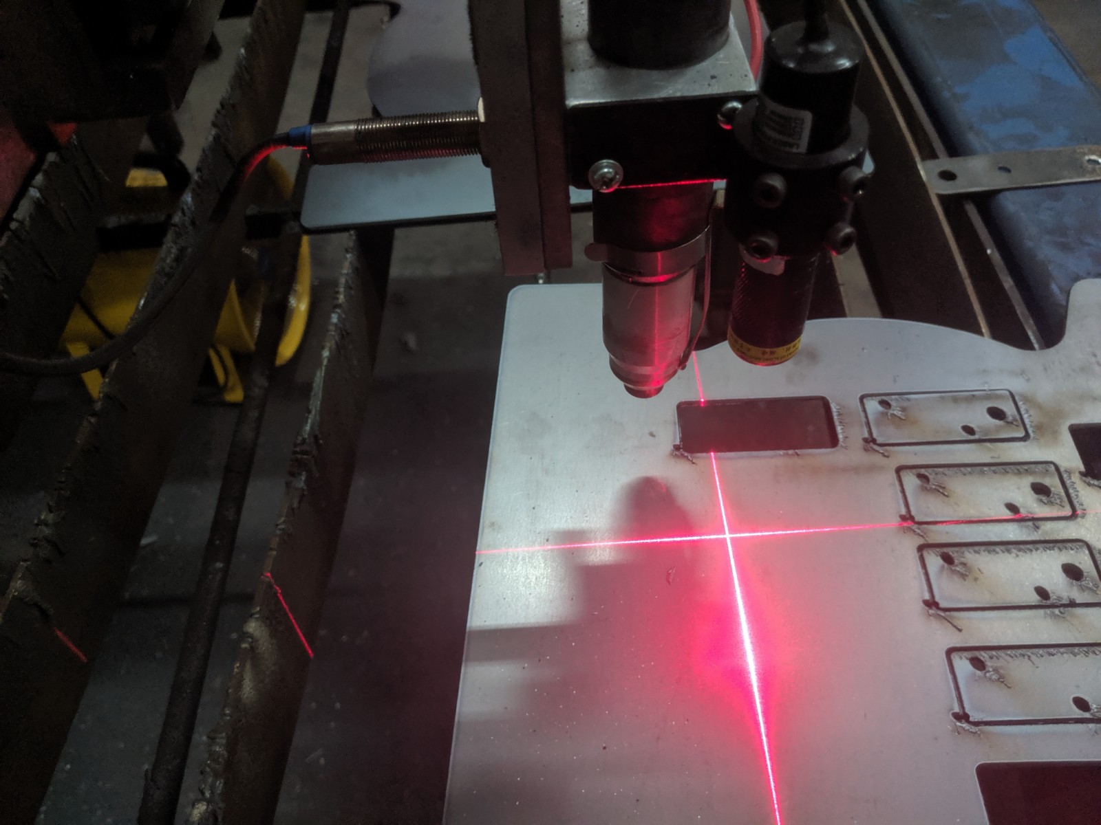

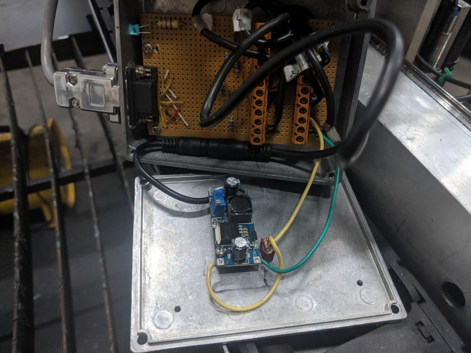

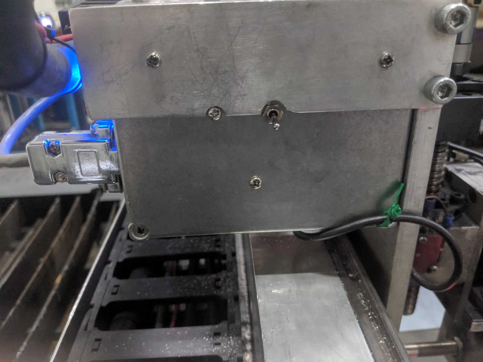

I decided to put a laser pointer on my plasma cutter so I needed to get 5 volts up on the gantry to power. As I had 24 volts up there in a metal breakout box for all of the sensors so the easiset way as to get a small buck power supply off ebay.
But I had no spare wires in the cable running up there so I had to add a manual switch instead of using an output on my 7i76e
So now I have a crosshair pointer.
So to calibrate this, I burnt a spot at coordinates 0,0 and then jogged until the crosshairs were over the exact centre of it and recorded the offset. Then I added a couple of Gmocappy macro buttons that I called Laser_On and Laser_Off. By aligning the crosshairs where I want to cut, I just hit Laser_Off and it moves the torch to the crosshair position and then I just need to touch off in the usual way.
If I want the lasr to be at the crosshair position, I just need to press Laser_On.

Rod,
Looks good. You could probably get the macro to do the touch off as well using G10 L20.
Cheers, Phill.

Phill, thanks, so if a the laser pointer X & Y offsets were 20mm and 30mm, would do something like:
G10 L20 P1 X20 Y30
so then would a G0 X0 Y0 put the torch where the pointer was?
I know there is a way, I just don't understand G code enough.
G10 L20 P1 X20 Y30

Yes, something like that. If you use P0 it will do the current co-ordinate system. Or you could move first then set it to X0 Y0.

Phill, thanks this did the trick for me nicely. After the torch moves to the crosshairs at the end of my macro, I addedYes, something like that. If you use P0 it will do the current co-ordinate system. Or you could move first then set it to X0 Y0.
G10 L20 P0 X0 Y0 and I have an instant touchoff ready to start cutting.
