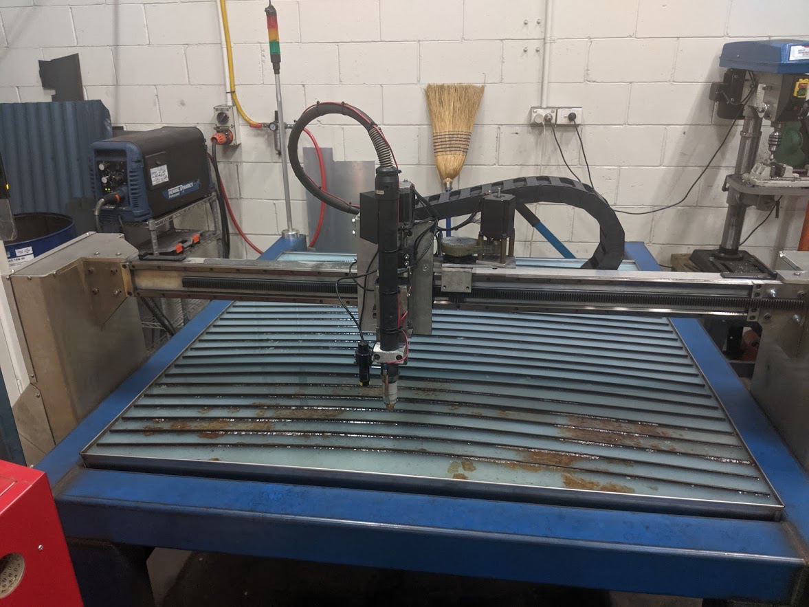

Replied by tommylight on topic Rods "Spaceship" Scratch built Plasma Cutter build
Make the slats slimmer, thank me later !
- Posts: 12135
- Thank you received: 4141
24 Sep 2019 10:57 #146054
I'm lost Tommy. Lower you mean? They are only 5mm wide.
Replied by rodw on topic Rods "Spaceship" Scratch built Plasma Cutter build
- Posts: 21899
- Thank you received: 7465
24 Sep 2019 11:05 - 24 Sep 2019 11:08 #146056
As you have it, the moment the fired torch goes near the edges you end up with 1/4 of the water on the floor.
Always make it you you can submerge the material and still cut without to much splatter.
Mine are always 100 to 120mm deep, slats at 70 to 80, so i can put a 20mm plate and still cut it submerged.
If the machine is used a lot, that also causes the nozzles to last longer and piercing does not affect them as much.
Have a look at the big industrial plasma systems, they all cut submerged.
Oh, BTW, never switch off the plasma cutter after submerged cutting as the water might remain inside the nozzle and cause it to rust, just give it a moment for the air to dry it.
And 5mm thick slats are to much and will impair the cutting a lot, never more than 3mm.

Replied by machinedude on topic Rods "Spaceship" Scratch built Plasma Cutter build
since slats are consumables thinner slats lower your operation costs as well. both the lasers we have at work have the shark tooth design for slats too. lets the material from the cuts exit better and helps the slag stay off the parts a little better.
- Posts: 12135
05 Nov 2019 20:37 - 05 Nov 2019 20:38 #149649
Just to clarify, my slats are 3mm thick. I had some issues with the pan after full assembly becasue a weld was leaking. After I got that fixed, I ended up with something like this.
I inverted the slats and even cut slots for clearance against the drop in frame for two slats after all of these years. The main issue with water loss is when the torch is parked at the end of a cut. This should be able to be resolved just by setting some parking values in my sheetcam post processor so its parked in the centre of the table until post flow is over.
Whilst having slats sunk lower than the sides might be OK on a full sized table, with one this size, I need to be able to index the sheet to cut from a full size 1200 x 2400 mm sheet which I will still be able to do with this tray.
I have had a couple of errors with a stuck ohmic sense signal due to water in the nozzle so I have set the Plasmac torch Pulse to be 3 seconds long. Plasmac pauses on the error so its a matter of waiting out the post flow, hitting pulse and resuming. I think this would be solved if I pulsed the torch to start the post flow air before starting the first cut. Just getting used to a water table I think!
