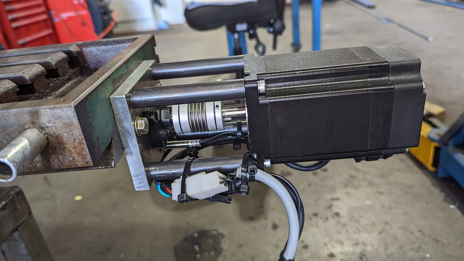

I'm trying to find a cnc conversion kit for nema motor and ballscrews etc to get started on converting my G0619 mill.
I see that cnc fusion is no longer making the endplates and nema mounts.
Does anyone have the capability to help me put together the parts I need?

Your mills is a rebadged Seig Super X3 (SX3).
I have a SX3. Not sure if there are kits sold for it.
You should be able to machine all the parts yourself as I was able to machine all the parts I needed to convert a round column mill to CNC on my SX3
The mount may not be pretty but they are functional and strong enough. I machined a male thread one end and a female thread the other end of the legs on my lathe.

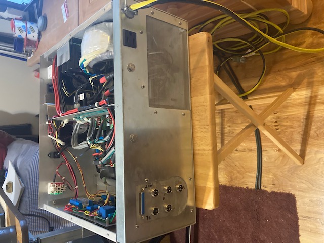

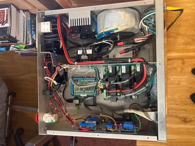

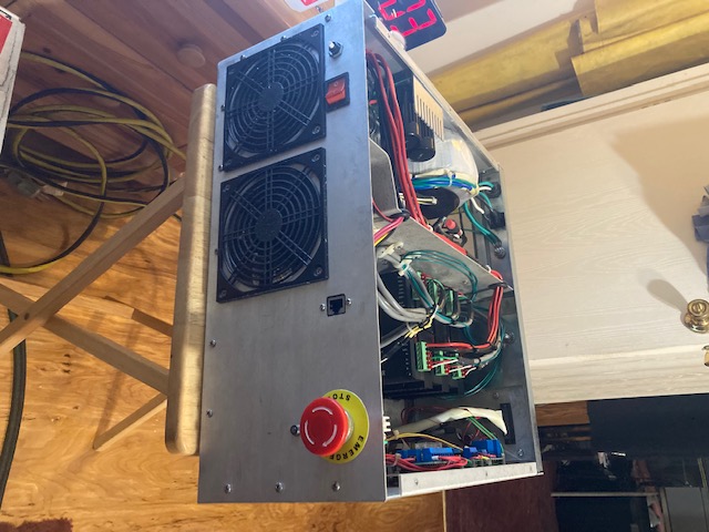

Well as usual I no sooner get going on one project and life decided to say " na you're going to be working on this instead ". So I have to pause the work I was doing on the Pick N Place and now get back to working on the Mill.
I am waiting for some cabling and parts to arrive and I am working on the final layout for the electrics. That sure turned into more of a challenge then I expected. Plus I am back to work almost full time. I will be posting a video update later today.
