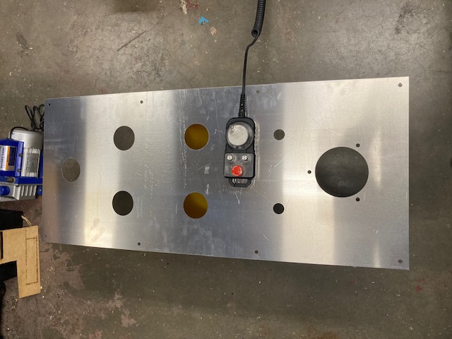

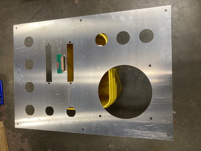

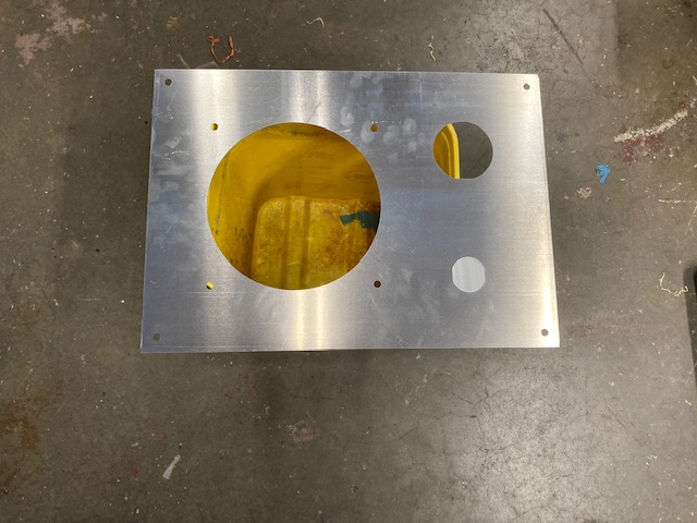

Boy time flies. It's hard to believe it's 2023 already. I had taken about a month to upgrade my
Anodizing line to make it more user friendly and more automatic. I can now get to work (5:30am) and
the tanks are either already at temp. or will be so when it's needed. On the G0619 I built most of
the external wiring . So I figured the next step was to cut out the I.O. plates . Unfortunately I ran into
an issue with my Autodesk Fusion 360 software. I sent a couple of DXF files to a company that does
water jet / laser cutting only to have the finished job be twice the size I had specd ( not their fault ).
Frustrating to say the least , more so at my self for not catching it and fixing it before I had sent it out.
Oh well it's always something.

14 Jan 2023 14:35 #261980
Replied by rodw on topic My Grizzly G0619 mill
That sucks. I always send a pdf drawing of the part with any DXFs we send out.
It might have let you blame them and not wear the recut!
Also the F360 DXF workflow I use is to:
1. Create a flat pattern and flatten it If sheetmetal
2. Add a new sketch on the flat pattern or surface of the part if not sheetmetal
3. Now in the tree, right click the sketch and save as DXF
4. Create a sketch showing outer dimensions and dimensions to any fold lines
5. send the pdf and dxf to supplier..
The following user(s) said Thank You: my1987toyota

15 Jan 2023 11:19 #262049
by my1987toyota
Replied by my1987toyota on topic My Grizzly G0619 mill
- Posts: 12176
- Thank you received: 4155
15 Jan 2023 15:46 #262070
Ouch! and you paid money for that?
And it does not even seem to be a metric thing!
Send a dimensioned drawing with it next time! Or build a plasma table!
- Posts: 22040
- Thank you received: 7505
15 Jan 2023 16:19 #262074
Replied by tommylight on topic My Grizzly G0619 mill
Hmmm, did you pay for the small ones or large ones?
