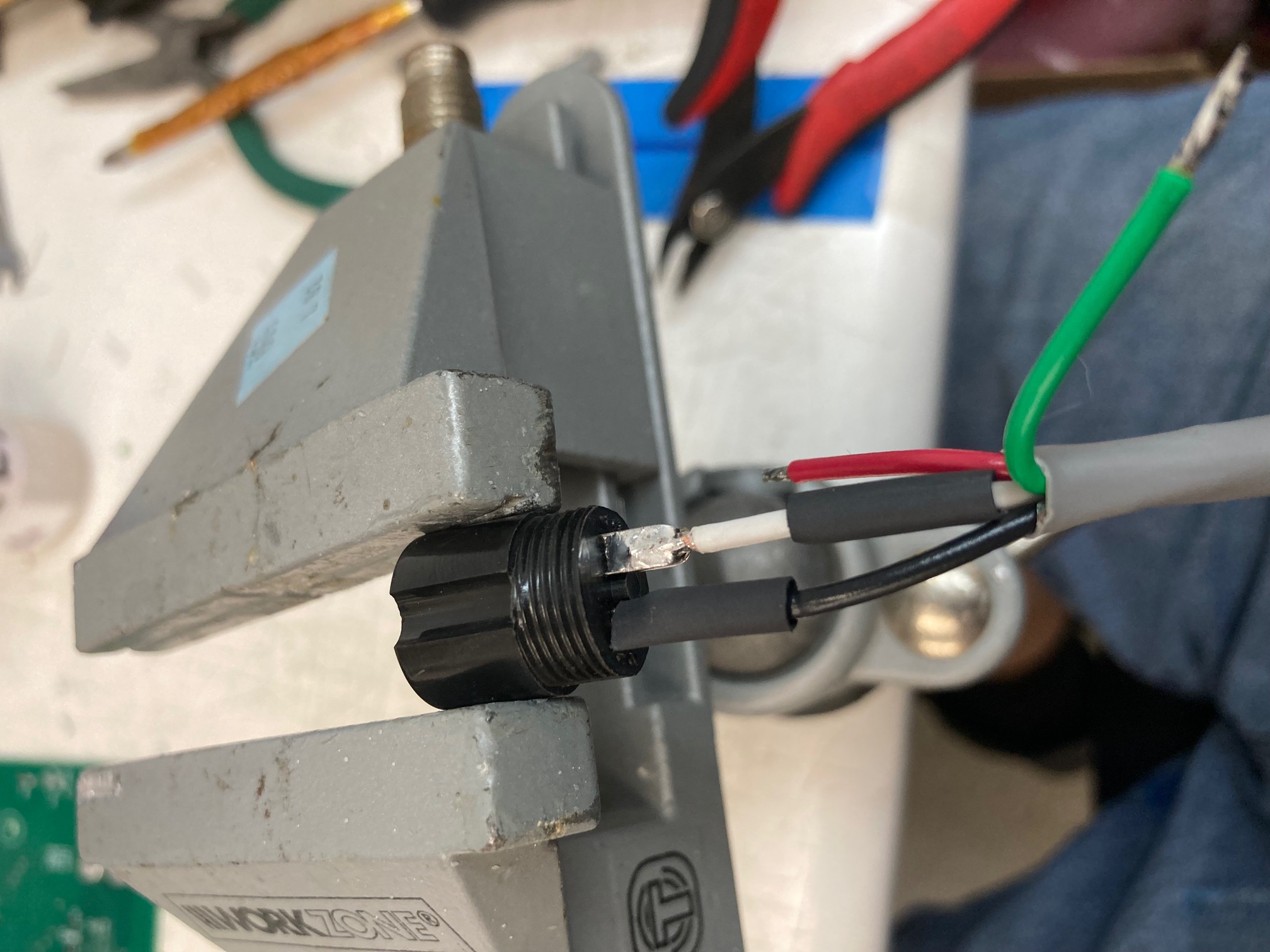

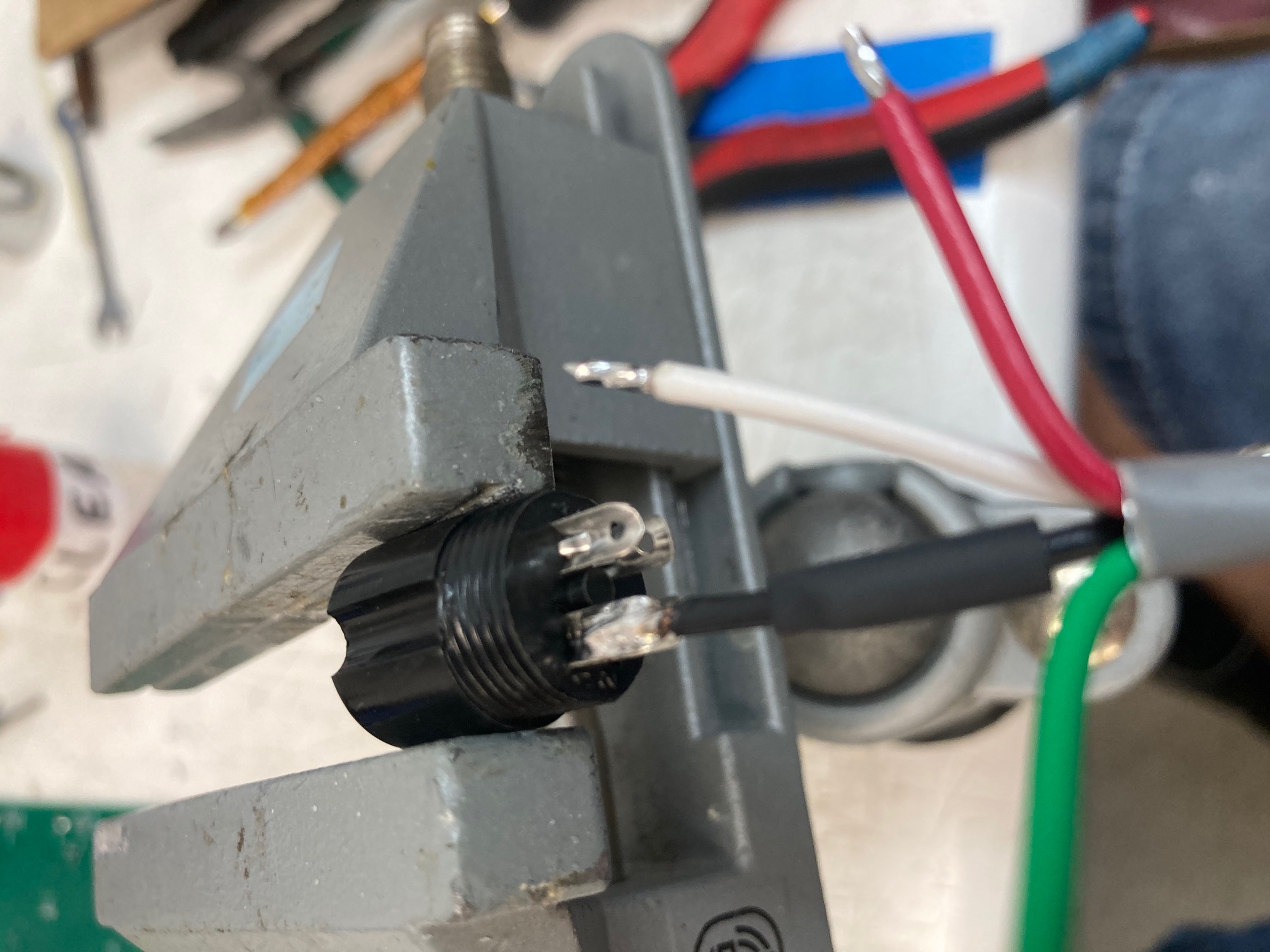

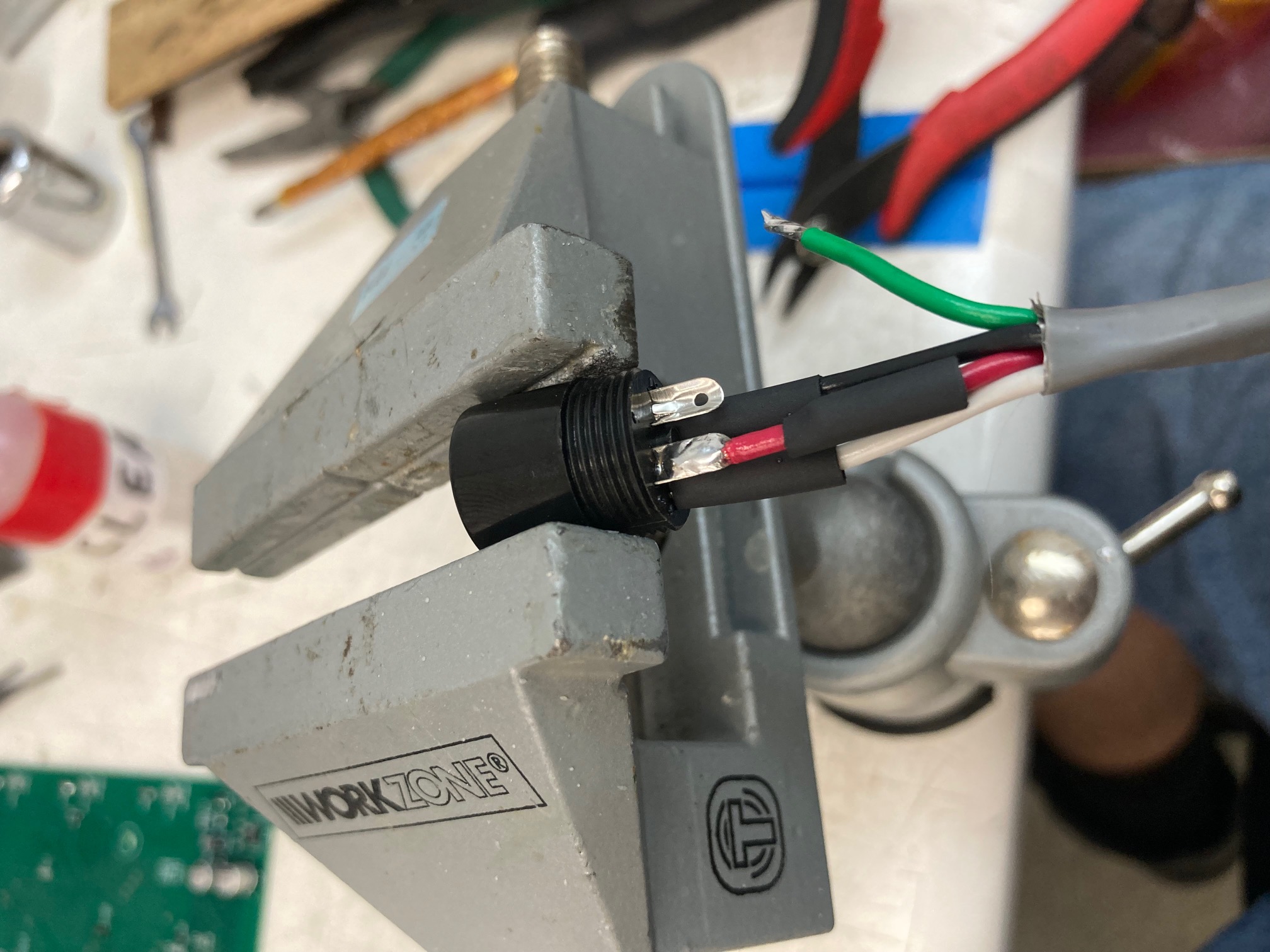

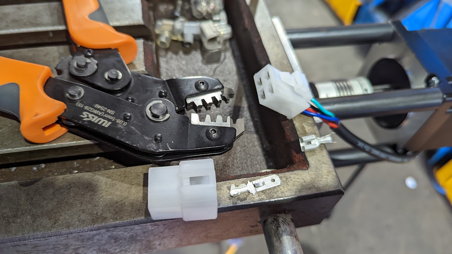

I had to go back to the beginning of the thread and refresh my memory because I have the same mill (still a manual). Really looking good.
I really don't like the GX connectors, so much soldering (although I must say my new Hakko iron is an improvement).
I have been using automotive QC connectors at the motor end. Crimp on and nice and light so they can hang in the air. First time around, I mounted GX panel mount connectors at the motors to support the weight of the connector. It's just a shame they are not compatible with the standard colour coded crimp on spade connectors.

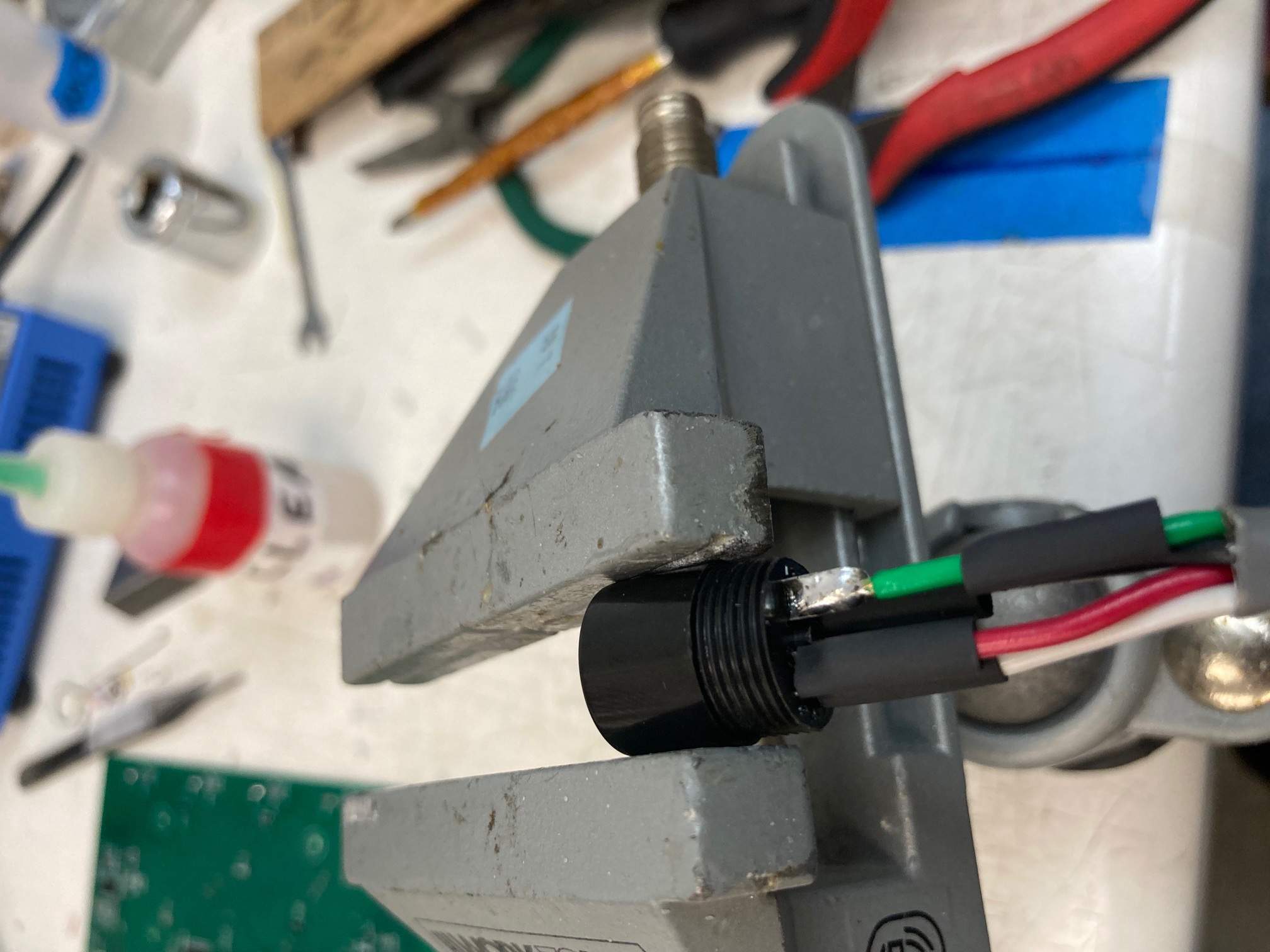

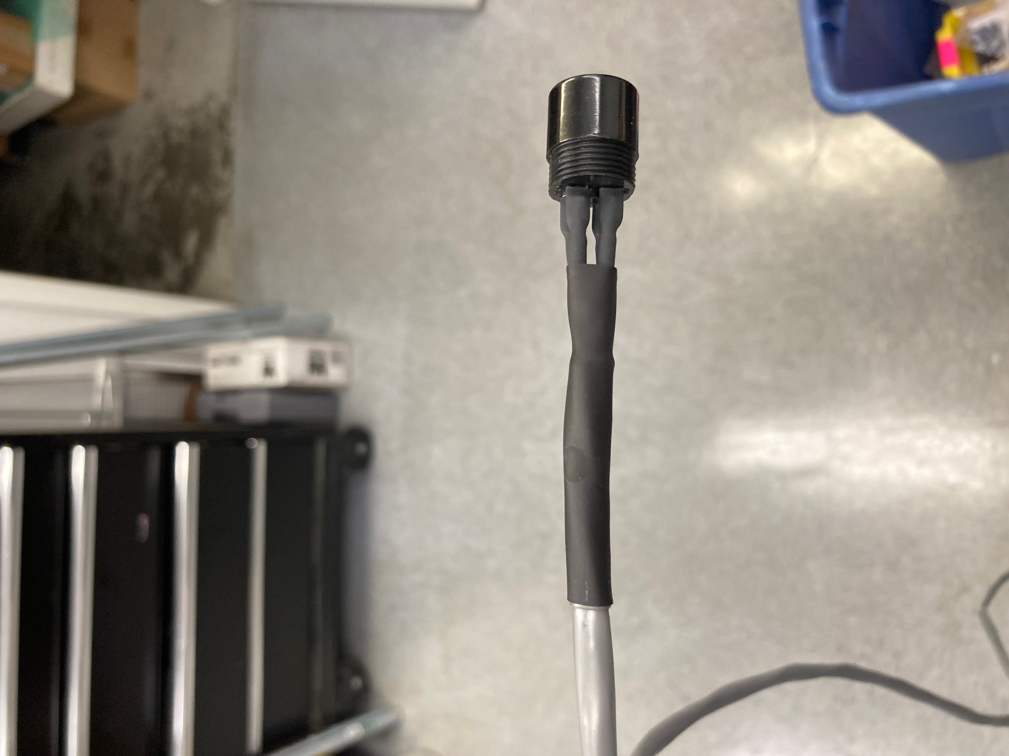

I am not the biggest fan of the GX connectors because you have to solder them and a standard soldering iron just heats the
crap out of the connector before the solder flows . That said I have a work around called Hako FR301 de-soldering iron.
it's the only thing I have that has enough thermal mass to heat the solder joint before the rest heat soaks.
I also up-rated my connectors to GX20-4 for the stepper motors.

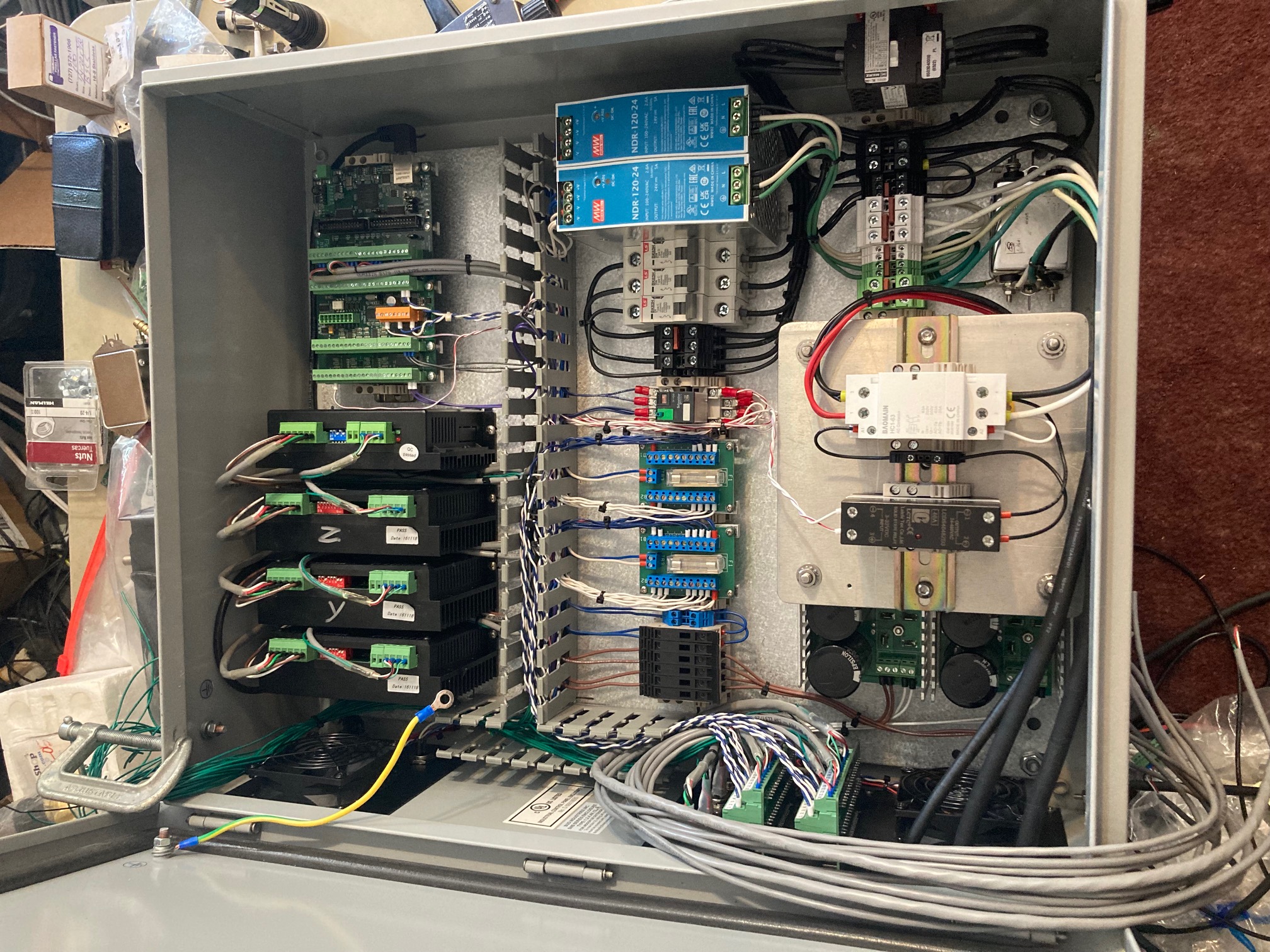

29 May 2023 01:49 #272386
by my1987toyota
Replied by my1987toyota on topic My Grizzly G0619 mill
- spumco
- Posts: 2167
- Thank you received: 896
29 May 2023 04:06 #272397
by spumco
Replied by spumco on topic My Grizzly G0619 mill
Nice. Tidy.
Especially like the double-stack over the power supply - those things always take up a ton of space.
Whats the board mounted on the left side? Field wiring breakout?
