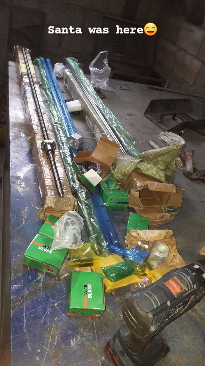

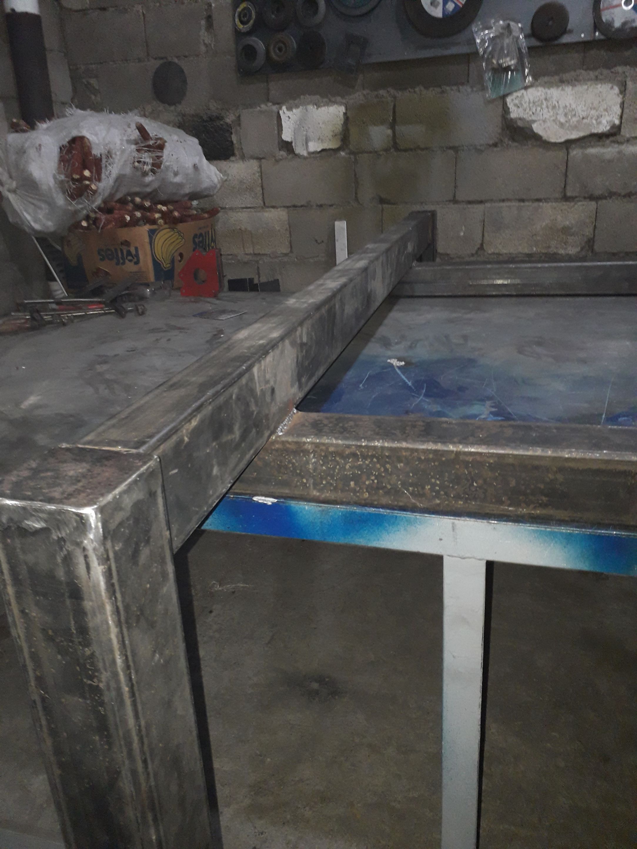

Starting a new project after some deep financial crisis.
parts
hgr 20 on Y with 16mm ballscrew
dual hgr 15 on X with 16mm ballsrew
nema 23 2Nm with dm542 drives
steel structure with 10x6cm and 8x8cm with 3mm wall thickness.
will try to upload pics as i progress
regards ,
Shpat
parts

Replied by tommylight on topic DIY CNC router build
Santa was nice !
The following user(s) said Thank You: shpatb

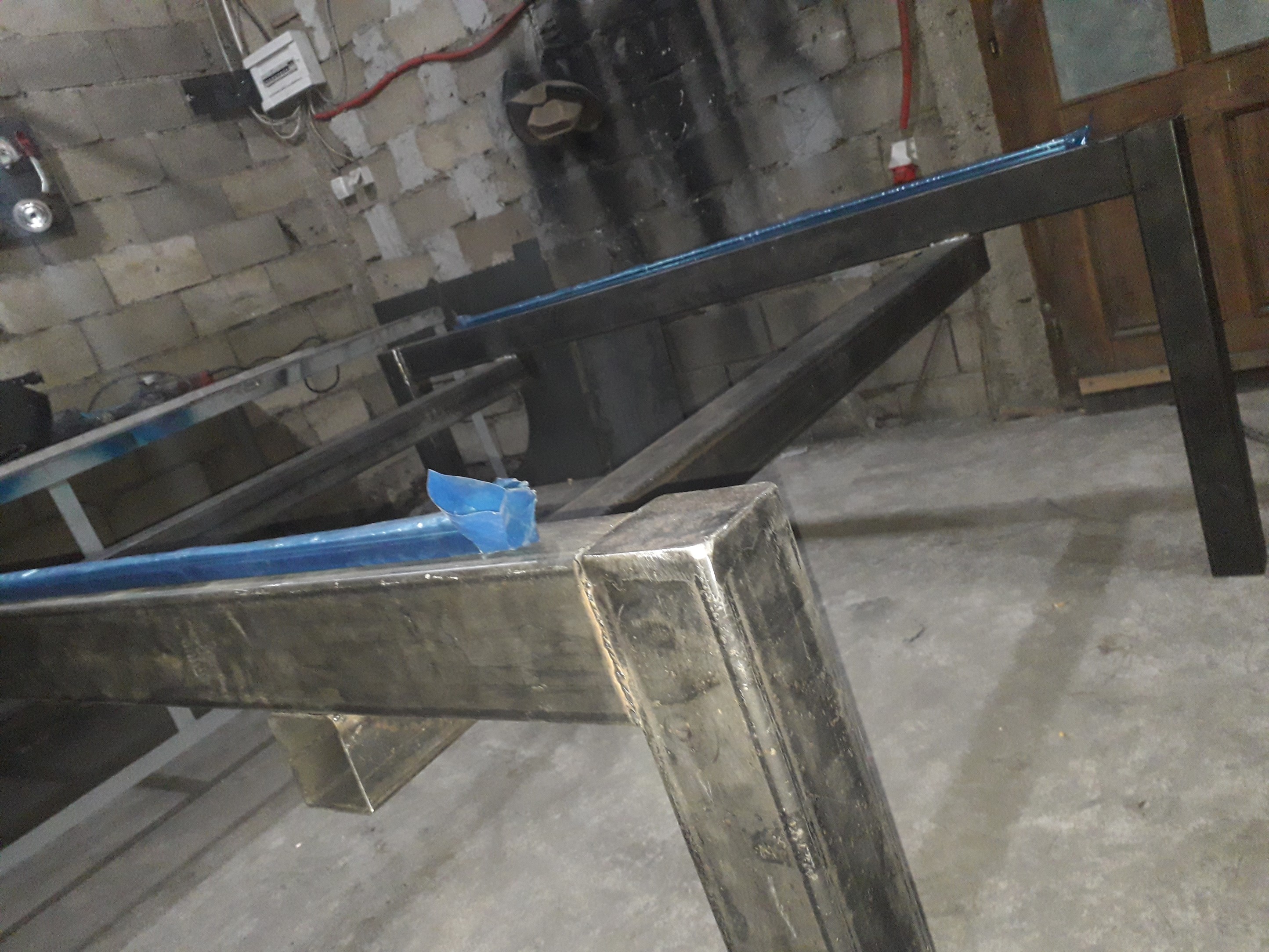

from 3 pm to 9 nonstop work , rested for like 5mins to stay hydrated
happy with results
ivan torrent and mig welding is good sound to hear ..
stay tuneDD!!
happy with results
stay tuneDD!!

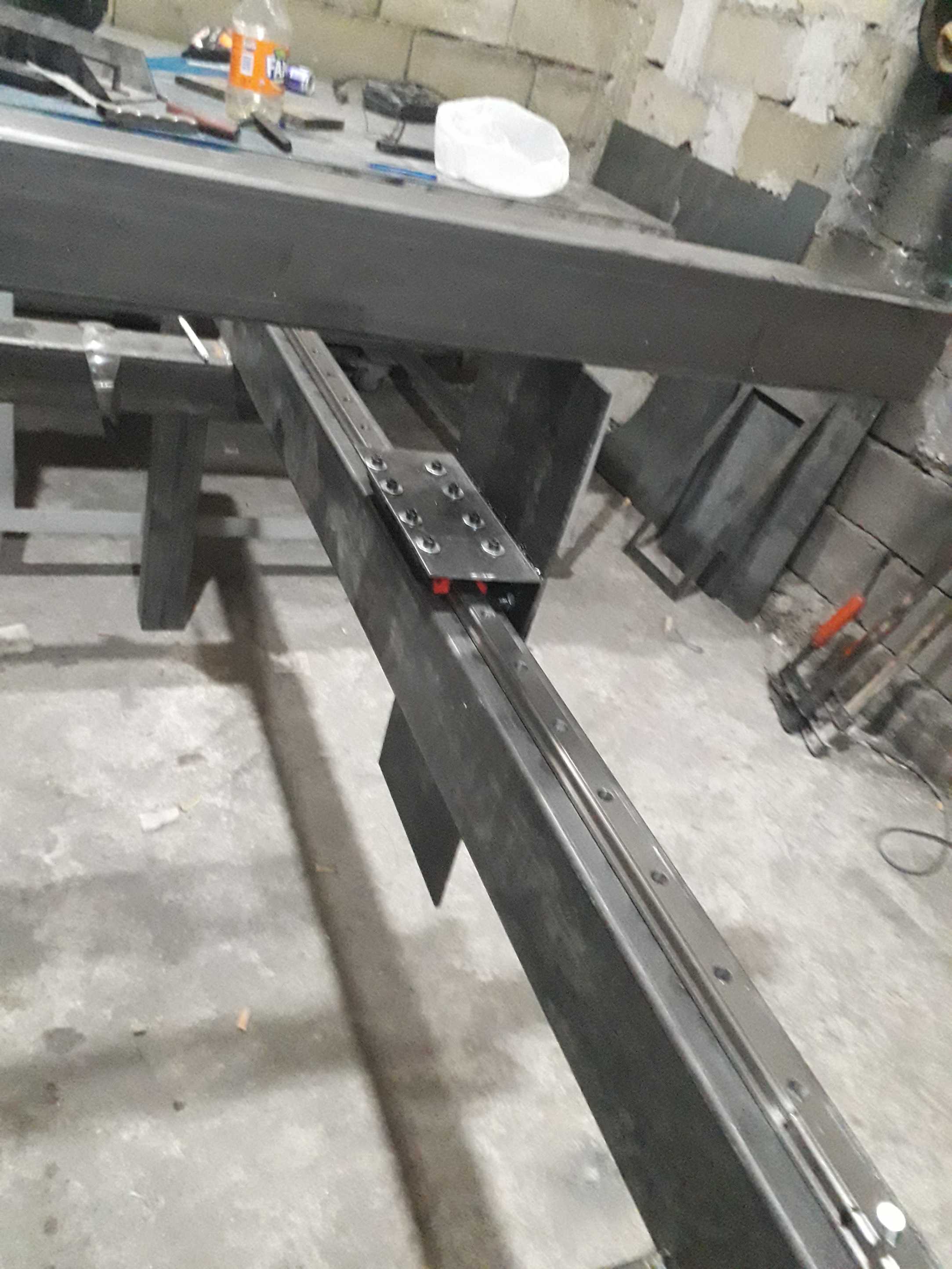

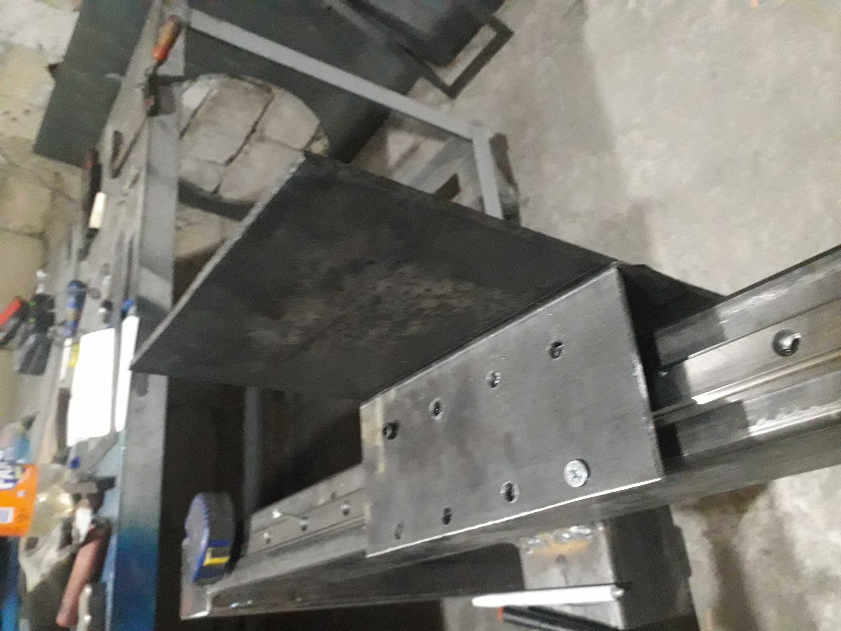

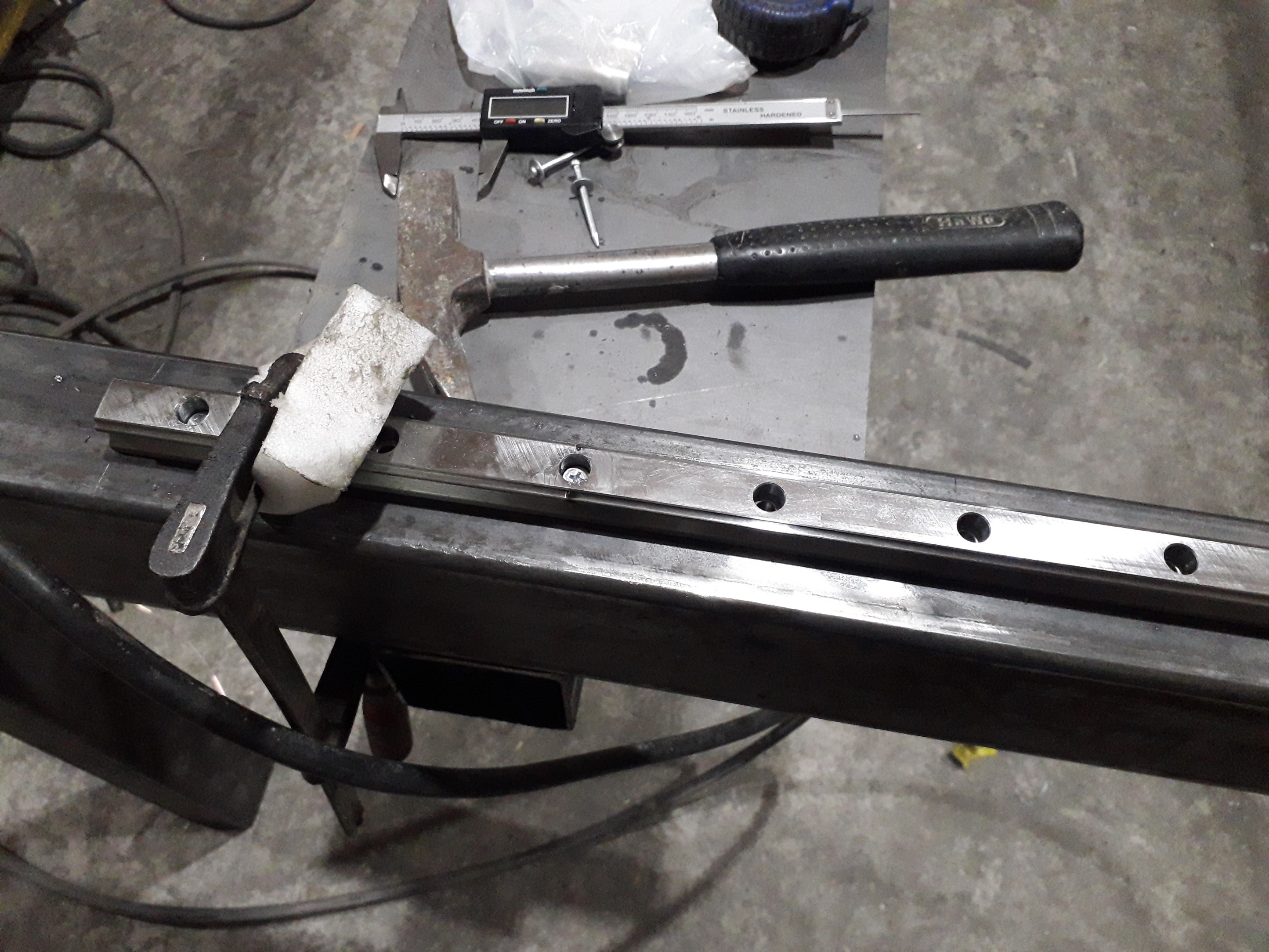

21 Dec 2020 17:08 - 24 Dec 2020 19:24 #192743
by shpatb
Replied by shpatb on topic DIY CNC router build

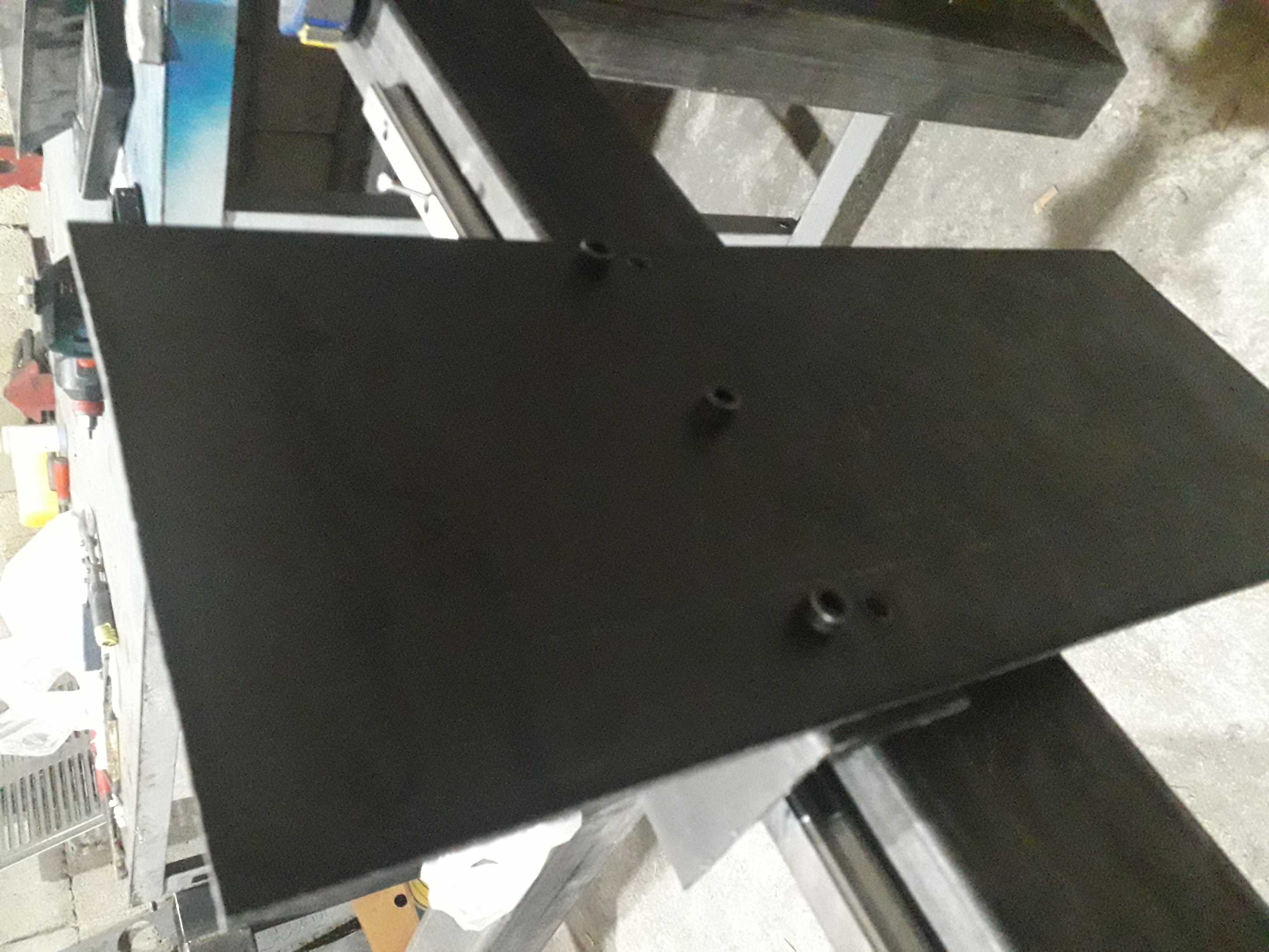

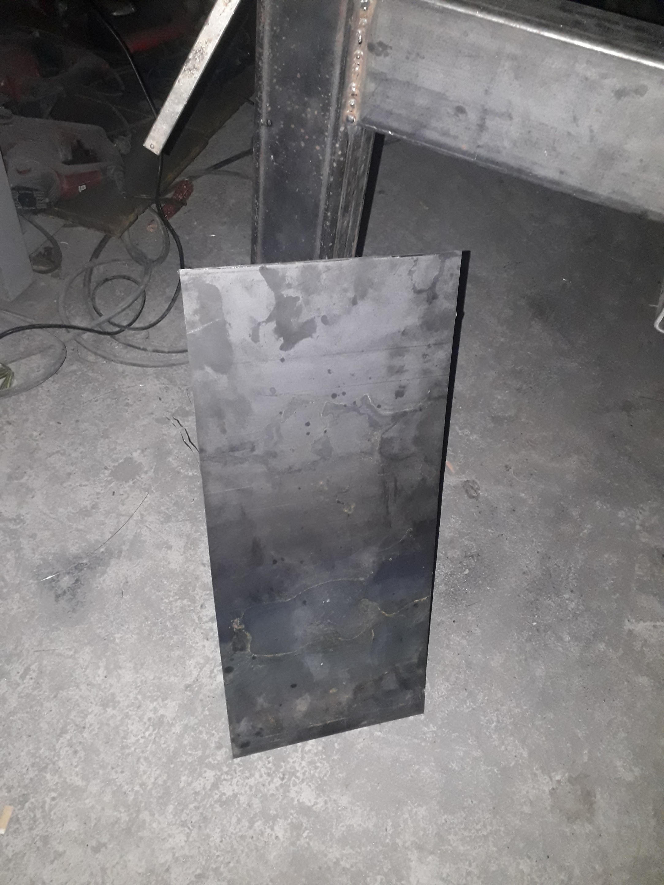

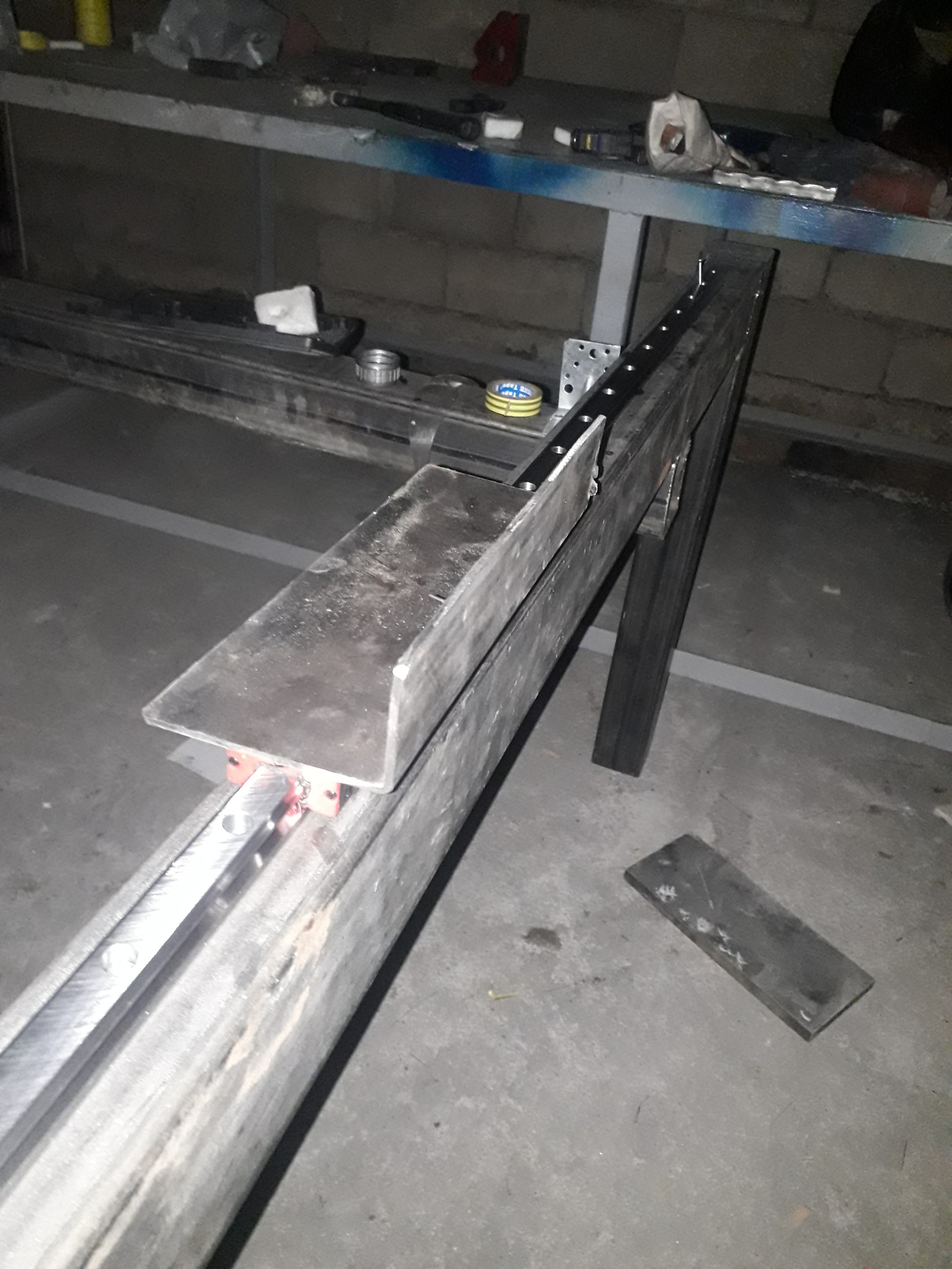

Mounted Y rails today , took a lot of time because i did it all alone, measure , drill , tap , measure ...repeat....
going to mount the gantry of some 3mm thick L i made of some tube , then bolt it with m8 Hex screws, with the 4mm steel sheet.
more to come on future days..busy with education and work..i want it moving as fast as possible ..waited too long for parts
Mounted side panels for X axis mount,
due to a mistake a made on cad i had to re-cut on my plasma table and fix it...
Took like 5-6 hours , broke 2 drill bits and one counter bolt...
I was at one state of leaving it but then a friend showed and offered a cigarette and i kept going...
came out pretty nice
tomorrow i would have completed my X axis mount but my mig welder broke , and there is a mess on that electrician shop i send to fix it...
will try to upload more pics as i complete the build ..
NOTE : I AM GOING TO UPLOAD ALL FUTURE PROGRESS ON THIS MESSAGE BECAUSE THERE IS A WIERD BUG GOING ON THAT WONT ALLOW ME TO ADD OTHER REPLIES ..

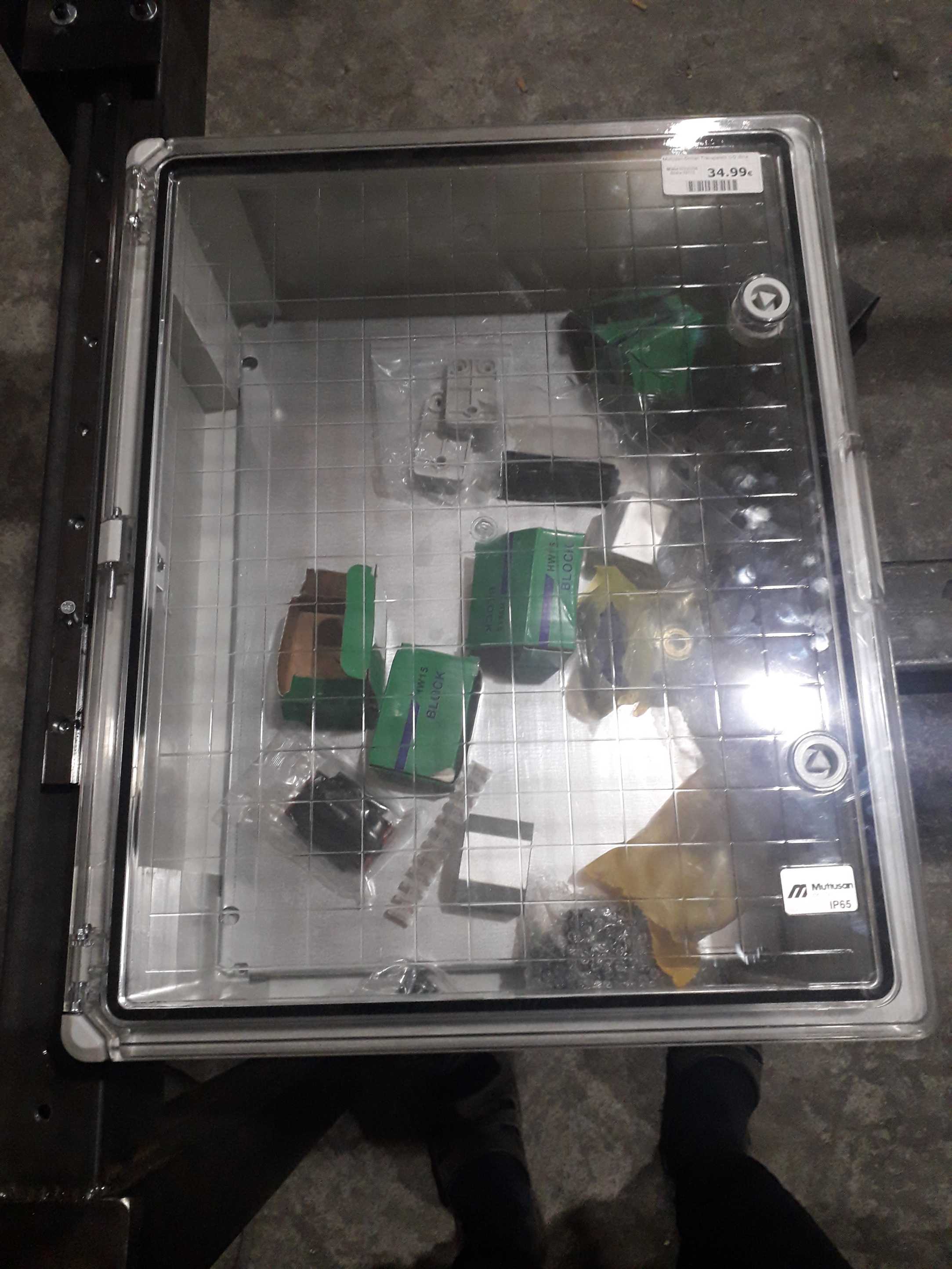

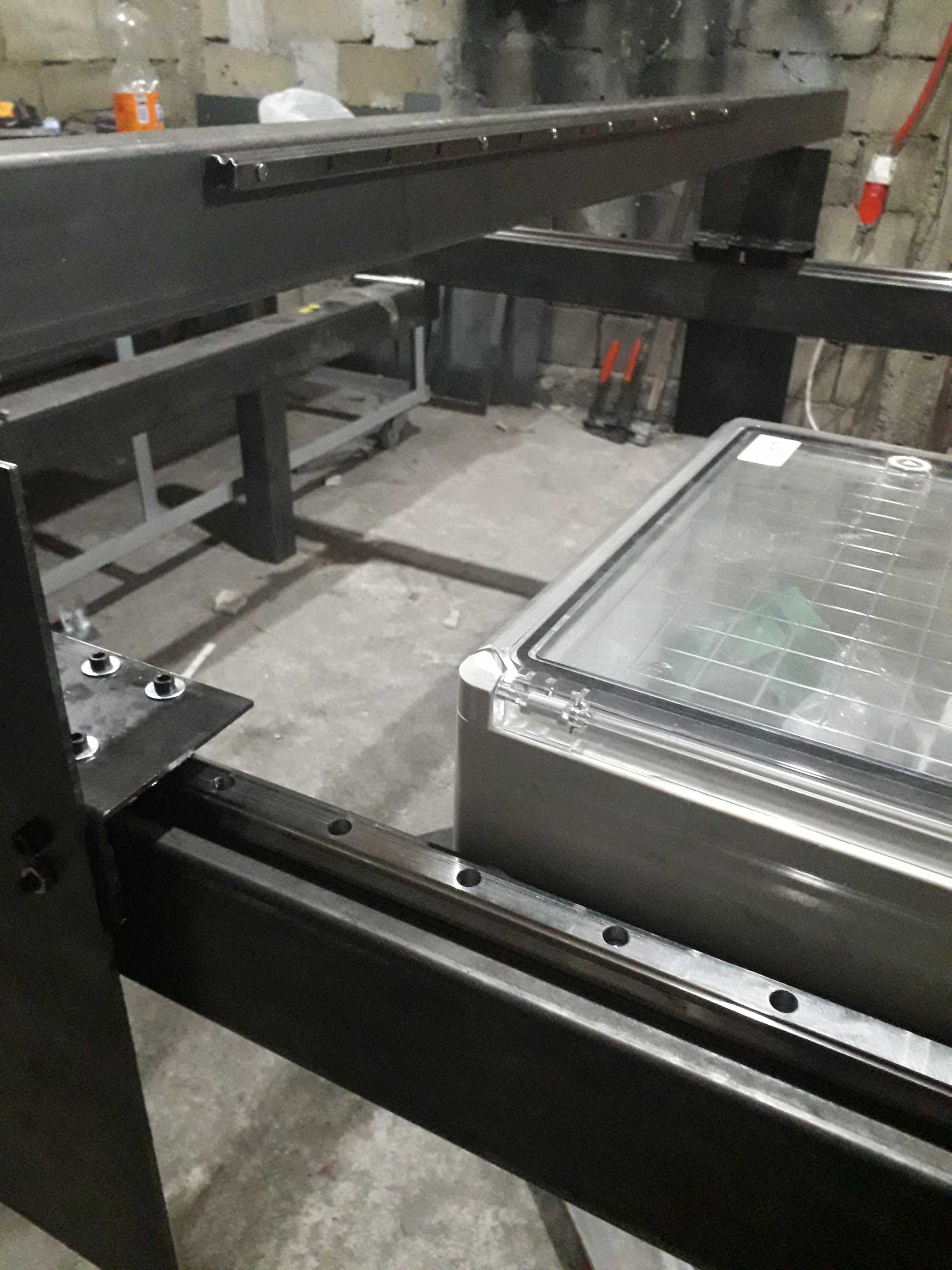

25 Dec 2020 16:46 - 25 Dec 2020 16:53 #193198
by shpatb
puzzle is starting to get shape
got this box from local electronics store its ip 65 rated so its going to be good for dust to be held out of the electronics ...
more to come...
more to come...

25 Dec 2020 17:18 #193200
500x400x190mm ?
I used 400x300x190 on the last builds, it got tight !
Nice
Nice

25 Dec 2020 17:39 #193202
by shpatb
yes , for couple of euros its not worth the pain on ur head it gives to mount the electronics ..
the wider the better they say :DD
