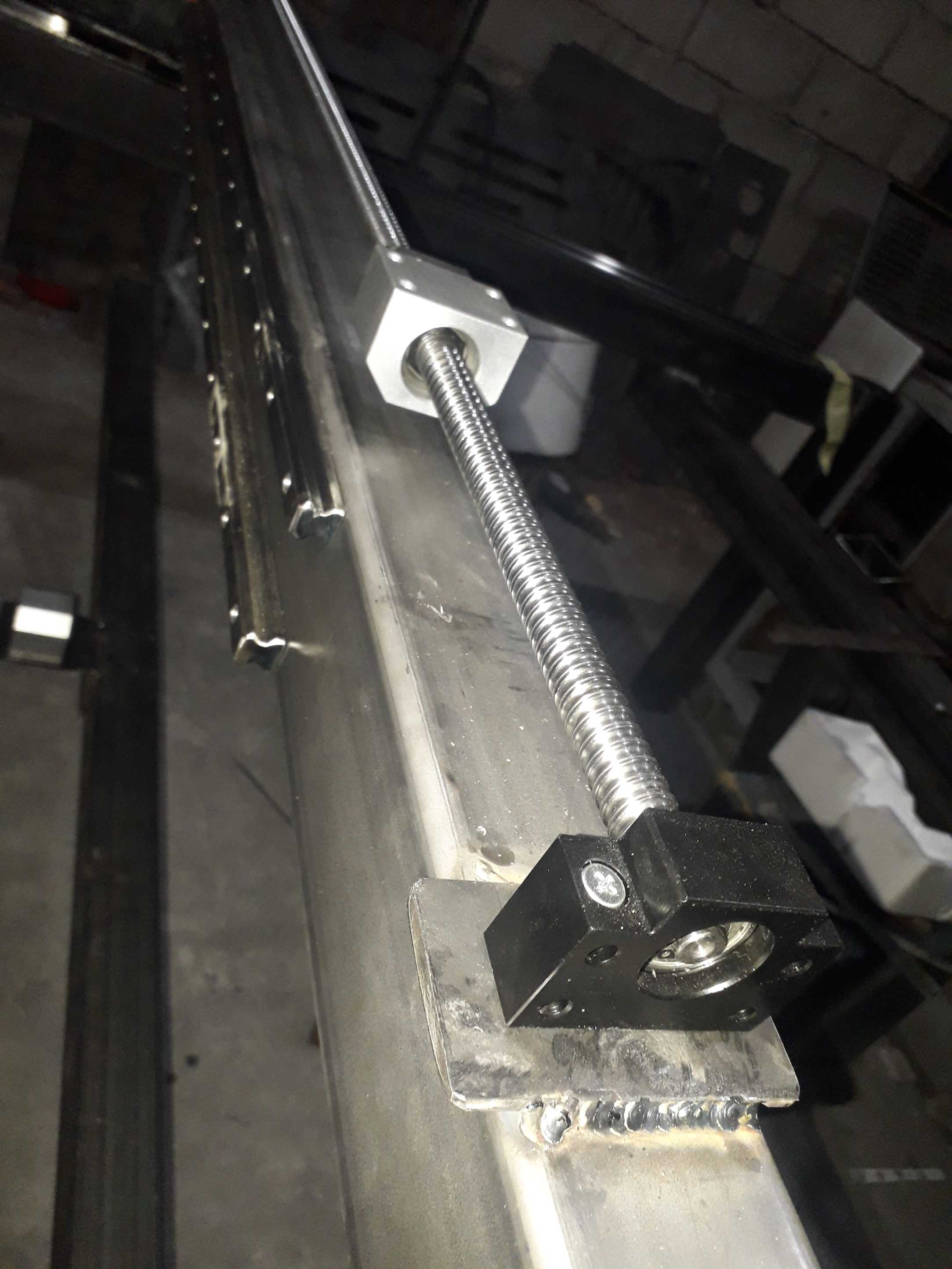

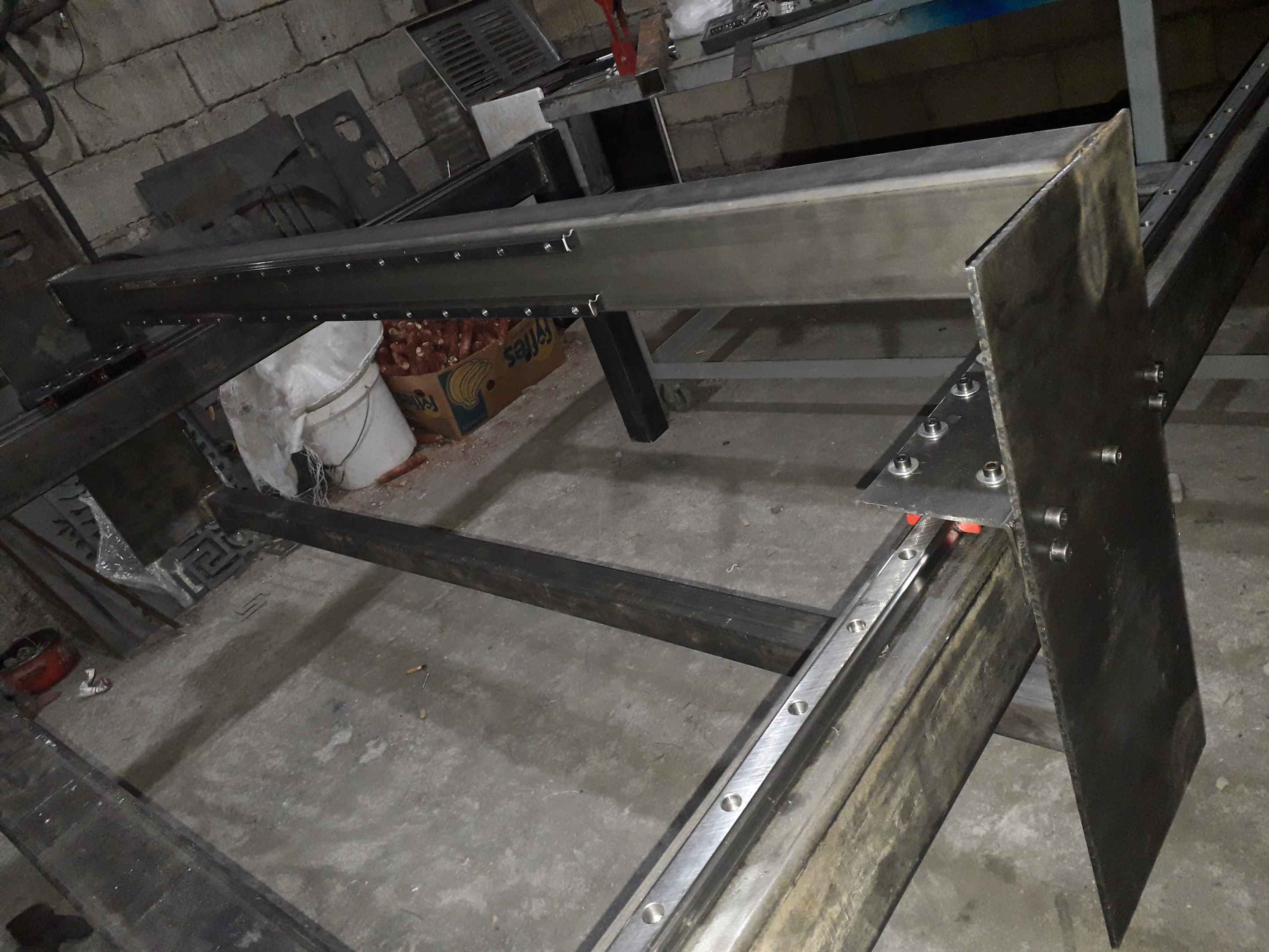

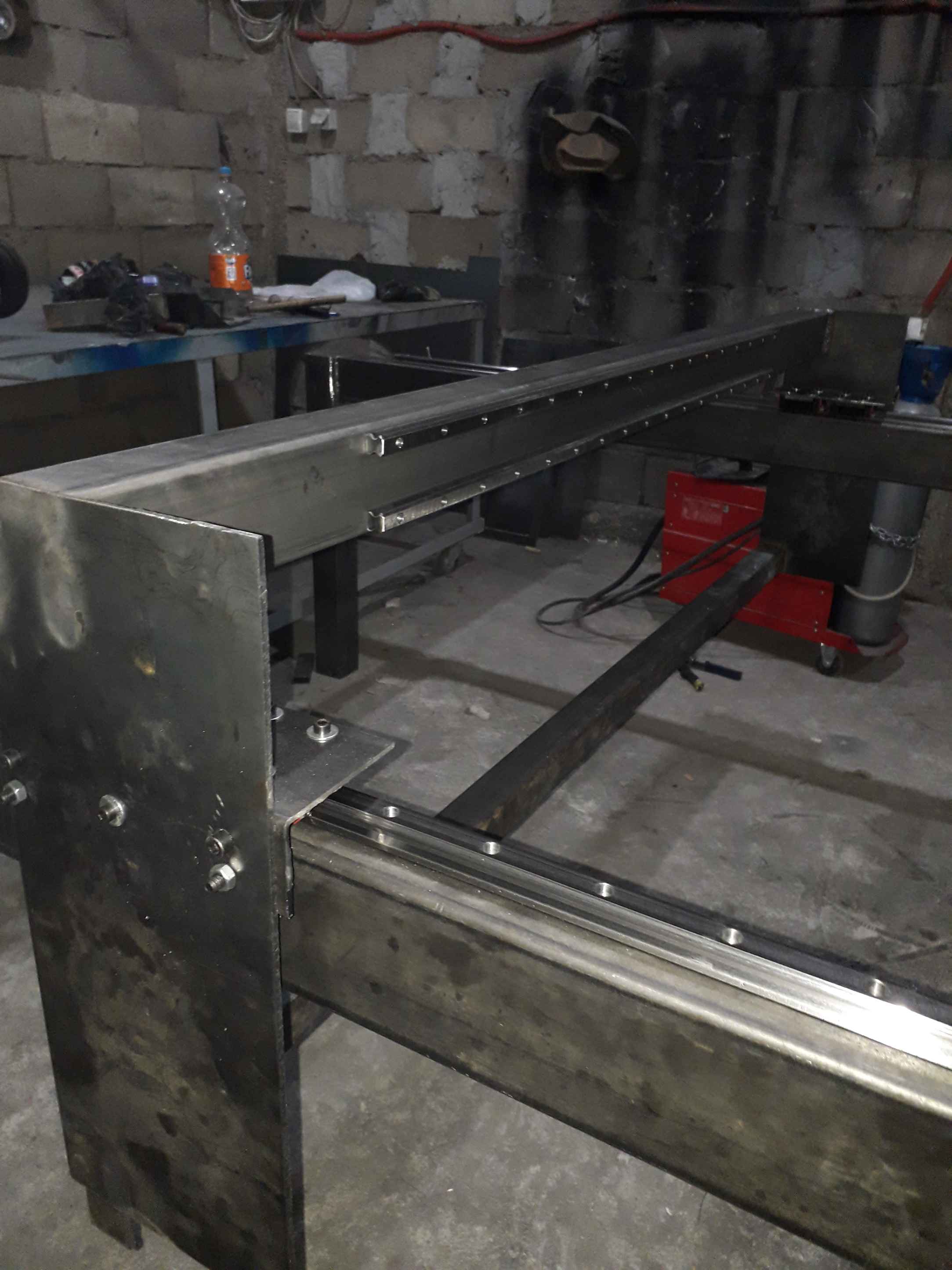

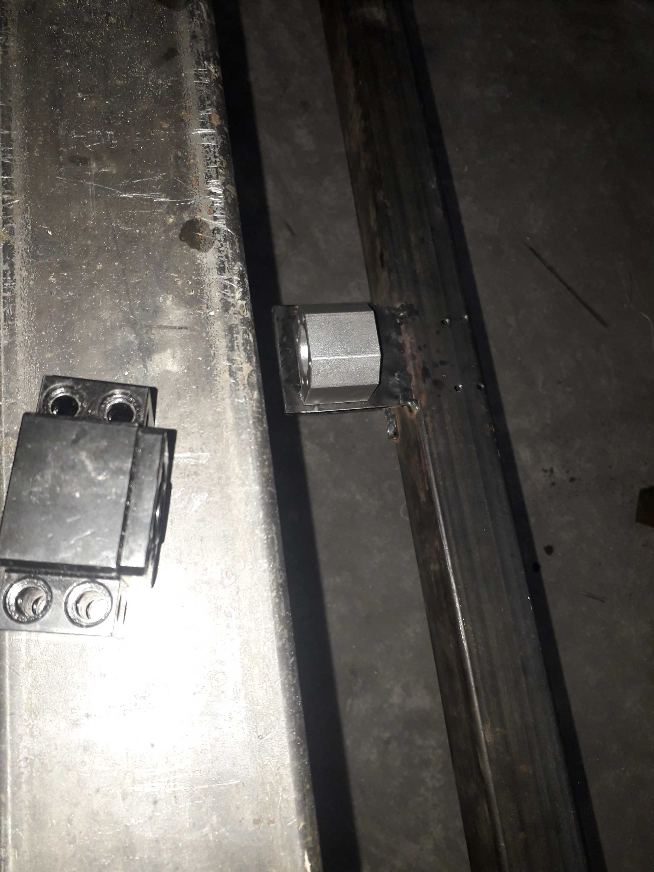

Mounted X rails , welded the tube to 4mm plates for more stiffness..
also welded a 5x5 tube under the table to mount the ballscrew.
would have posted a video of me holding on gantry as it would take me for a ride but that would make tommy envy so leave it for some time..

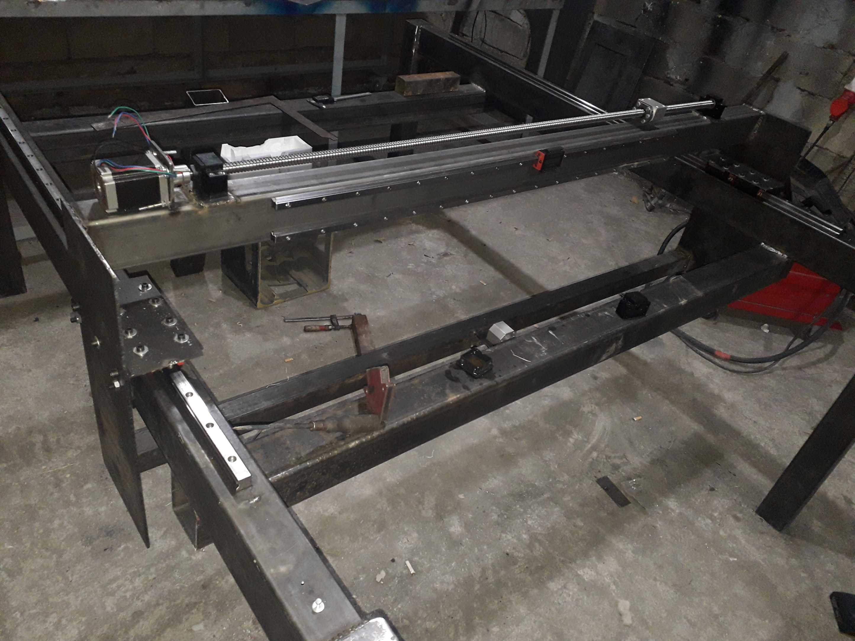

time has passed ,tommy's envy has gone ..
enjoy..
Replied by shpatb on topic DIY CNC router build
enjoy..

Nice ride !

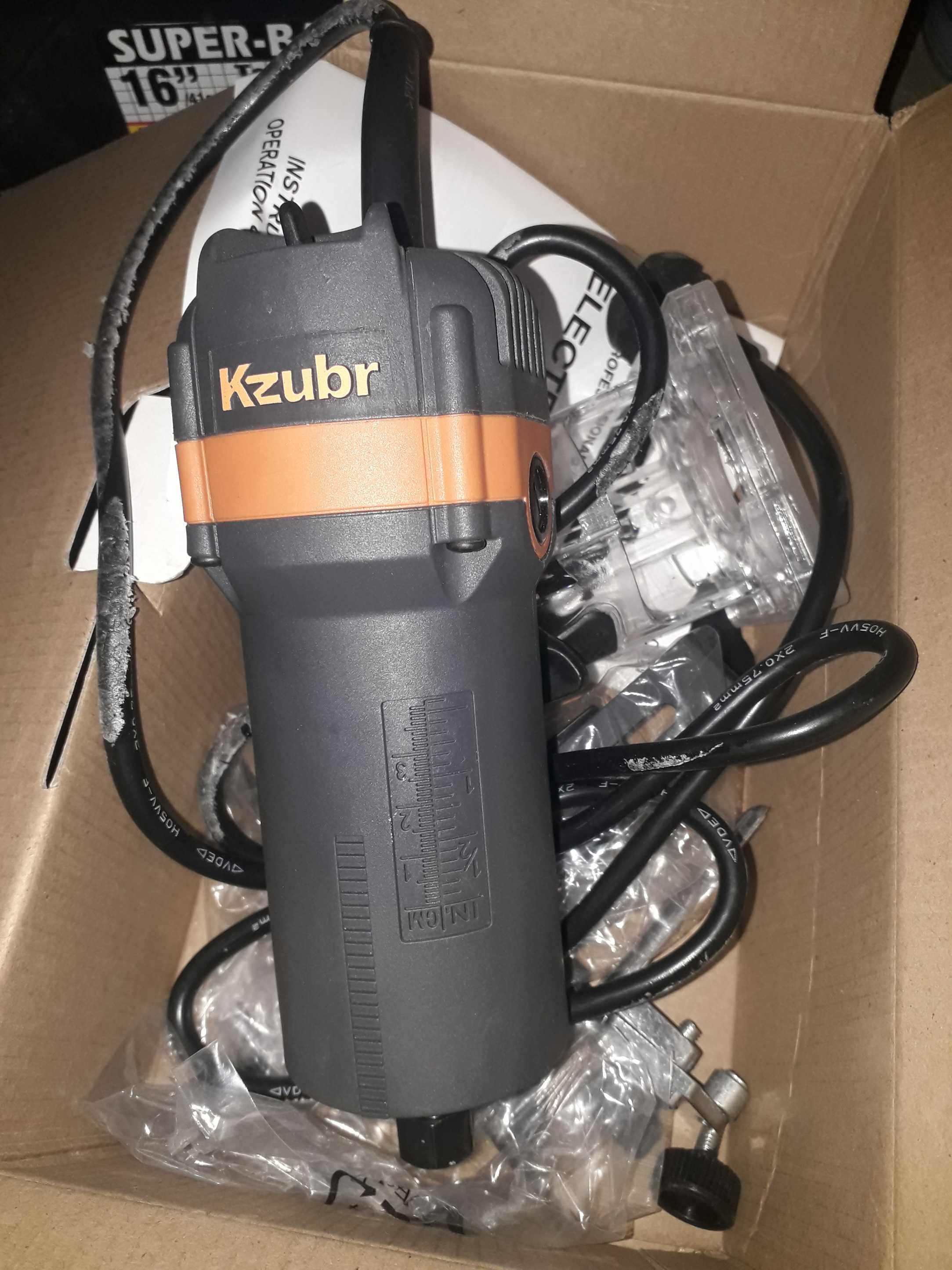

02 Jan 2021 18:39 #193870
by shpatb

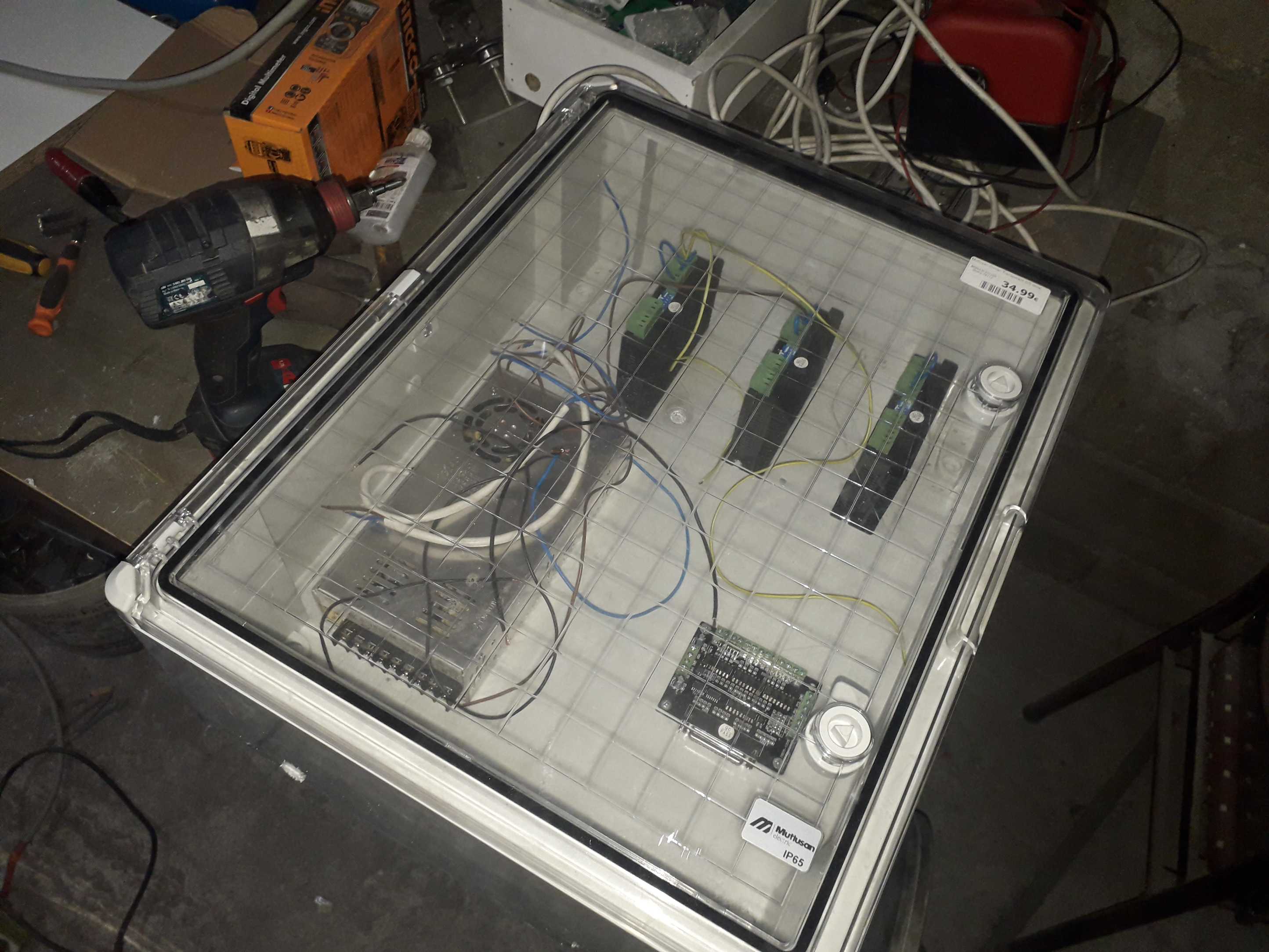

some progress ...

02 Jan 2021 19:14 #193878
Replied by tommylight on topic DIY CNC router build
How much was the Kzubr ? What RPM does it do ? Is it to loud ?
- shpatb
- Posts: 87
- Thank you received: 62
02 Jan 2021 20:04 #193883
by shpatb
25eu to 35 depends how u buy it
runs very quiet , 710watt of power , 35000 r/min , 6mm bore for bits.

02 Jan 2021 20:41 #193887
Expect an order for two of them soon !

very nice
what steppers are u using ?
