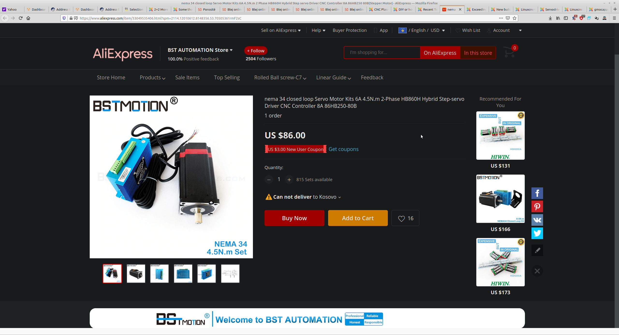

This is the link for the motors closed loop 4.5Nm nema 34 driven at 65V. The feed rate was 10mts/min
www.aliexpress.com/item/33049535406.html...56.53.70505361rmF2sC
The router was designed with a tall gantry and was designed to accept tall parts that had to have the top machined.

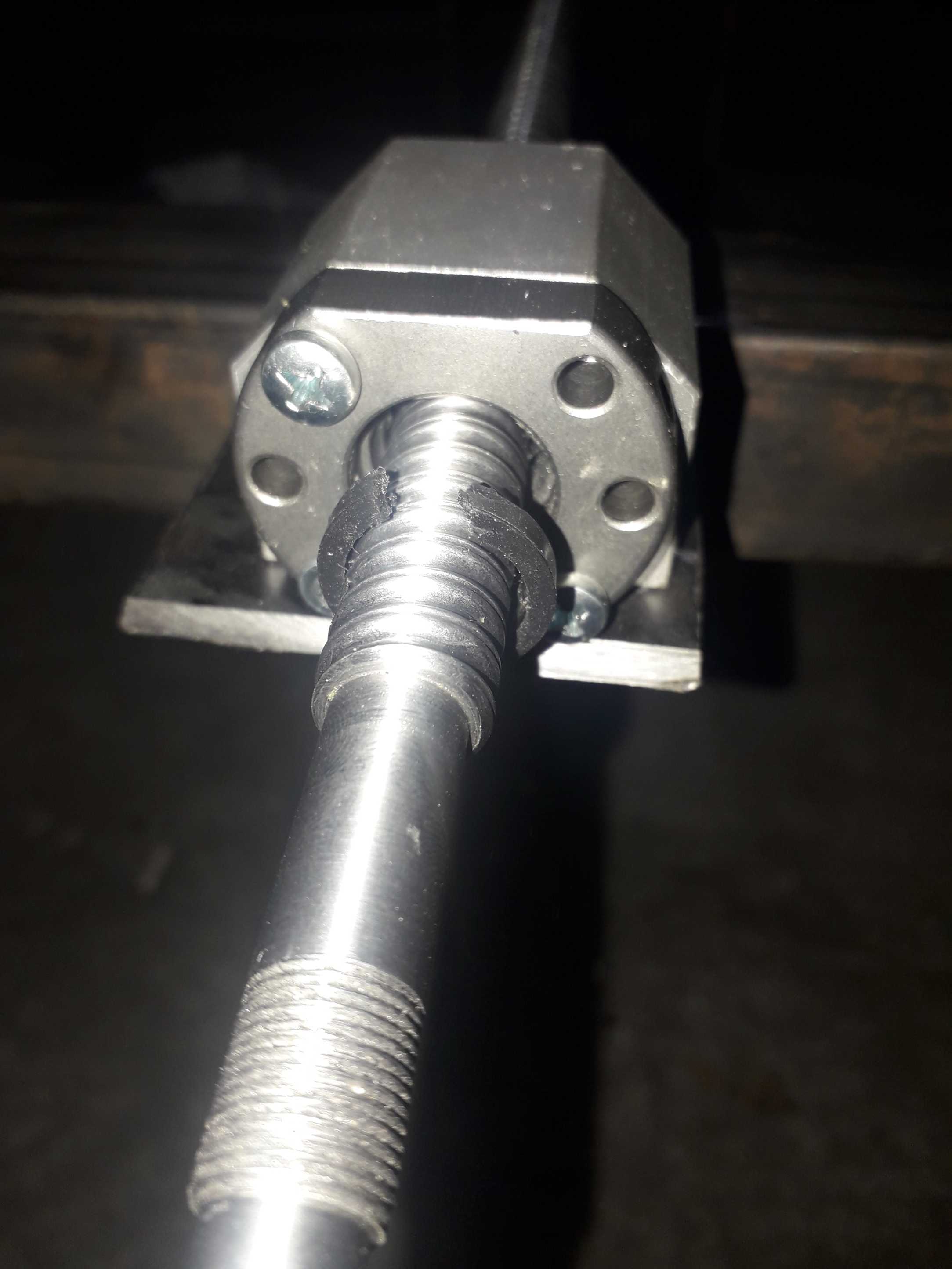

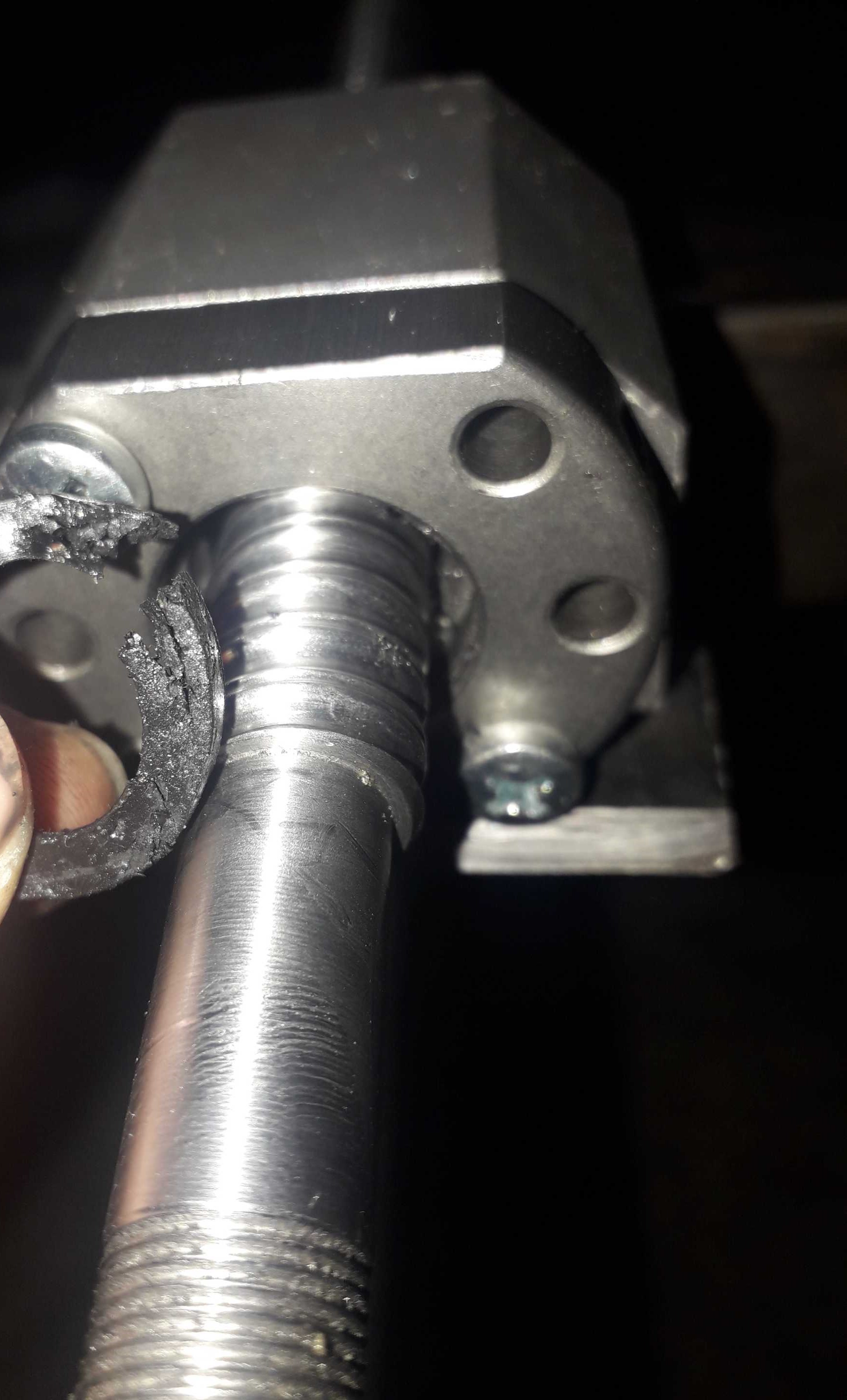

everything was going ok until this happened...
installed the nut and moved the screw accidentally then it got blocked , had to remove the nut and install the balls inside then these plastic protectors ripped and balls dont stay inside anymore...
another 2 months of time wasted

07 Jan 2021 23:18 #194429
Those plastic broke because the balls were not in their place, they have a very strict position where they should be located inside the nut.
You are lucky they did not bind, only an angle grinder would have set them free!
They can still be used without plastic rings but the dust will get in there and soon enough mess them up, in a year or 5 depending on use and dust.
If they are open type with a small black tube held by a screw:
-remove the screw and tube,
-insert the big screw and position the nut and the screw so the screw sits in the middle of the nut
-turn the nut so the holes are up
-turn the screw and peek through the holes till the grooves are aligned with both holes
-insert balls through one hole only till they start exiting at the other side
-put the metal lid on and insert any remaining balls under the lid
-tighten the lid
-enjoy.
If they are of the closed type, to fix them:
-find some engine grease, a flat head screwdriver, and a big clean cloth or table cover
-get the balls out and clean them properly one by one
-clean the nut inside and clean the grooves properly
-wash hands and clean screwdriver
-look inside the nut, there are deep grooves inside, only 3 of those groves are full rounds and they end on both sides where the "outside ball carrier"
-on both sides there is also another short grooved part, NO BALLS SHOULD GO THERE under any circumstances, it will lock the nut to the point that only angle grinder will work, or not because the nut will have to be cut open!!!
-make sure you got enough light to see inside the nut
-take the screwdriver and fill the grooves with grease, not the whole nut, just the gooves
-dip the tip of screwdriver in grease then grab only one ball with the greased tip and place it carefully in the groove
-repeat
-when done, DO NOT try to insert it in the srew
-find something round that can easily fit inside the nut, or make a tube out of thin cardboard or several sheets of paper
-slowly insert the tube inside the nut making sure the balls stay in place
-now slowly insert the screw, let the screw push the tube as it goes in
-enjoy.

The wipers are not a particularly good solution anyway.
If you can fit spiral spring covers, that should work better and longer.
They are not cheap, but they are not horribly expensive either.

Tommy thank you, I have tried all of these you mentioned ,but none of them seem to work, took me like 3 hours to mount it , it moved smoothly as it came new, but this type of nut has that rubber thing like a spiral inside and its hold in place with some steel 1mm think wire and that is damaged , the nut moved smoothly but the vibration moving back and forward caused the balls to drop out, so the only solution is to get it brand new.
