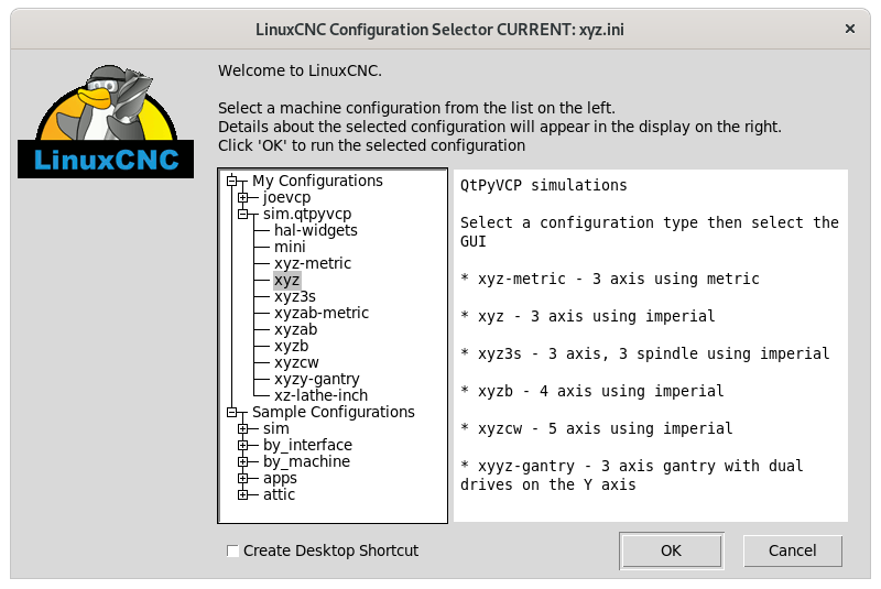

I've been dabbling (again) with Debian Bullseye, as I thought I'd give QtPyVCP a go both from the perspective of using Probe Basic for Mill and Lathe and getting stop using Gmoccopy. I though I'd also give creating simple screensets a go for my 3/4 axis mill + router + lathe as I don't have an ATC but I do have a 40 position multifix tool post for the lathe with a lot of tool holders all on a rack with numbers.
Enough waffle:
Download Debian Bullseye from the Debian repository via ISO
www.debian.org/download
I tend to use the non-free version amd64 as I have intel network cards and the non-free version will provide the firmware "out of the box" at install time, so I download from here:
cdimage.debian.org/cdimage/unofficial/no...urrent/amd64/iso-cd/
I use etcher (or if on linux dd) the iso onto usb stick and then install accordingly.
once the install is complete,
I will add my user account to the sudo (super user) group by logging on to the root account and adding myself to the sudo users group (it makes life easier to install stuff + its just a cnc machine and I'm not fussed if it was ever hacked... it does not run unless I'm present or nearby).
type the following into the terminal:
su
enter the root / su / super user password
type:
sudo usermod -a -G sudo username
.... change "username" to YOUR login name obviously!

18 Feb 2022 23:58 #235296 by jkkicks
Replied by jkkicks on topic Robertspark's CNC Setup
This is awesome, almost got it working first try!
Probe basic lathe works right out of the box, editvcp and qtpyvcp are all installed and working properly with no error codes. One thing I did notice though is that in the linuxcnc configuration selector there is no folder for probe basic, but if i choose sim.qtpyvcp, XYZ i can launch right into the probe basic lathe program.
thats where the good news ends though. When launching the xyz config and selecting probe_basic i still get an error code and a crash... Heres the error message:

ModuleNotFoundError: No module named 'qtpyvcp_conversational_gcode'
what do i do... im laughing and crying all at once
