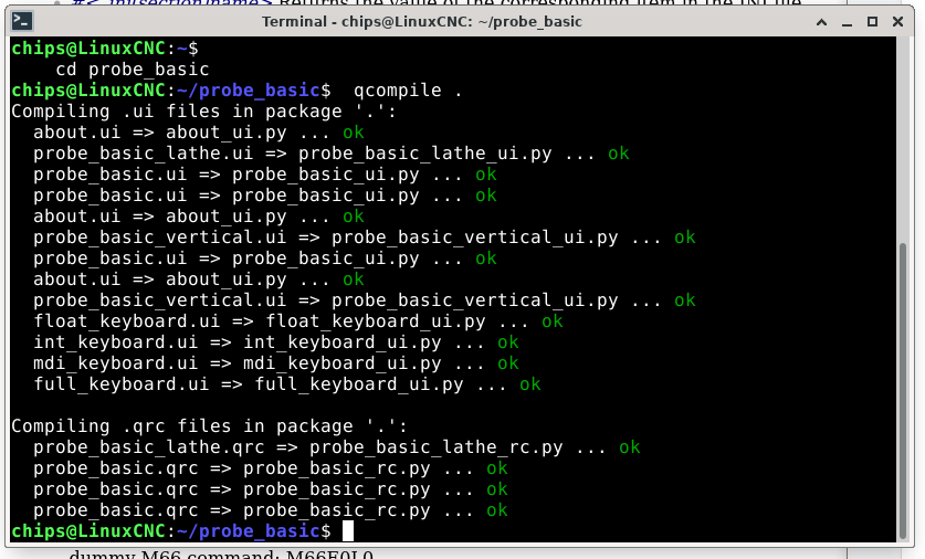

PROBE_BASIC
git clone https://github.com/kcjengr/probe_basic -b python3 probe_basic
cd probe_basic
qcompile .
python3 -m pip install --editable .
cd
cp -r ~/probe_basic/probe_basic/fonts/ ~/.local/share/
cp -r ~/probe_basic/config/probe_basic/ ~/linuxcnc/configs/
python3 -m pip install git+https://github.com/kcjengr/qtpyvcp.conversational-gcode.git

hi, i tried to install the image but i got some errors. sudo geany /etc/lightdm/lightdm.conf creates a new file for me because it doesn't exist ... qtpyvcp -h qtpyvcp -i these two commands also return an error and the last pip install git + https: //github.com/kcjengr/qtpyvcp.conversational-gcode.git now i had to stop next time i will try to be more precise however kernel preempt-rt is installed and qt too.
