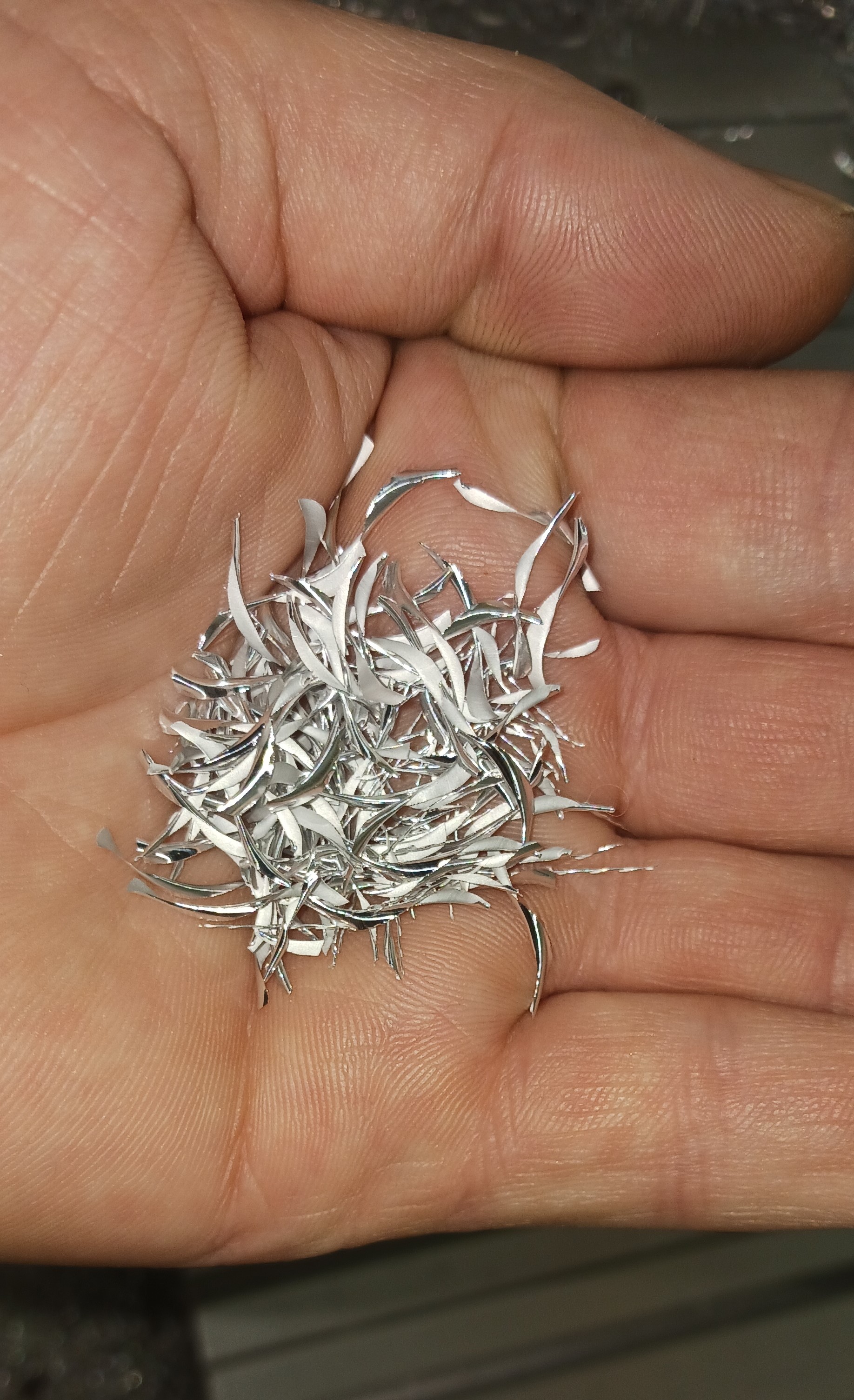

i was not expecting this good of a cut step over or depth of cut for that matter but i probably tripled my step over on my X axis. .600 depth of cut with a .130 step over at @ 75 IMP with a 1/4 diameter 3 flute. the drive did perfect the spindle was starting to drop in rpm slightly. now i'm making some chips

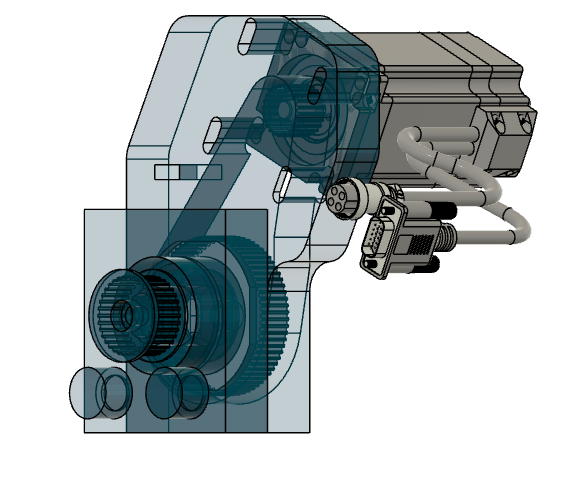

i think i have a good design starting point for this reduction set up for my Y axis. the X will be easy comparted to the Y axis i think. i think i even avoided losing axis travel and should work well if i can make in come to life
i think i will add a cover and rework my belt tension for the X axis into it but i think i have it compressed as much as i can work into this design,

Suggest making the cover a structural support that has outboard bearings for the pinion and belt idlers.
It need not be complicated - just a flat plate separated from the motor mount with standoffs and long bolts or threaded rods. Some flanged bearings pressed in and longer pinion & idler shafts will keep belt tension from flexing the shafts.
Tension the main drive belt at the fixed ends so the pinion can remain fixed in relation to the idlers.

I'm using two tapered roller bearings in opposing directions to anchor the pinion and take out any lateral movement. i don't think that part is going anywhere. I'm using pretty large bearings in that part everything is on a 1" shaft with Anti-rotation ends locked on with M8 screws that will also preload the bearings. it's hard to show everything with a screen grab
- spumco
- Posts: 2180
- Thank you received: 905
01 Oct 2024 20:05 #311130
by spumco
Replied by spumco on topic What do you really get for a $350 desk top engraver ?
1" shaft with tapered rollers? Nice; disregard my last in that case.

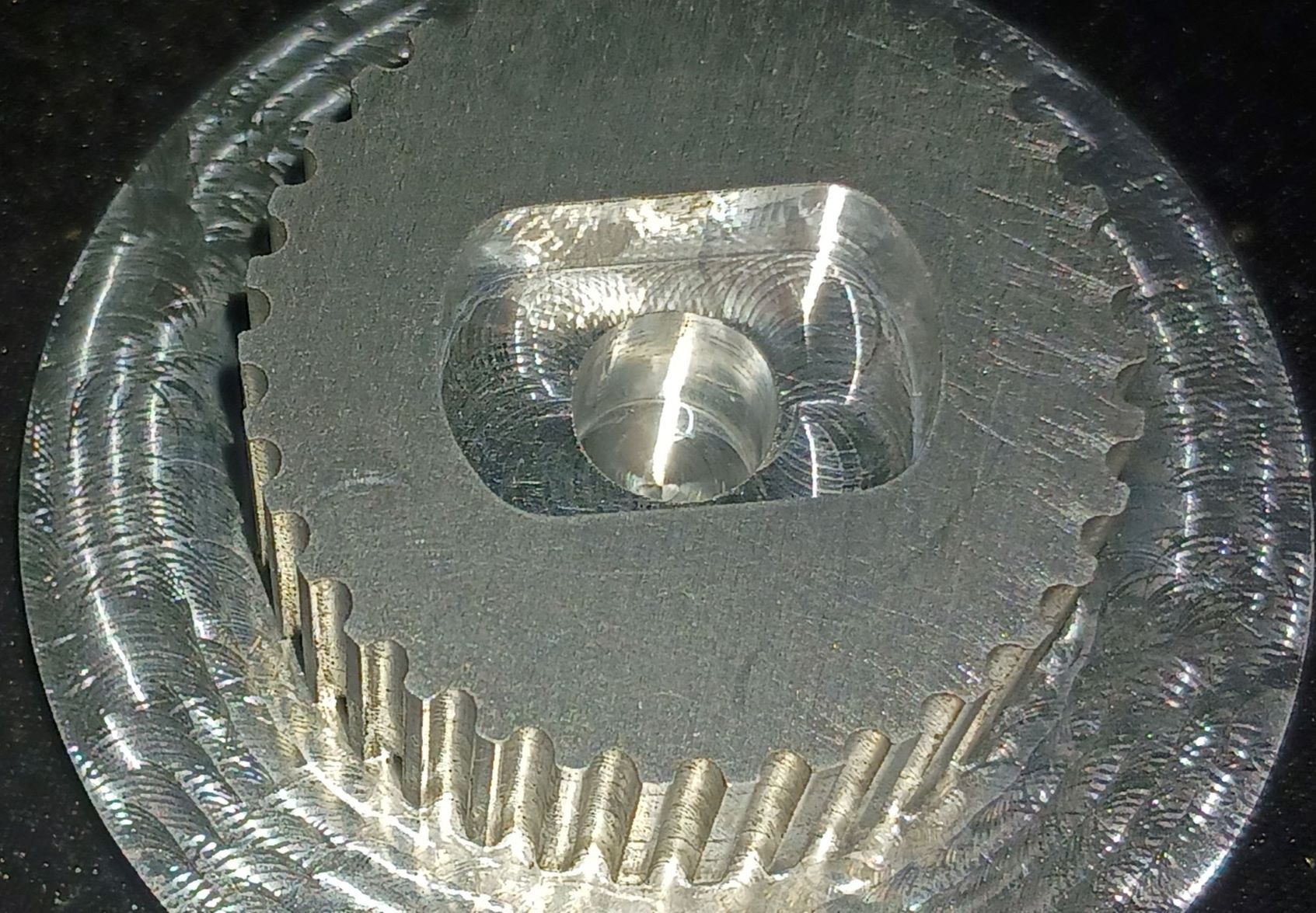

Well i had some time to test cutting an arc toothed pully. I was not even sure if i could or not with a 5/8 depth on this profile. i ended up buying a special extended reach 1/16 diameter end mill to try. it does work but it is not the fastest process for sure
i was not pushing anything very hard at all with the cost of this endmill being around $55 with tax and delivery. the bad news is i messed up with my model and offset my geometry in the wrong direction so this piece i made is no good, but the process works for sure.

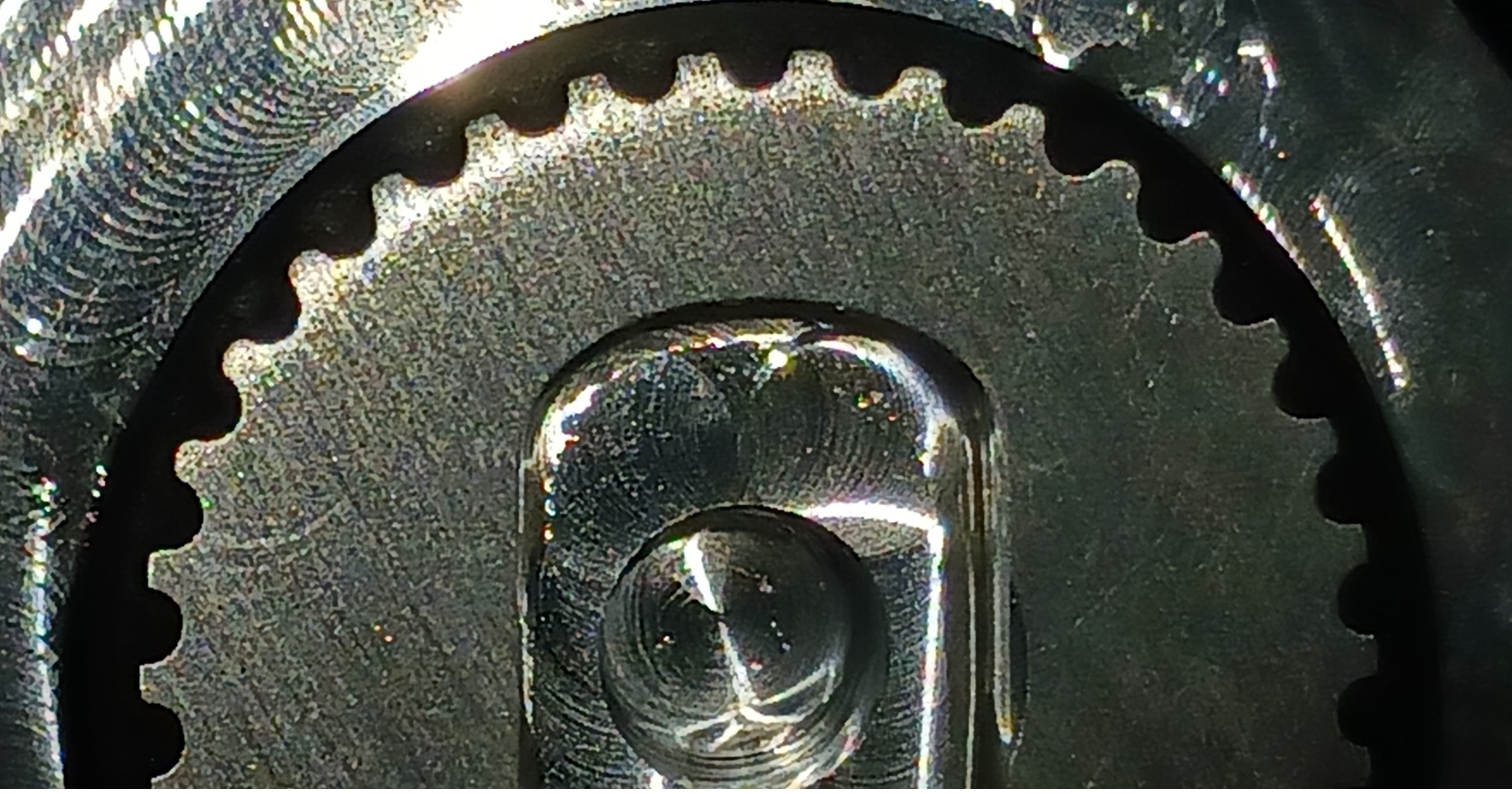

It took me 3 attempts, but the 3rd time was a charm
It would appear to me there is a fine line between getting just enough clearance and matching the belt profile exactly. too much clearance and you end up with backlash i would guess. but i think i have a close fit or at least as close as i can get and still have things work as they should.
