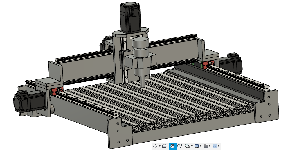

The stock machine came with a Grbl controller and Candle software which is beyond basic. the stock table top was MDF and that was the first thing to get replaced. i had some 25mm x 75mm t slot extrusion on the shelf so it found a new home. i thought the 25mm x 75mm extrusion was light at the time and never used it. what is really light is the 3D printer extrusion on this machine and that is getting replaced soon.
Over the last week or so i have been gathering bits and pieces and for the last few days i have been working on the design for a better foundation to build from. here is what i have so far just for visual reference. if i get smart about limit switches and belt tension i actually will pick up over 4" of travel on the Y axis so that is a plus at least
should be around 16" x 20 " packed in a 600mm x 600mm foot print.

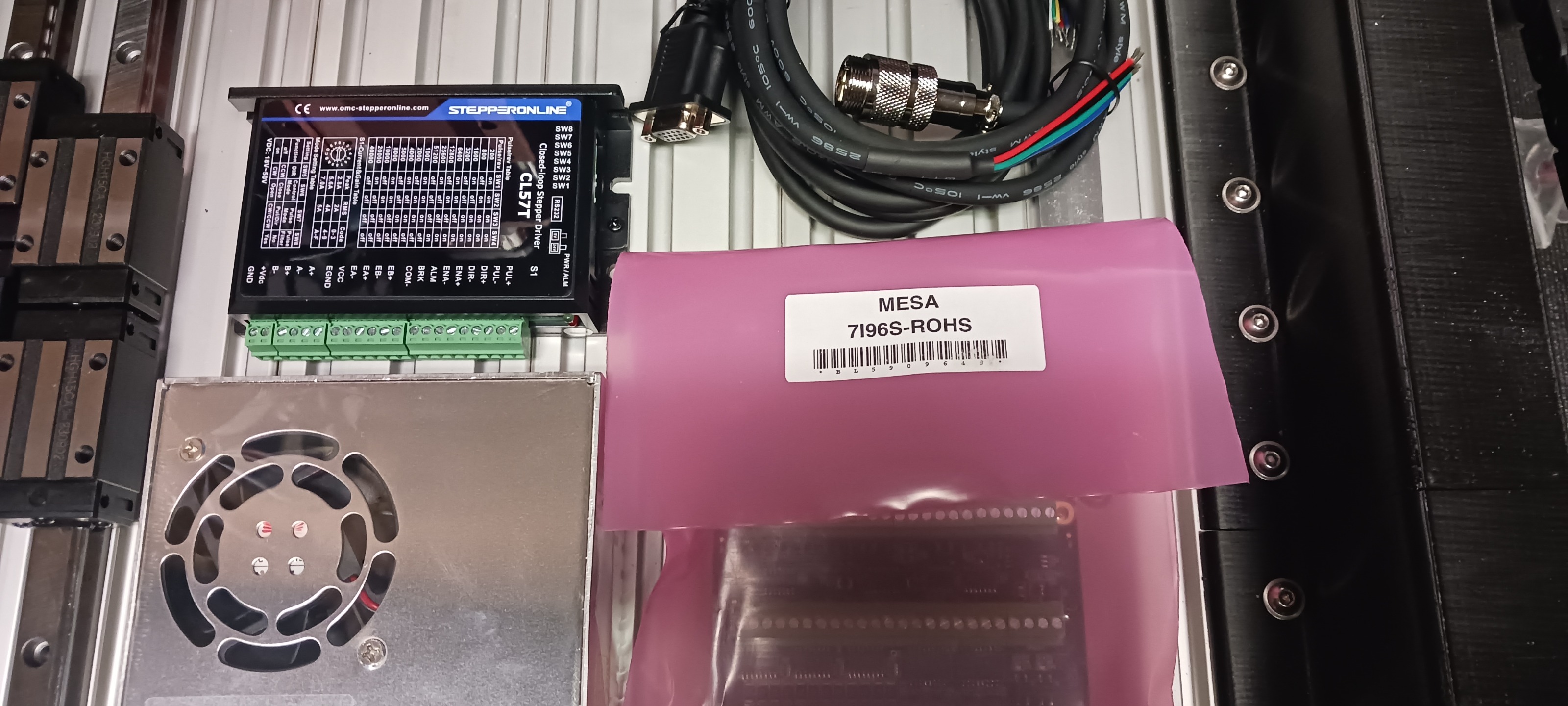

Santa came early this year
4 motors and drives with 2 power supplies plus a 7I96S that came yesterday
on a side note the original machine has the option for a laser so once i get the new frame done for the spindle that's most likely the direction the things will end up going when I'm done with this.

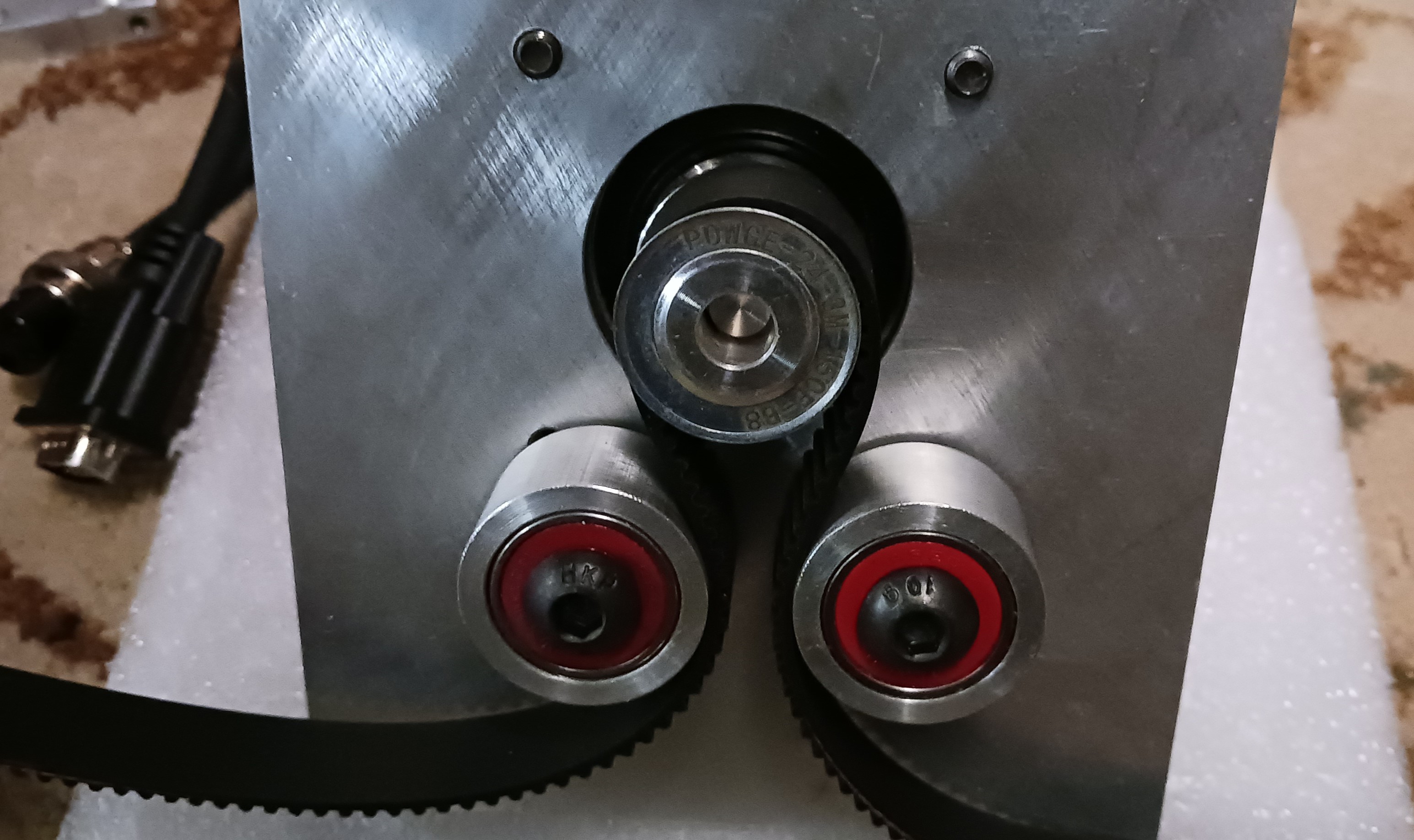

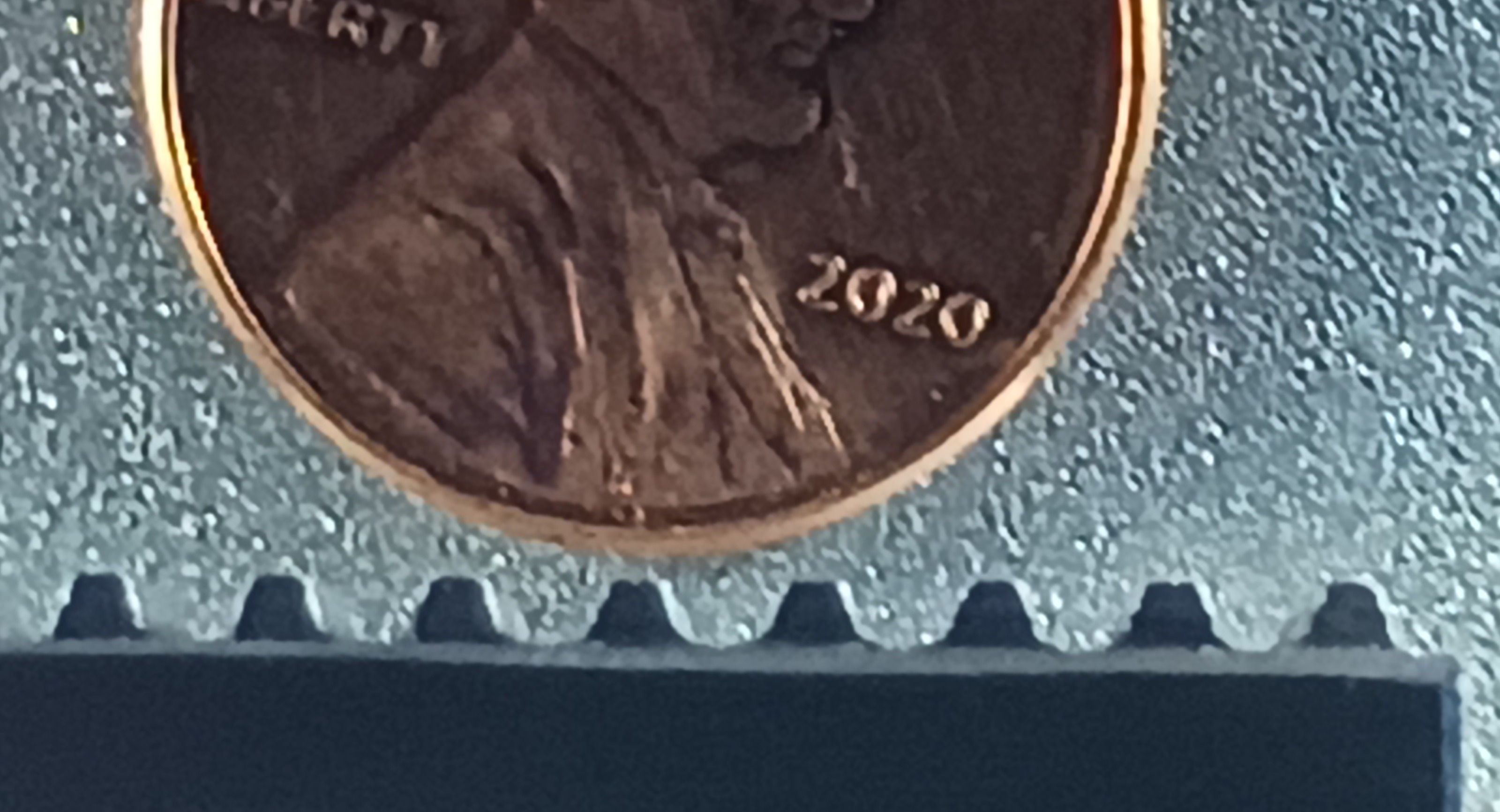

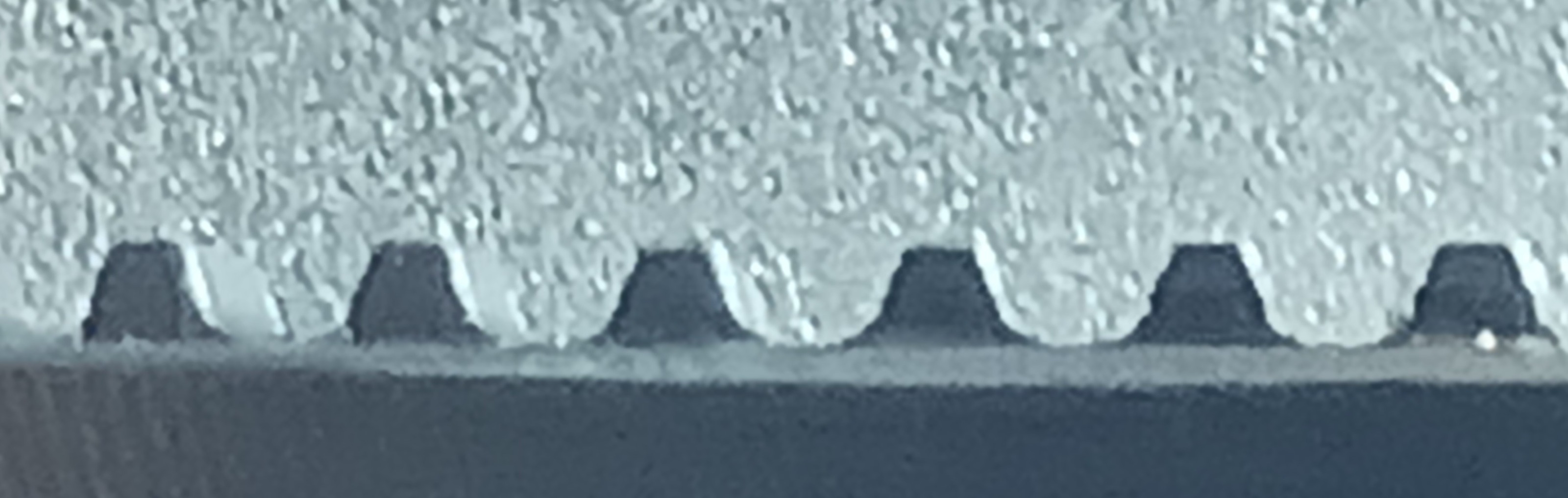

well no belts before Christmas but they did come on the 26th which is way ahead of the Jan 4th date. However they are not steel corded like i thought? i guess i will have to use them and see how well they do? they look like they are well made so time will tell i guess.

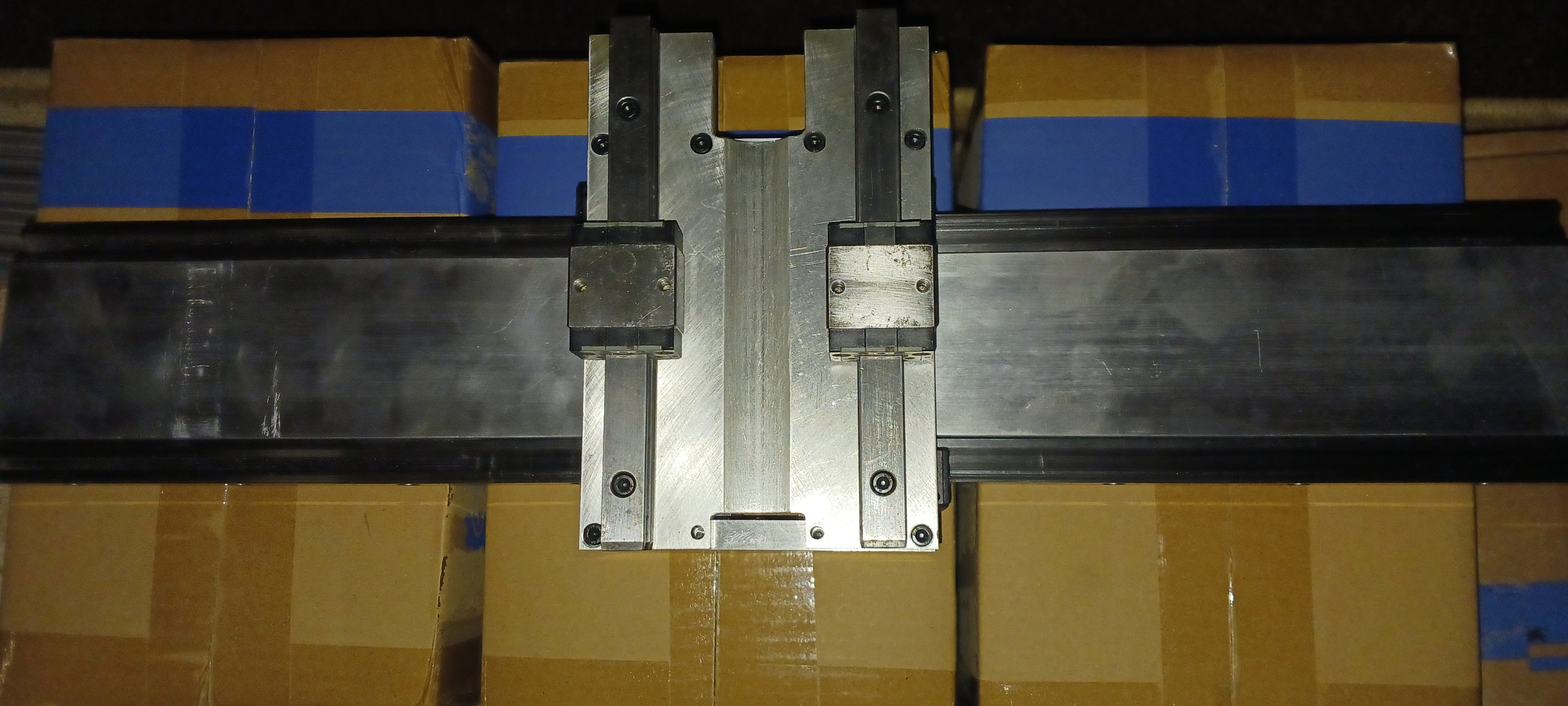

bits and pieces of odds and ends mostly from past projects but the start of something here
making parts on this thing as it is now is like trying to dig a ditch with a spoon
at least i will have a base line to gauge from to see how much better it gets
the old linear rails i had laying around were actually lower profile so fitting a screw under took some sorting out.

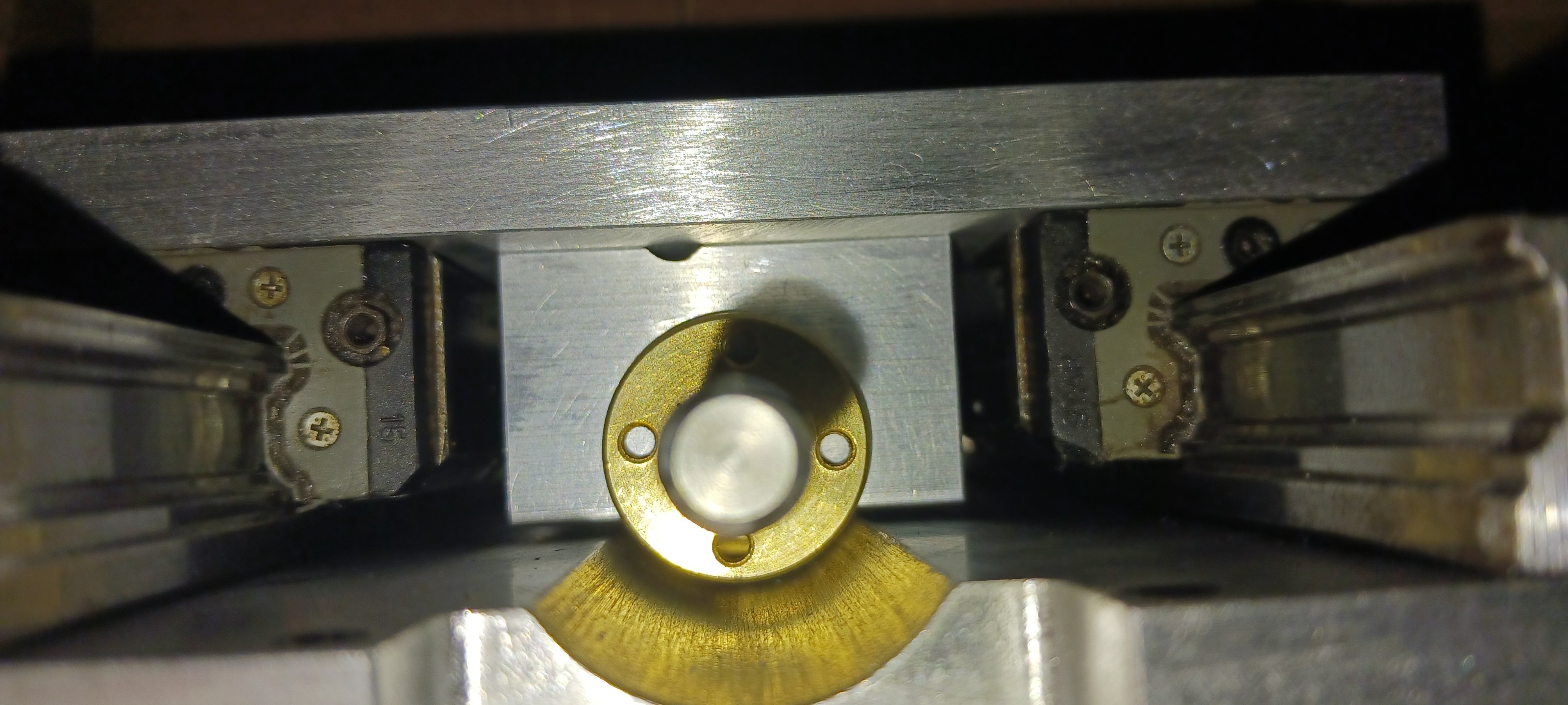

I still have a few small things to finish on my Z axis but i made some progress on it and you can start to see how it all comes together now. Where i had to set the motor so the spindle clears on retraction created some fit issues on the screw section. I have to modify the brass nut flanges but am running double nuts to deal with backlash. 8mm screw with 8mm lead but they are under 6 inches in total length so it should work fine here. I also had to cut out around the coupler to make room as well and had to do a recessed bearing block just to get a bearing on the right center line for the whole assembly. Needless to so things are pretty tight around the screw assembly I think the one picture shows it well. from the top of the bearing blocks to the base plate is only 24mm and the flange on the brass nuts are 22mm in diameter so a tight fit to say the least
