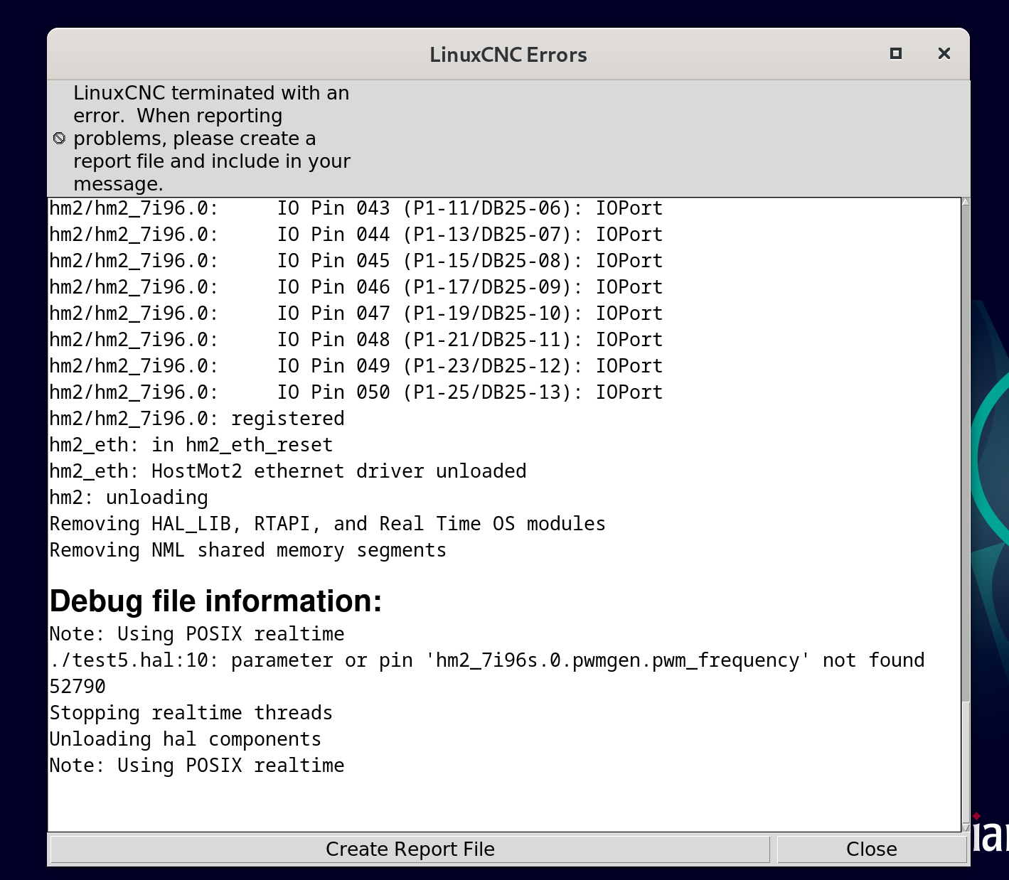

1 year 10 months ago - 1 year 10 months ago #317803
by RNJFAB
Replied by RNJFAB on topic Homemade CNC Plasma - hypertherm, Mesa, gear drives, nema 34.
Last edit: 1 year 10 months ago by RNJFAB.
1 year 10 months ago #317808
Replied by tommylight on topic Homemade CNC Plasma - hypertherm, Mesa, gear drives, nema 34.
In PncConf set the number of PWM to 0
- Posts: 17536
- Thank you received: 3485
1 year 10 months ago #317832
Replied by PCW on topic Homemade CNC Plasma - hypertherm, Mesa, gear drives, nema 34.
Looks like you used a 7I96S configuration file for a 7I96

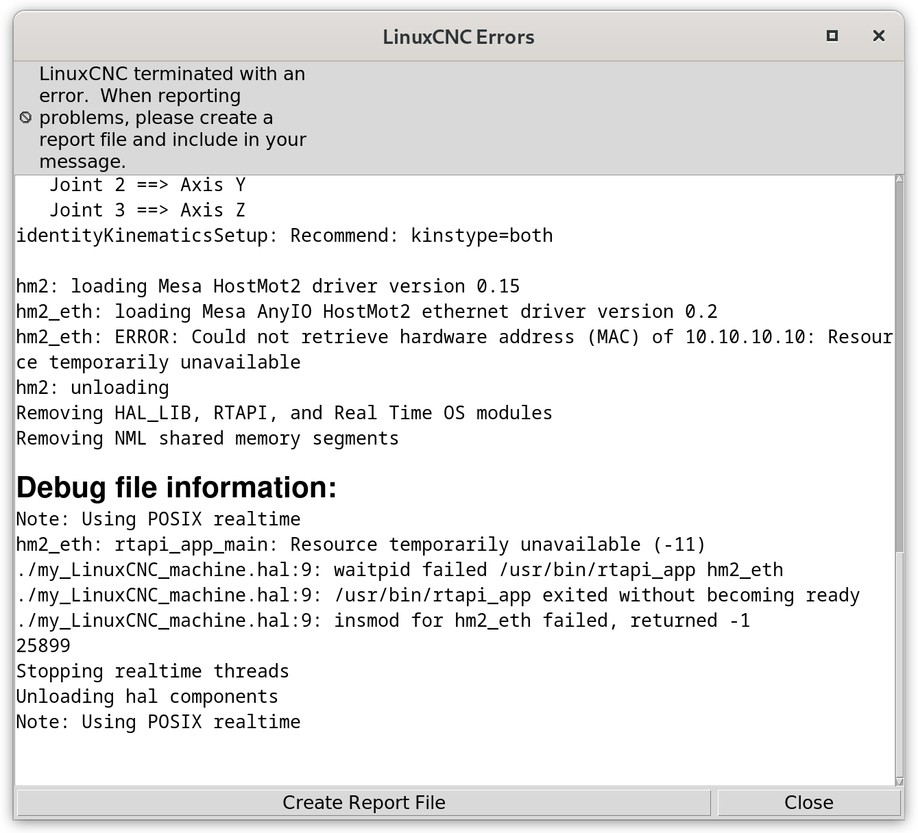

1 year 10 months ago #317833
by RNJFAB
1 year 10 months ago #317845
Networking not set???
What does
ip a
return?
What does
ip a
return?

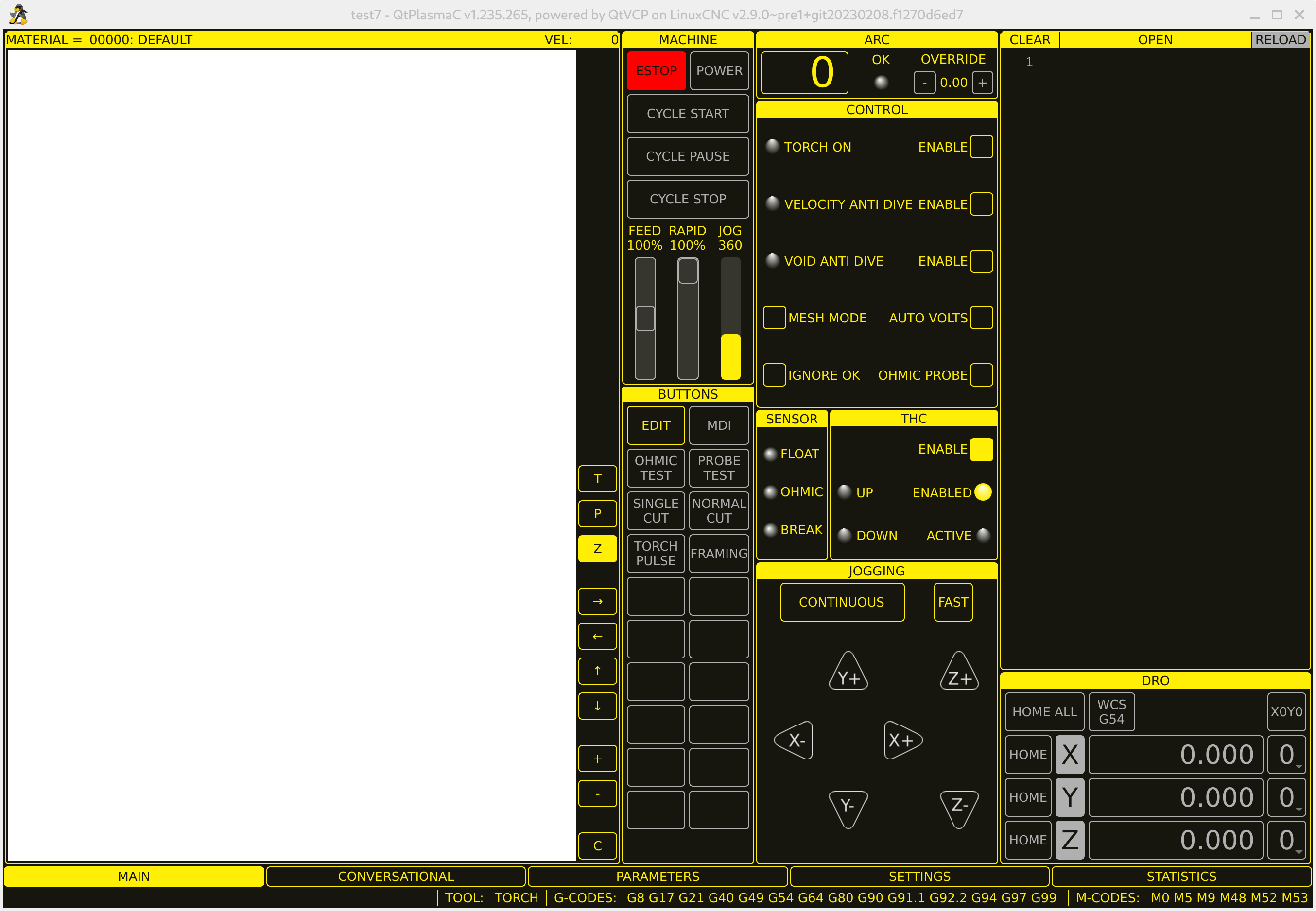

1 year 10 months ago - 1 year 10 months ago #317859
by RNJFAB
OK.
Wasn't sure about a real time kernal, so check and have "6.1.0-28-rt-amd64".
Have uninstalled all traces of LinuxCNC, and now using the synaptic package manager, have loaded the latest linuxcnc versions.
Start up pnfcof with the mesa 7i96, everything worked.
Still having the same issue. estop is red, cant be unclicked.
Cant select power. left hand side of the screen is blank/glitchy.
Any ideas??
Any ideas??
