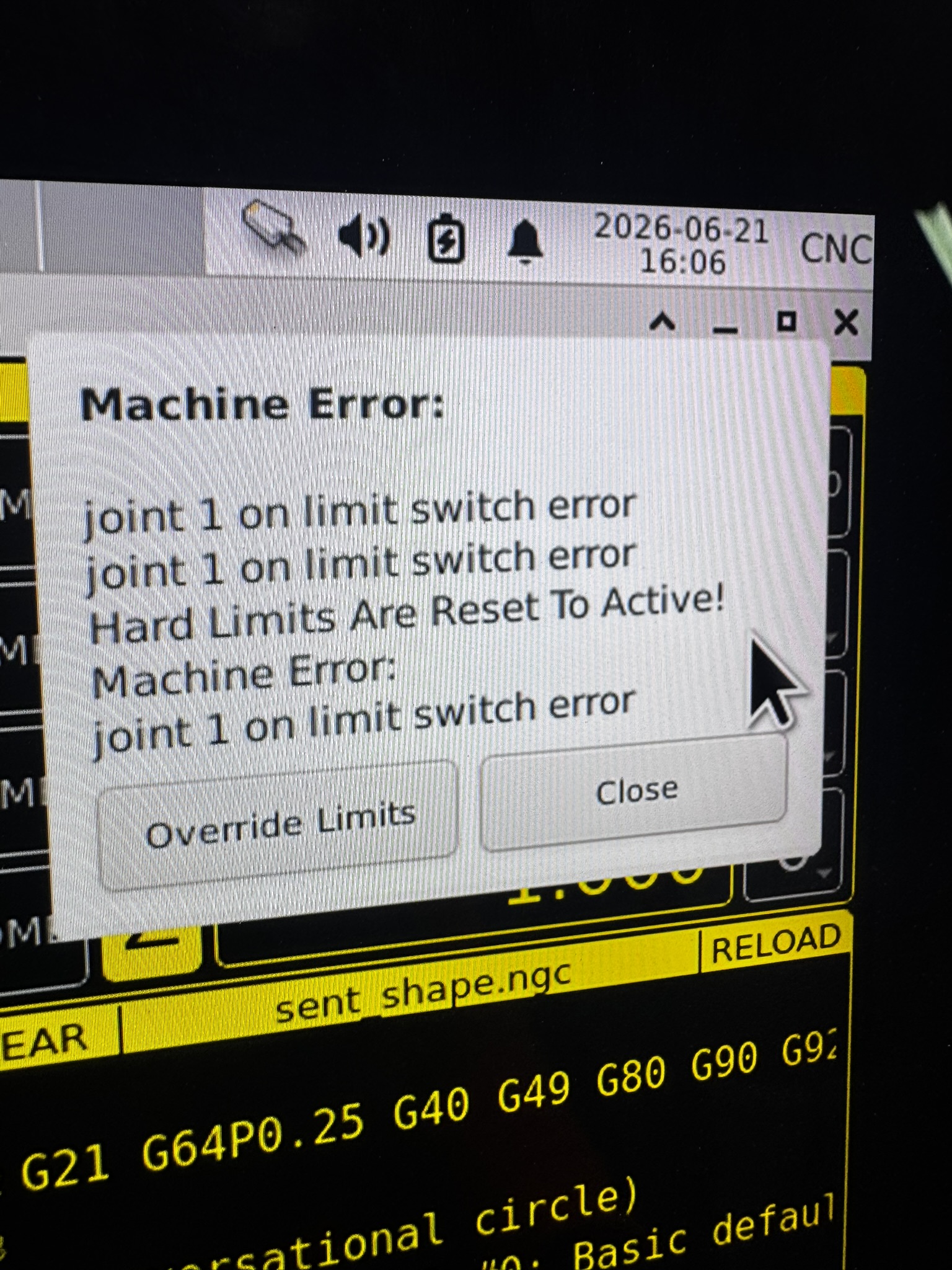

Over a year of flawless cutting, new issues today.
It has been creeping in for a few weeks now. Occasionally, then every day, then ever cut, now every pierce. And now impossible to cut anything.
Doing my head in why it appeared.
Because I'm useless at linux and the cnc has no internet connection, getting anything on the computer is a mission. So, I have not updated linux in years.
Any ideas? things that may have changed?
Am I just overthinking this and just need to bump the debounce from 5 to 7?
