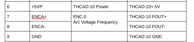

- Posts: 18115
- Thank you received: 5333
02 Feb 2025 15:57 #320423
Replied by PCW on topic Homemade CNC Plasma - hypertherm, Mesa, gear drives, nema 34.
No, 7I96 TB2 pin 12 is the correct 5V source.
What are the scaling factors that you used?
(there must be a missing hal file where plasma voltage scaling/offset is done)

03 Feb 2025 10:49 #320486
by RNJFAB
Replied by RNJFAB on topic Homemade CNC Plasma - hypertherm, Mesa, gear drives, nema 34.
scale = 0.00779537
offset = 3637.5
offset = 3637.5

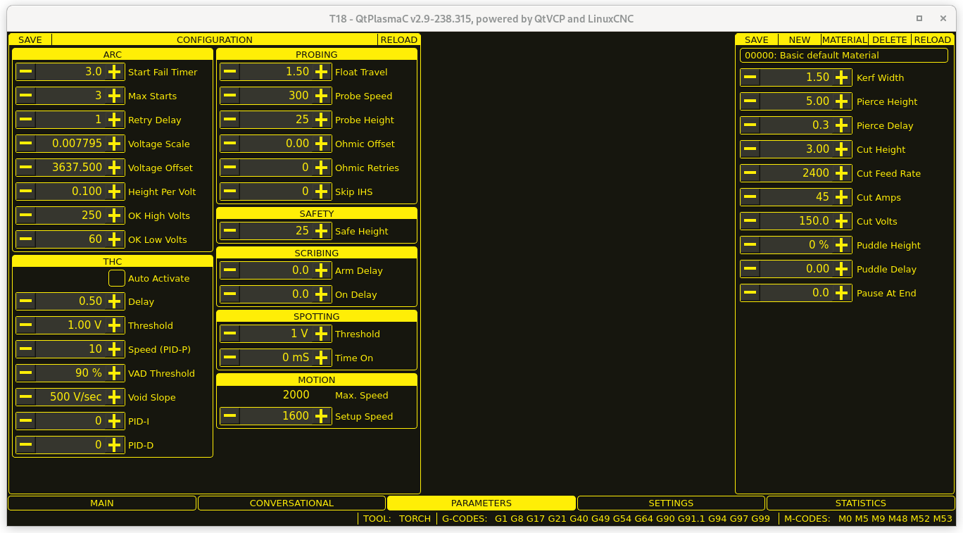

Replied by rodw on topic Homemade CNC Plasma - hypertherm, Mesa, gear drives, nema 34.
QTplasmac stores the THCAD scaling settings in the GUI as per the previous screen dump the OP shared.No, 7I96 TB2 pin 12 is the correct 5V source.

03 Feb 2025 20:24 #320533
by RNJFAB
I’m sure it’s something very simple that I have got wrong.
last night I realised that I don’t have an arc ok showing when the torch fires. Checked wiring and it’s all correct.
Cpc pin 12 goes to input 10 on the Mesa, pin 14 goes to common +.
