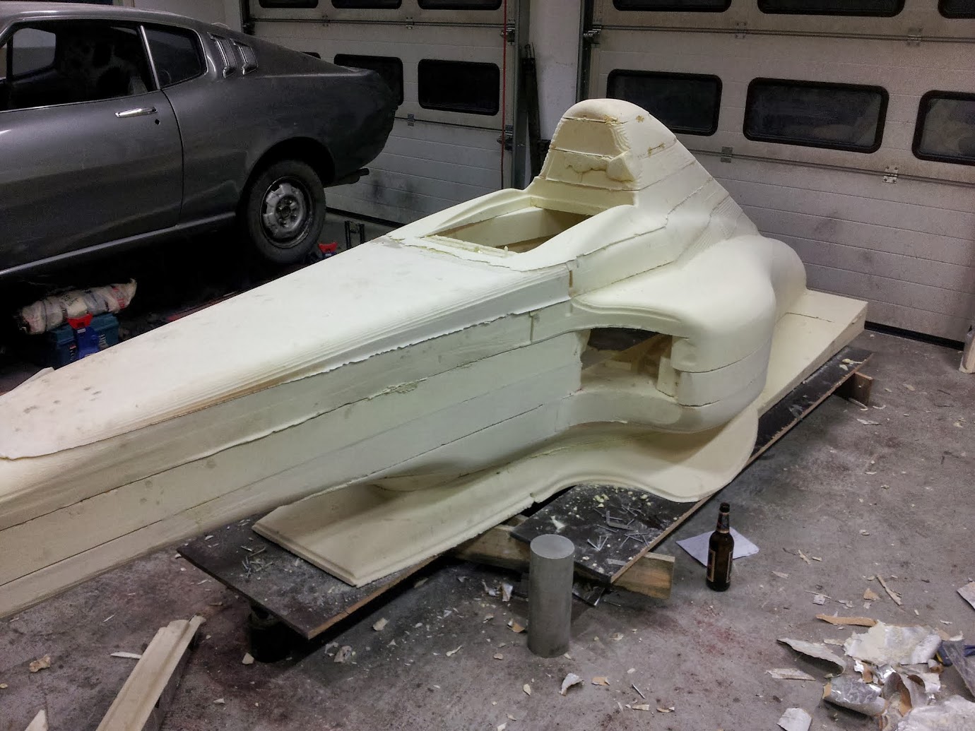

04 Feb 2018 21:46 - 04 Feb 2018 21:58 #105421
by jsskangas
Replied by jsskangas on topic TCP 5-axis kinematics
Hello
Mainly Im machining some part to my projects like this one:
goo.gl/photos/f7dNbH5akwFsL6MY6
Those parts are mostly prismatic so no full 5-axis needed in there.
Full 5 axis tool path's I use for machining impellers and turbine wheels.
At the moment i use loan machine for those...
I did look at the code and am still not certain what is wrong with it.
It changes kinematics so Code works and input HAL pins.
Values are written in pins in those functions that actually calculates forward and inverse kinematics.
If I make changes to kinematics I can verify that those. so Im compiling a correct file.
But out pin values wont change. I just need this for debugging code, so does only slow down the process.
There is still one this that I have not tested, output pins are not connected anywhere, that could affect...

05 Feb 2018 09:43 - 05 Feb 2018 12:59 #105432
by jsskangas
Hello
I do not see your point?
I do not have problem with 5-axis tool path's, making those and simulating them is easy part.
Problem is transferring between two different kinematic models inside linuxcnc.
TCP (rotating coordinate system) and straight forward linear.
"I like too see a picture of what you are doing with linuxcnc."
You are looking at them. ( goo.gl/photos/f7dNbH5akwFsL6MY6 )
all those parts except that impeller is made with Linuxcnc.
That old mori is running linuxcnc and 4kW indramat servos + nikken 5ax120, 5 axis table.
