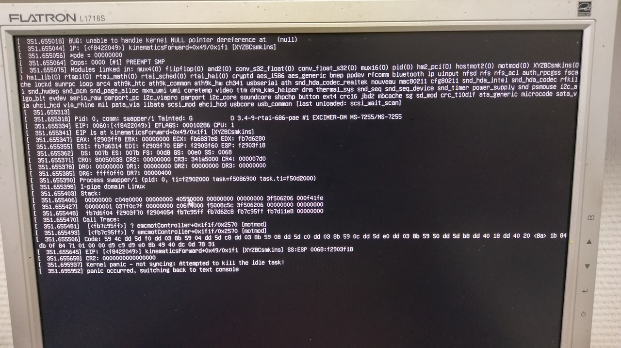

Replied by Spetrov on topic TCP 5-axis kinematics
Hi, jsskangas, I tried your kinematics and got an error(on photo), could you help me please?
Even when I compiled your file, I had errors. I myself was able to correct them, but I could be wrong.

- jsskangas
- Posts: 144
- Thank you received: 9
25 Aug 2018 05:43 - 25 Aug 2018 07:33 #116570
by jsskangas
Replied by jsskangas on topic TCP 5-axis kinematics
Hello
Yes there seems to be error that has occurred during packing or uploading.
I will take new files.
There is still error at least in forward kinematics.
This is not usable yet.
I will correct kinematics, but at the moment it will take at least 3 weeks until I get fee time for this.
