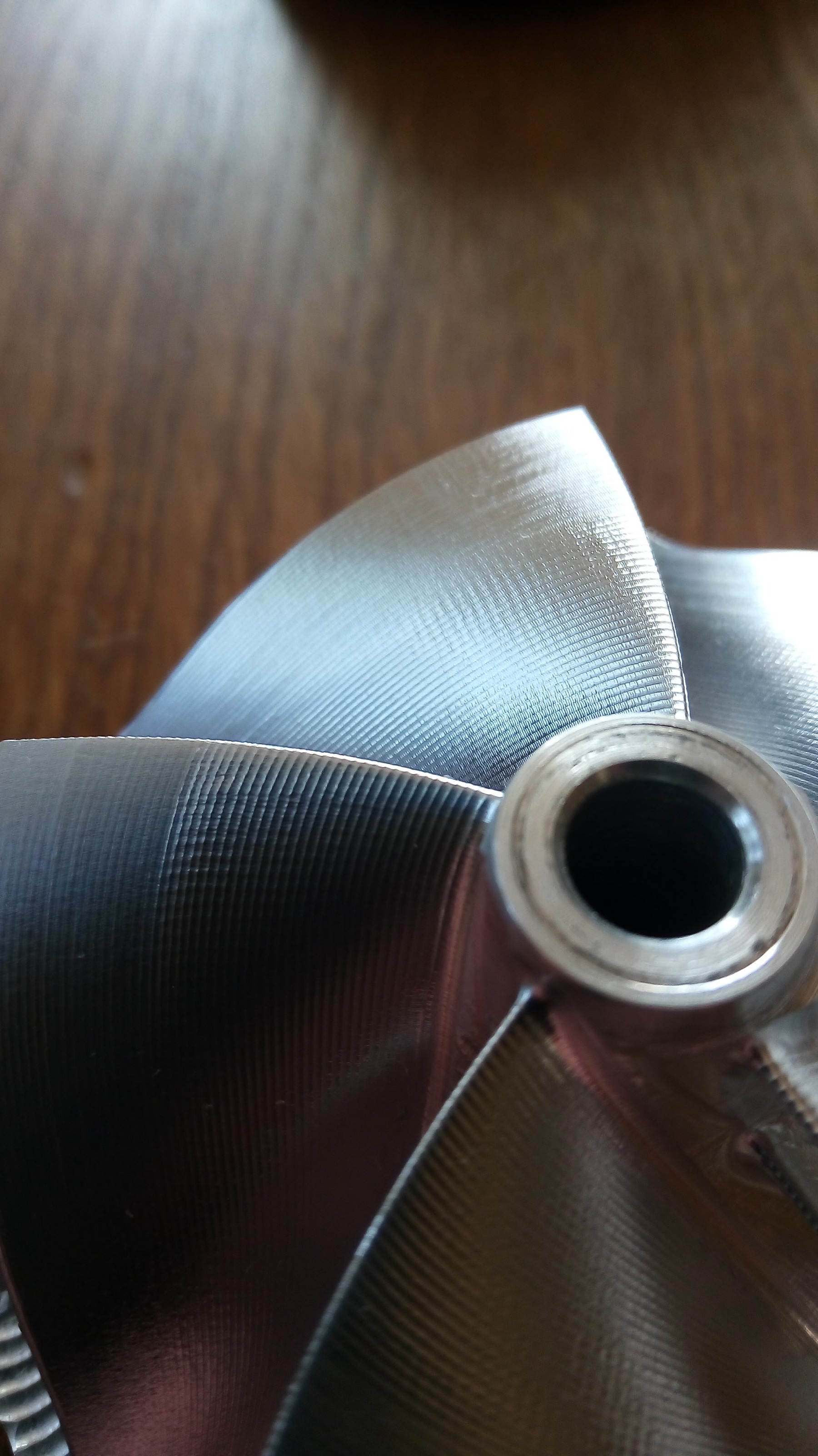

14 Apr 2018 15:02 #108998
by jsskangas
Replied by jsskangas on topic TCP 5-axis kinematics
Ok, I finished impeller today.
Now i can say more about 5-axis capabilities.
I got rid of most of jerk by limiting rotary axis acceleration.
Now linears don't need to do make too fast compensation movements, this did not affect too much on performance.
Surface quality was better than I expected.
Here is video of nc-code simulation:

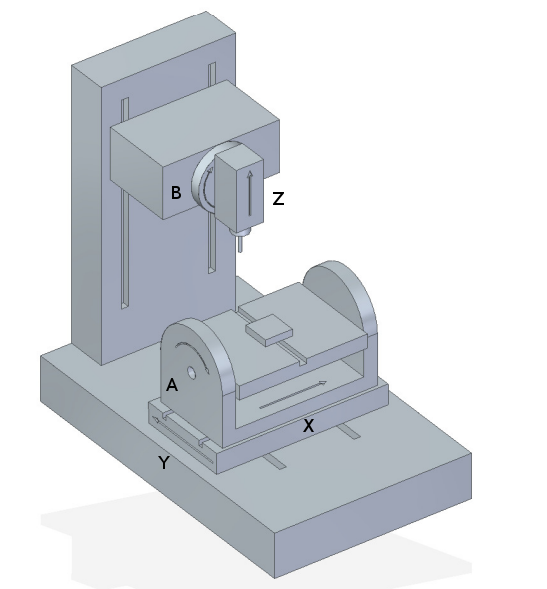

- 819132306
- Posts: 26
24 May 2018 14:06 #111080
by 819132306
Replied by 819132306 on topic TCP 5-axis kinematics
Hello,
jsskangas.
You have switched between RTCP and 3+2 machining modes on LINUXCNC without restarting LINUXCNC.
This is very cool.
I want to construct the following two structures of 5 axis kinematics.
But I don't know much about this homogeneous transformation.
Only the table-table structure is in the linuxcnc help documentation.
linuxcnc.org/docs/ja/html/motion/5-axis-..._axis_configurations
Looking forward to your reply
jsskangas.
This is very cool.
