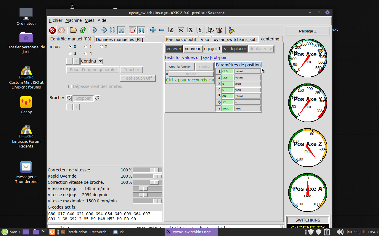

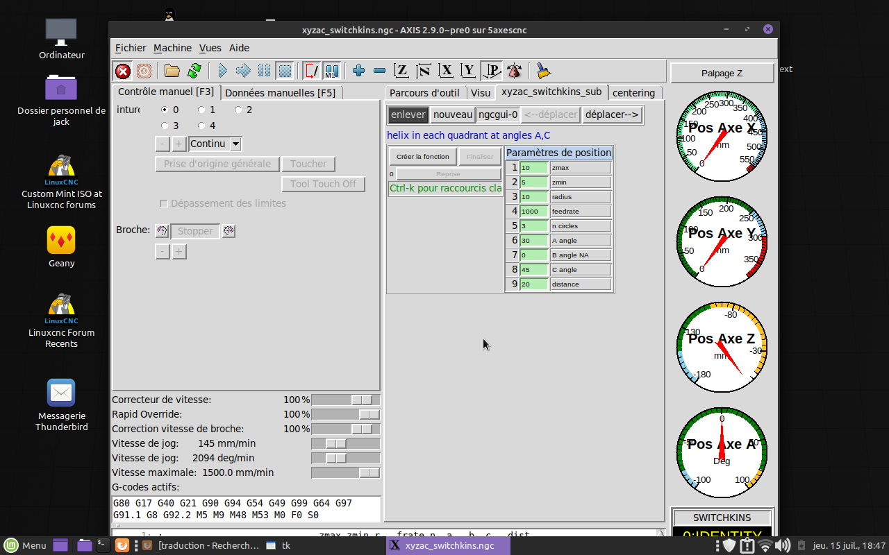

yes, I got there now I have version 2.9pre under Dabian 10.
I am now looking to install the switchkin branch with buildbot.
If might be important to deinstall 2.9pre in synaptic manager prior to trying to reinstalling current 2.9pre. The procedure to uninstall the installed version of linuxcnc in Synaptic Package Manager can be seen in the video I posted.
But I'm really not sure why you insist on not using the official 2.8.2 ISO and update that to current master.
[edit]
maybe there is a misunderstanding and you already have updated to current 2.9pre? Have you checked if millturn config is available in the configuration picker?

15 Jul 2021 16:04 #214892 by JackRay
Replied by JackRay on topic TCP 5-axis kinematics
OK, thanks ,
it works I didn't understand that it was necessary to open an xyzac simulation and then save it.
the language barrier is not always easy ...
I will now put my config.
it is much simpler than all the compilations that I have been able to perform (search for all sources) etc ...
thank you all
15 Jul 2021 16:09 #214894 by Aciera
Replied by Aciera on topic TCP 5-axis kinematics
That is not really necessary. The reason why I wanted you to check the simulation configs is because that is an easy way to find out if you have 2.9pre with switchable kinematics installed.
Anyway, I'm glad you got it working.
one last question, what are these two tables for in the linuxcnc xyzac-trt interface. Is there an inflance in the position of the pivot center.
or the settings of the pivot center in the .hal or .ini files are sufficient
Thank you
15 Jul 2021 17:43 #214908 by Aciera
The first table is to change the helical tool paths in the example program and the other seems to be for experimenting with the rot-point But these are not necessary.
The important thing is to get the Y,Z offsets and the X Y Z values of the rotation point right.
Nice to see that you got it working too.
