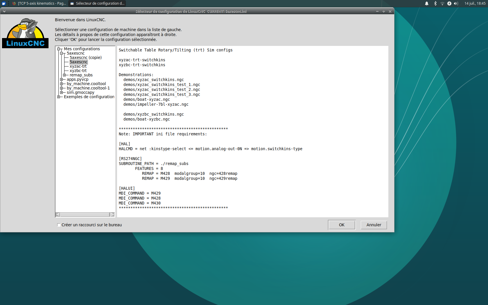

15 Jul 2021 04:34 - 18 Jul 2021 01:22 #214806
by dgarrett
Replied by dgarrett on topic TCP 5-axis kinematics
Your linuxcnc_info.txt report shows:
"lsb_release -sa: Ubuntu Ubuntu 18.04.5 LTS 18.04 bionic
DESKTOP: xubuntu
cmdline: BOOT_IMAGE=/boot/vmlinuz-5.6.19-rt12 ...
ii linuxcnc-uspace 1:2.9.0~pre0 amd64 motion controller for CNC machines and robots"
It appears that the the linuxcnc-uspace package was
NOT installed from the buildbot since buildbot deb installs
report with a line like:
"ii linuxcnc-uspace 1:2.9.0~pre0.4140.gb54a9f3bd amd64 ..."
In the above, the '4140' is a buildbot id and the
number string after the '.g' (b54a9f3bd) is the git
commit used for the build.
So -- i don't know how you installed linuxcnc-uspace
and furthermore i don't know where you got the rt
kernel with version 5.6.19-rt12 (i don't imagine that
kernel was available directly with xubuntu 18.04)
If the linuxnc-uspace package was built before the
merge-to-master date for switchkins (19jun21), it will
not have the switchkins functionality.

In summary, for the current master branch one must now
use buster or use a run-in-place install.
I did a test in a virtual machine to see how to
install a master branch deb for buster rtpreempt):
1) From the page linuxcnc.org/downloads/
download and install the iso:
Edit latest is: www.linuxcnc.org/iso/linuxcnc-2.8.2-buster.iso
2) test (2.8) by starting linuxcnc and running a sim config like:
configs/sim/axis/axis.ini
3) Add the buildbot packages by following the instructions:
buildbot.linuxcnc.org/

15 Jul 2021 07:51 #214817
by JackRay
Replied by JackRay on topic TCP 5-axis kinematics
I managed to install the latest version of linuxcnc on Debian 10:
"LINUXCNC - 2.9.0-pre0-4140-gb54a9f3bd".Now can I install my configuration?
