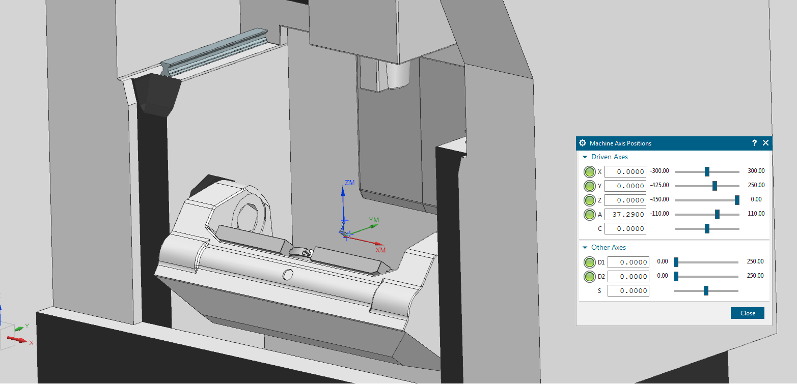

16 Jan 2022 13:11 - 16 Jan 2022 13:12 #232011
by jsskangas
Replied by jsskangas on topic TCP 5-axis kinematics
hello
Finally I have need or forced to upgrade my setup to switchkin functionality.
I installed Buster and 2.8 version and updated to newest 2.9 pre0 5518.
Few notes why I need compile my own kinematic and why I can not use supplied ones.
XYZBC kinematics are still wrong, C axis rotates correctly, but B axis rotates wrong direction .
Second reason is I updated my mill with A axis, I run now 6 axis setup.
Nikken ax120 for BC axis and Detlev Hoffman as A axis.
So I need to change between 3 different kinematics, 1: linear, 2: XYZBC and 3: XYZA.
There is few question from how switchkin works.
M428, M429, M430 are routed to subprograms which two main function are
change kinematic mode and sync new position.
M68 command is used to control analog output pin which is then used to indicate kinematic mode.
M66 used sync new position to system
I use following lines in HAL to connect this analog pin to my kinematics
net :kinstype-select <= motion.analog-out-03
net :kinstype-select => motion.switchkins-type
net :kinstype-select => XYZABCsmkins.wmode
Where is motion.switchkins-type connected and do we need it and if, why (as M66 does sync)?

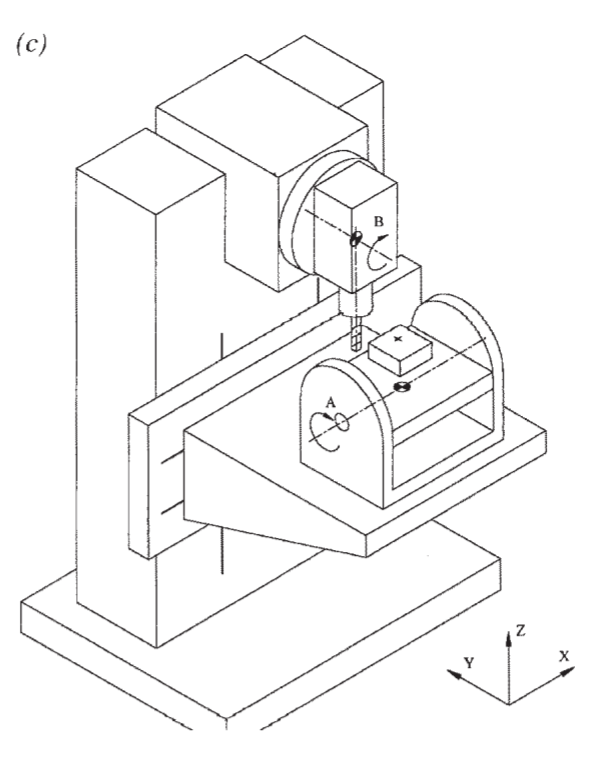

16 Jan 2022 15:13 - 16 Jan 2022 15:20 #232021
Replied by Aciera on topic TCP 5-axis kinematics
"XYZBC kinematics are still wrong, C axis rotates correctly, but B axis rotates wrong direction ."
I'm fairly sure that xyzbc-trt kinematics follows this convention, which seems correct to me:

16 Jan 2022 15:32 - 16 Jan 2022 15:35 #232022
by jsskangas
I was wrong both of those axis B and C rotates wrong direction.

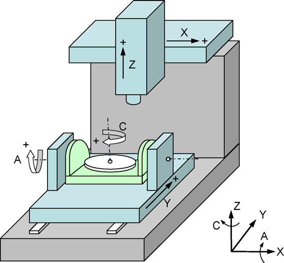

16 Jan 2022 15:50 - 16 Jan 2022 16:26 #232023
I don't have experience with 5-axis machining so I really have no idea but if the c-axis rotation follows the "right-hand" rule to define positive rotation direction then why would b-axis suddenly be opposite?
This seems to be in agreement with the current definition:
www.isg-stuttgart.de/kernel-html5/en-GB/296412555.html
Can you maybe provide more information as to the theory of how this is supposed to work?
[edit]
I found this xyzac setup with a and c supposedly rotating in the opposite direction:
As I said I have really no idea so maybe somebody could provide more insight.

16 Jan 2022 17:04 - 16 Jan 2022 17:44 #232027
by jsskangas
Ok
Basic idea is that we always program tool movement against part(G54 coordinate offset example).
Lets start with linear axis it is easy to explain.
When we program NC-code example X10.0, this means that tool is now in position X=10.0
Now if this X-axis moves tool, to get tool in to X10.0 position,
axis needs to move positive direction of X axis of G54 coordinate system.
In case of part is moved (table) it need to move negative direction to get tool in X10.0 position.
Same rule applies to rotation:
If tool is rotated, we use right hand rule.
If part is rotated we use left hand rule.
Lets take this A-axis from above machine, when we look along X-axis (not againt it), tool positive rotation is CW (right hand rule for rotating tool).
So if we command A30.0 tool needs to rotate Clock Wise 30 degree to achieve this position.
But again if we move part it needs to rotate CCW so that tool will achieve A30. position (Left hand rule for rotating part).
