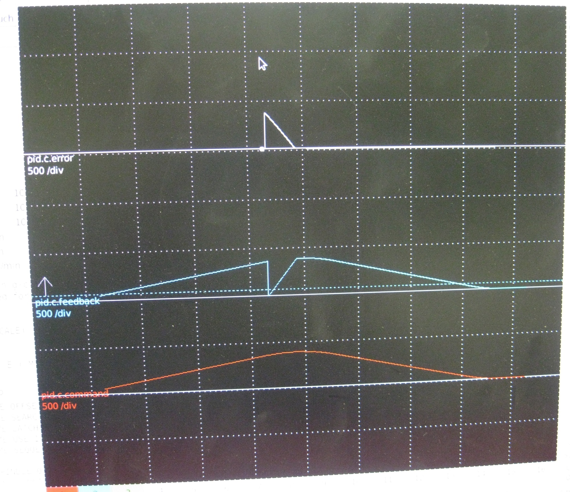

Step_scale @ 8000.
played with Velocities and Accelerations - Seems the best I can get it currently.
Still fighting Homing..
Home Issue-1
HOME ( start with C physically at abt 45deg )
> XZ OK as usual
> C goes to index slowly, reaches index then VERY FAST past and all way around, past index again, then stops, rotates the other way, slowly, back to index and stops.
Changing stepgen_Velocity and Acceleration changes this behaviour, but it is never clean - does the same type of movements, but very slow if values are small ( 10 or less) or faster as values are made larger.
HALscope of one of the home cycles attached - not sure if I recorded the correct parameters.
The vertical spike is where the first cross of index occurs
Home Issue-2
HOME ( as above)
XZ ok, C homes with above oscillation.
XZ DRO @ HOME position + ini offsets.
C DRO = 0

27 May 2021 22:13 #210475 by andypugh
There is an obvious error here in caxis.comp
        case 0: // C-axis mode
            if (spindle_on){
                state = 1;
            pid_enable = 1;
            spindle_velocity_out = pid_in;
            position_cmd_out = (spindle_revs - offset) + position_cmd_in;
            position_fb_out = (spindle_revs - offset) * 360;
            break;
offset needs to be converted to degrees, so it should probably be
position_cmd_out = position_cmd_in - (offset * 360 );
Though I am not sure that is the problem.
It might be the case that the caxis component needs to watch index-enable too, and do something clever. But I will need to do more experimentation to find out, and it's a bit late tonight.
30 May 2021 15:11 #210682 by andypugh
After a little more tinkering.
1) The return to set position after the spindle stops is best controlled by limiting the pid.c.maxoutput. That only needs to be as large as the max jog velocity, with perhaps a hint of overhead.
2) The caxis.comp should not try to manipulate both command and feedback, that is just asking for trouble. Delete the commented lines and replace with the uncommented one
net angle-cmd      joint.2.motor-pos-cmd      pid.c.command
#net angle-cmd      joint.2.motor-pos-cmd      caxis.0.position-cmd-in
#net c-pos-cmd      caxis.0.position-cmd-out   pid.c.command
3) Things go a bit haywire after re-homing in the existing comp. Replace with the attached and re-run halcompile.
The following user(s) said Thank You: NoJo
30 May 2021 18:30 #210712 by NoJo
Thanks for the update Andy.
I have tested it and bar the initial Homing of C it is all very well behaved.
The initial home is still a back and forth affair, as before, no change. I have slowed down the back and forth by setting [Joint_2]
MAX_OUTPUT = 2.0
Anything more and the oscillation worsens. 20 is scary...

30 May 2021 20:56 #210738 by andypugh
What is max jog velocity?
Simplistically it is the max that the angular axis slider will go to. But what you need is the PID output that still allows full-speed C axis movement, but not stupid-fast C-axis movement.
So, open a halmeter and look at pid.c.output, then see what value it has during max-speed jogs and G0 moves.
Then you can set the pid.c.maxoutput to just a bit more than the maximum you see there. Then you still have all the responsiveness for jogs and G0, but don't have far-too-fast moves when the index resets.
Now, it would be _possible_ for the caxis component to "lie" about the feedback position so that the final move to home was controlled, but I think that is an over-complication.
I presume the pid.c.maxoutput you indicate is the MAX_OUTPUT I mention above? If so, being picky, the return to C DRO position after a spindle run is still very quick with MAX_OUTPUT = 1.0. In fact, that return does not seem to change with MAX_OUTPUT values from 2 to 20...Am i fiddling with the wrong parameter?
Possibly. The HAL will tell you.
[code]setp pid.c.maxoutput [JOINT_2]MAX_OUTPUT
Which MAX_OUTPUT are you changing? It needs to be the one in the [JOINT_2] section. And it might need to be less than 2 (2 revs per second?)
31 May 2021 08:09 #210778 by NoJo
Well, I think you have cracked it!
WRT pid.c.output;
In AXIS screen jog mode with slider set to max (5000deg/min = 83deg sec)
A jog of approx 360deg takes approx 4sec, so the numbers tally.
during that jog a halscope of pid.c.output shows a max of 0.23
In MDI a G0 C720 shows a peak of 0.8. I used 720deg as 180deg never achieved max velocity before end.
So I set C Axis - [JOINT_2] - pid MAX_OUTPUT = 1.0
Now everything is very well behaved, except for that initial HOME of the C axis - but that is now very tame and unobtrusive so lets live with that.
all jogging, all spindle run then halt/return to C DRO position, all C axis moves, etc are very clean and stable.
I believe you have sorted the C axis implementation! very nice indeed.
