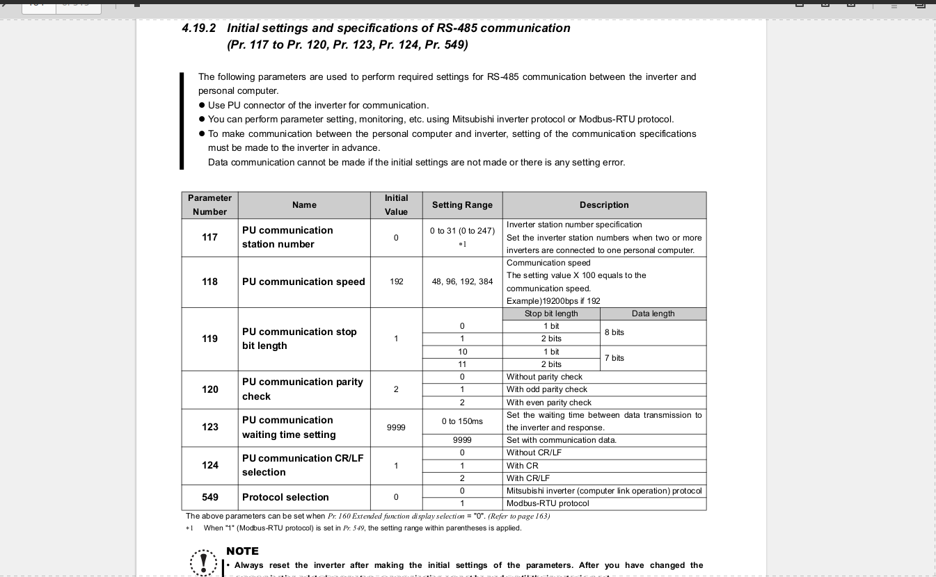

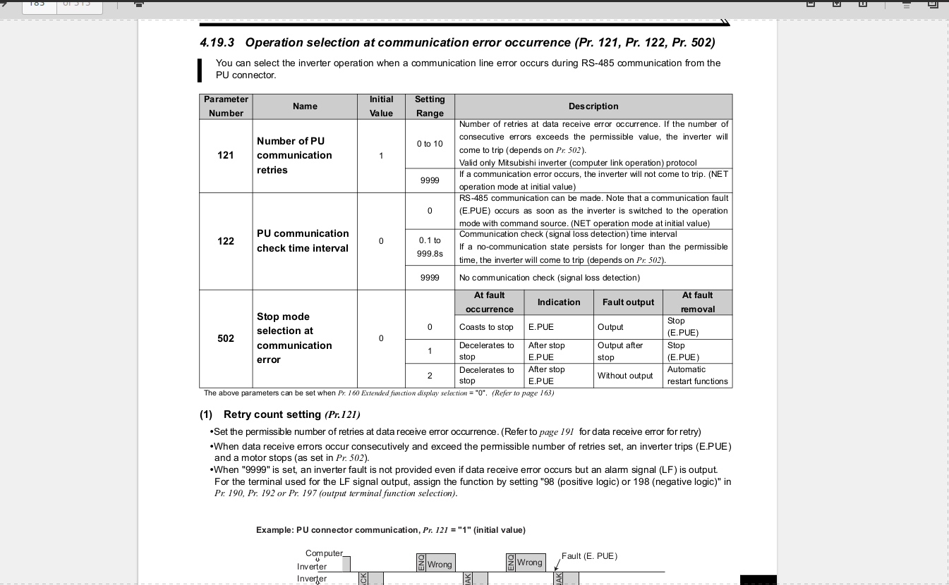

I thought I'd add the official docs for communication with the 720.
Then I hopefully won't make anymore errors.
117 is the station number not stop bits.
119 is stop bits and should be 1
122 sets the time out not 123 (sorry my bad)
123 should be 9999 (sorry my bad)
you might check pr 549 protocol select - I've never changed (even looked at) it on any of my vfds but would expect that 0 is the right setting.

chris... for the future..and all the idiota like me.... please please write BIG into your description that pr 549 must set to 0!!!!
pr 549 switch between rtu and computerlink....ITS NOT RTU
