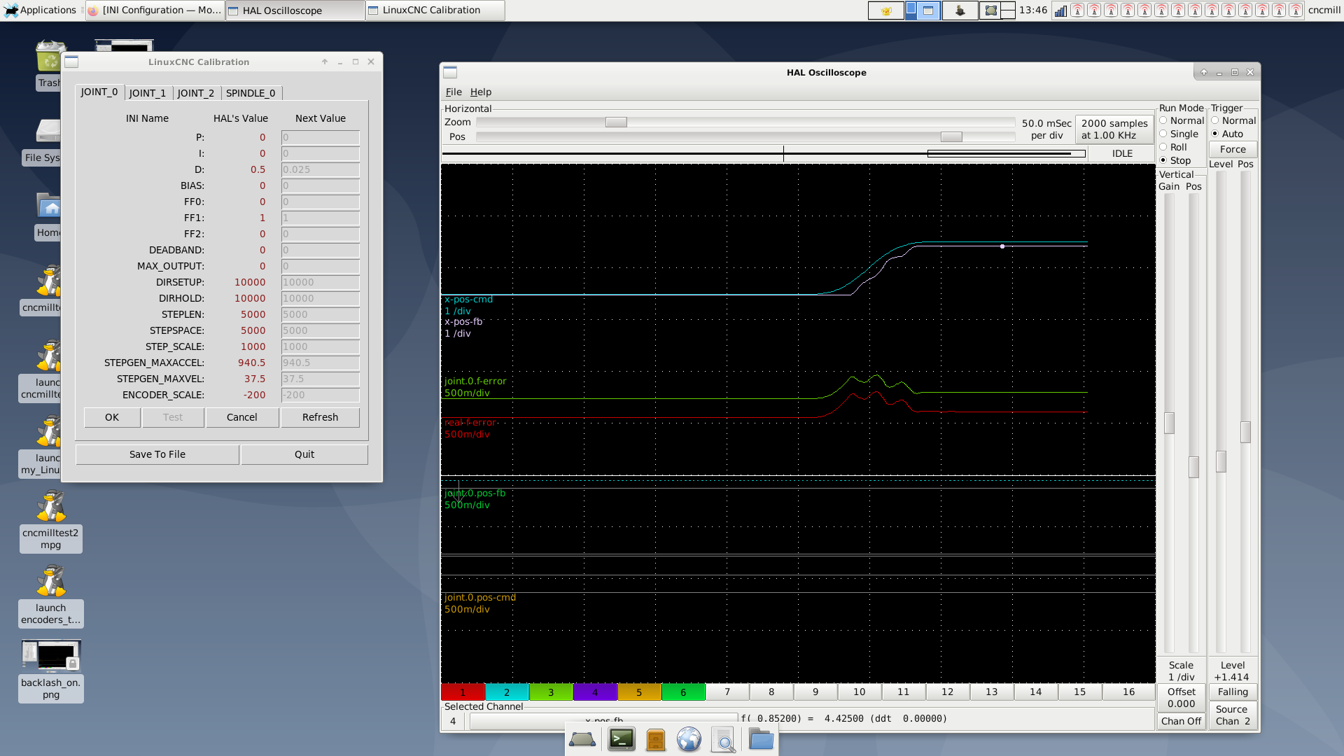

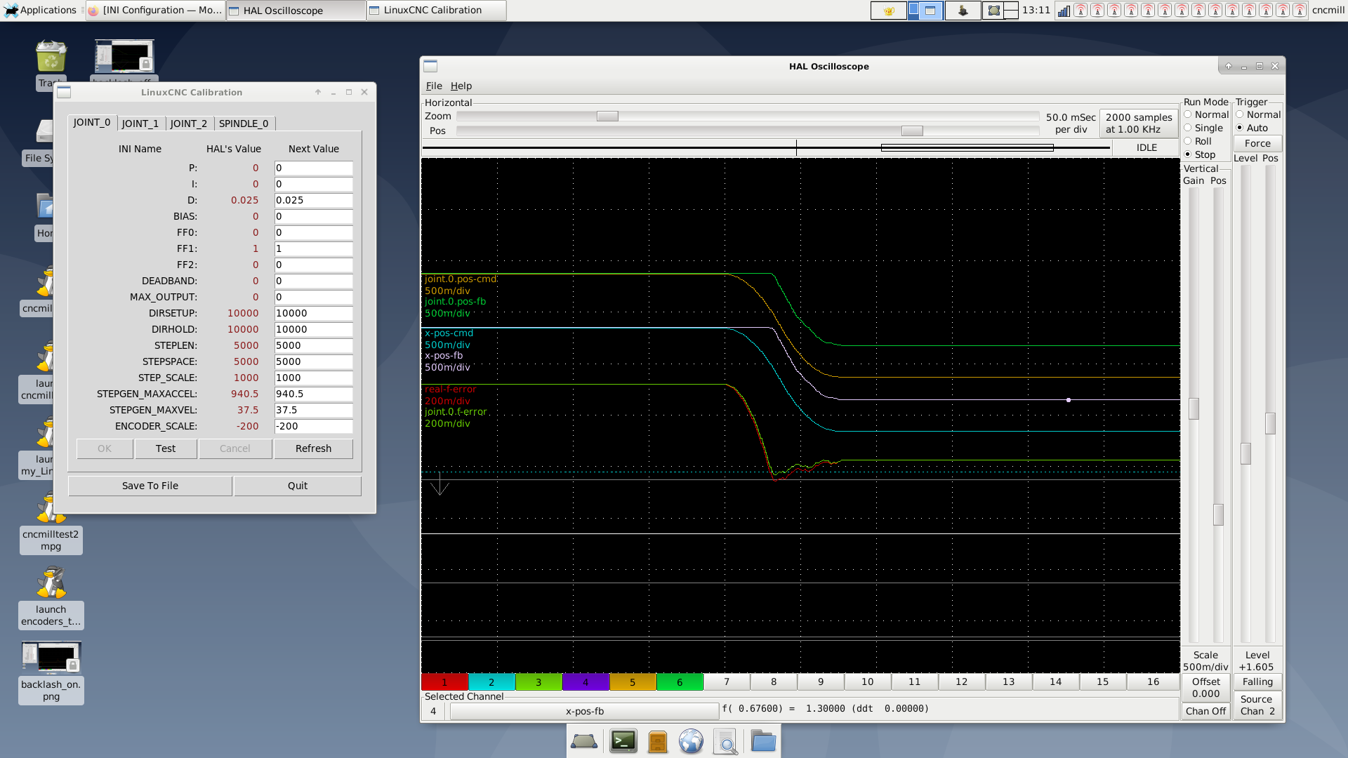

RotarySMP, yes, the actual backlash of the acme screw which i still have is about 0.27mm. I just tried running with open loop and software backlash compensation. Doing a few back and forth this way gets me to within 0.02-0.05mm accuracy (repeatability), as per the DRO independently connected to the glass scales. I get that could be good enough for now and until I install actual ball screws. You think there is no way I fight this backlash with encoder scale feedback on the acme thread right?
Todd, yes, this is open loop with only the "feedback from the linear scale to "joint.N.motor-pos-fb" (keep the stepgen's position feedback connected to the PID loop)", as per your suggestion, or I guess how I understood to implement it in hal. Was that correct?

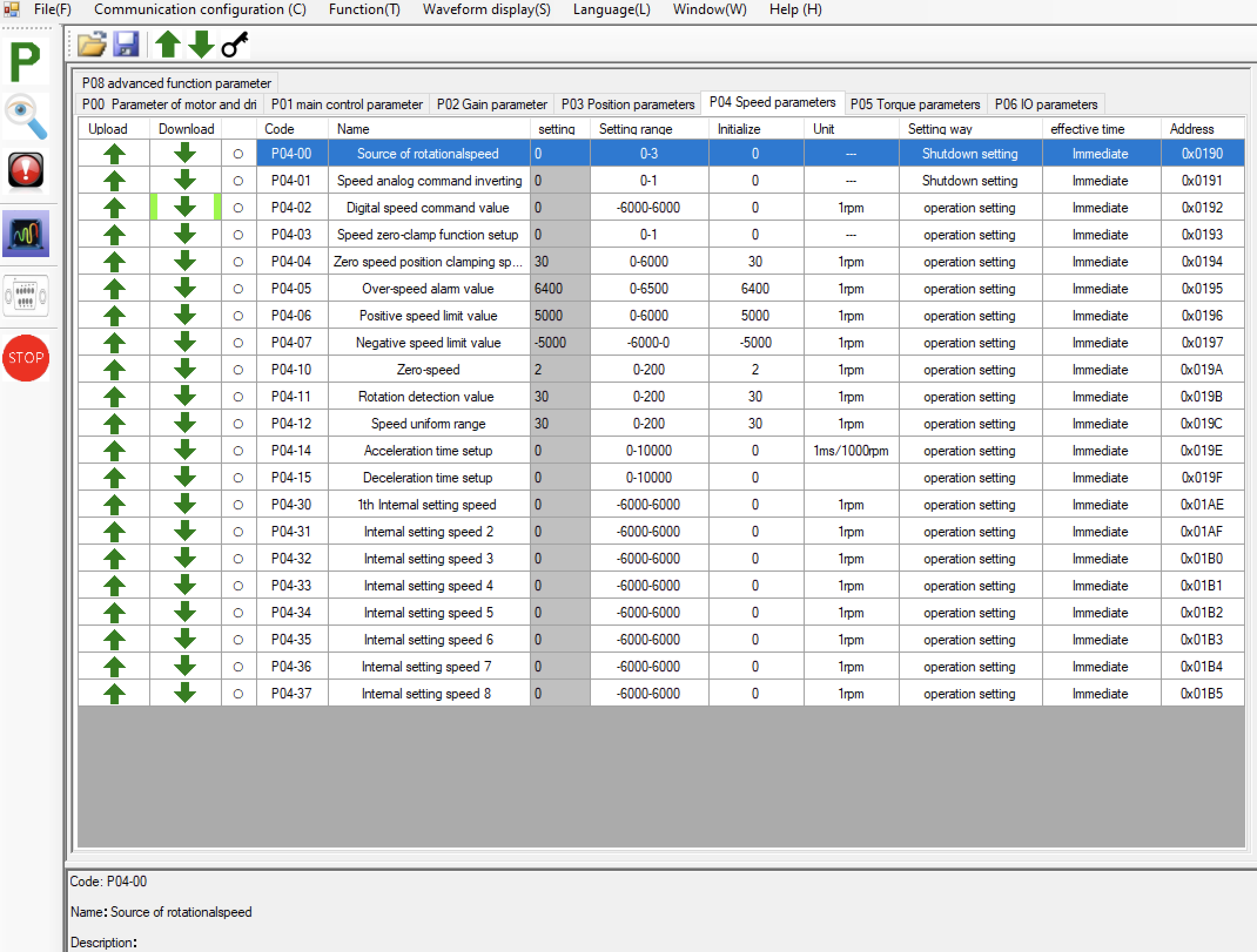

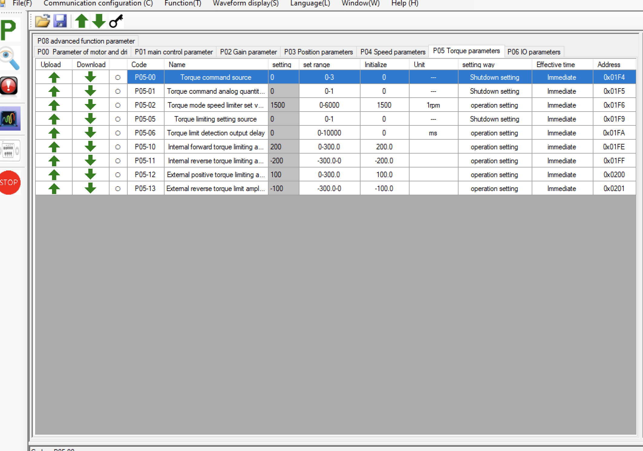

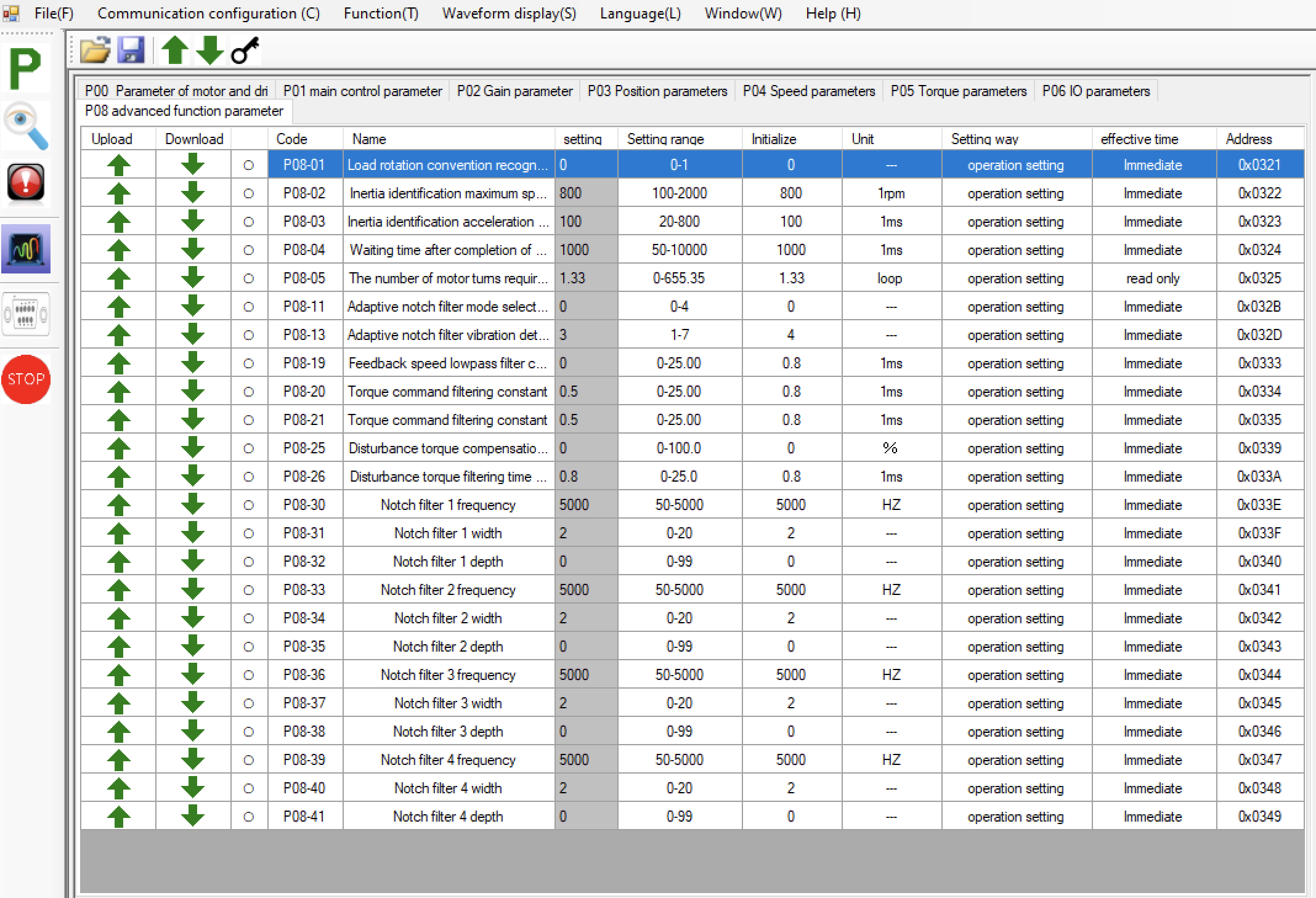

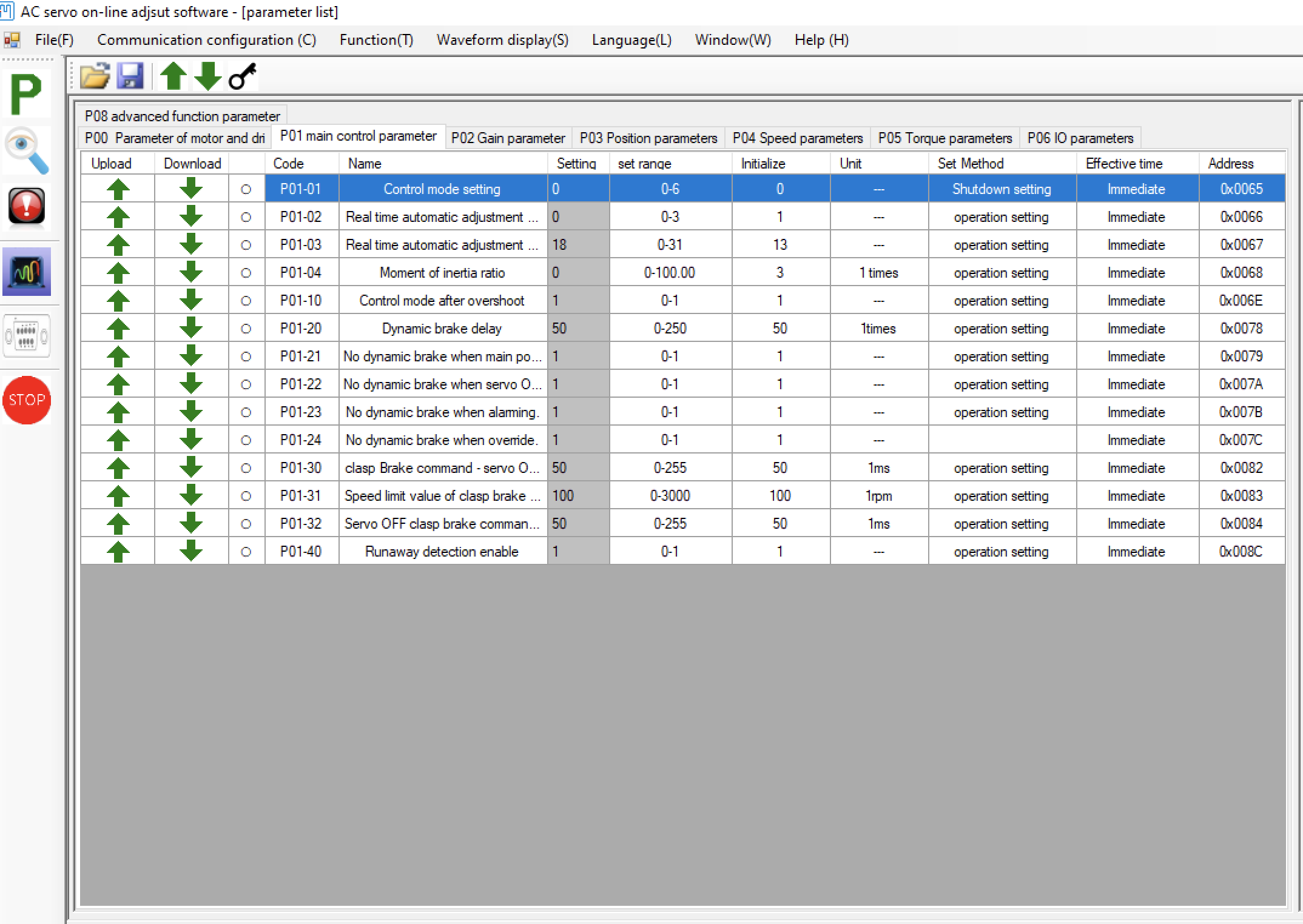

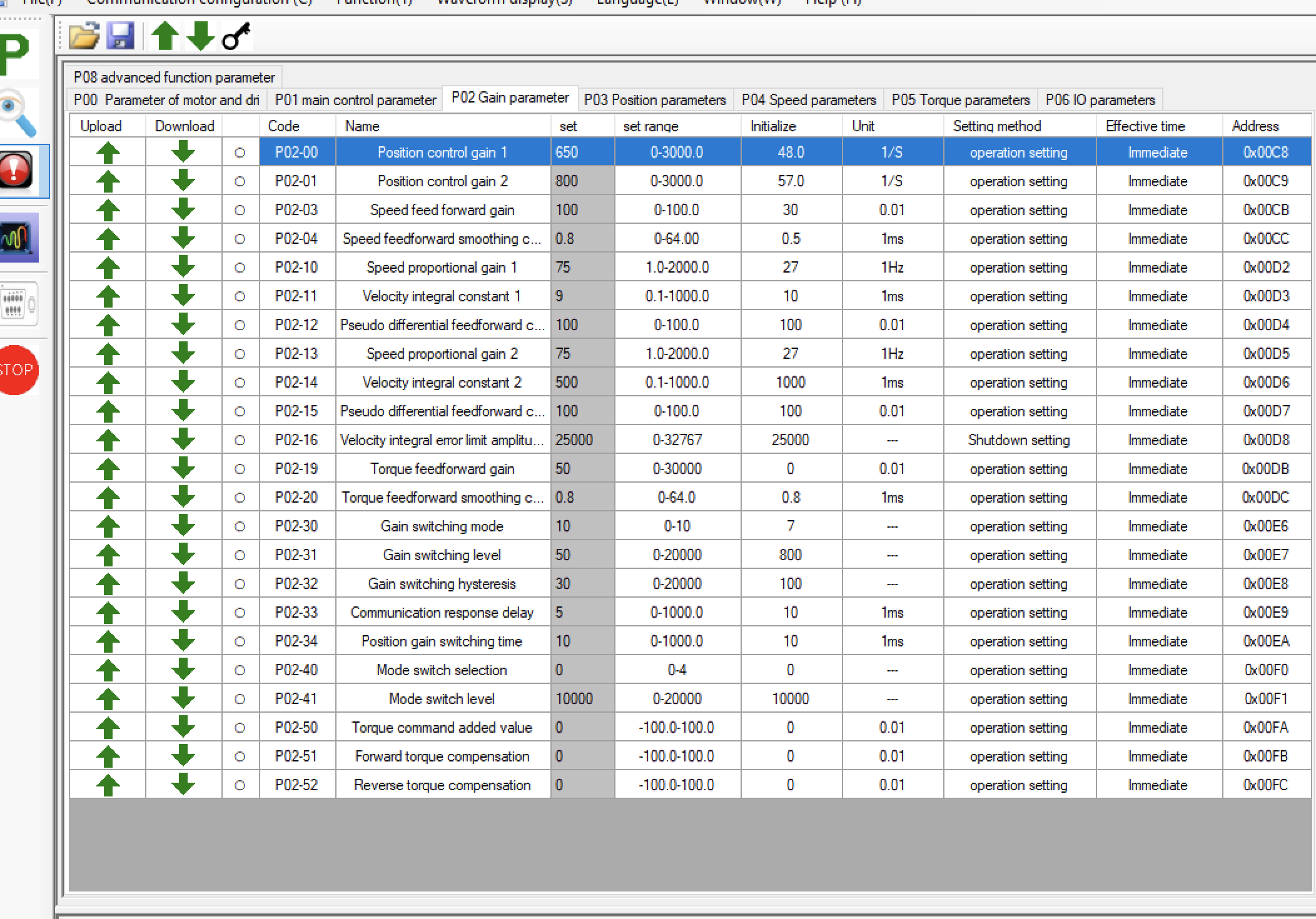

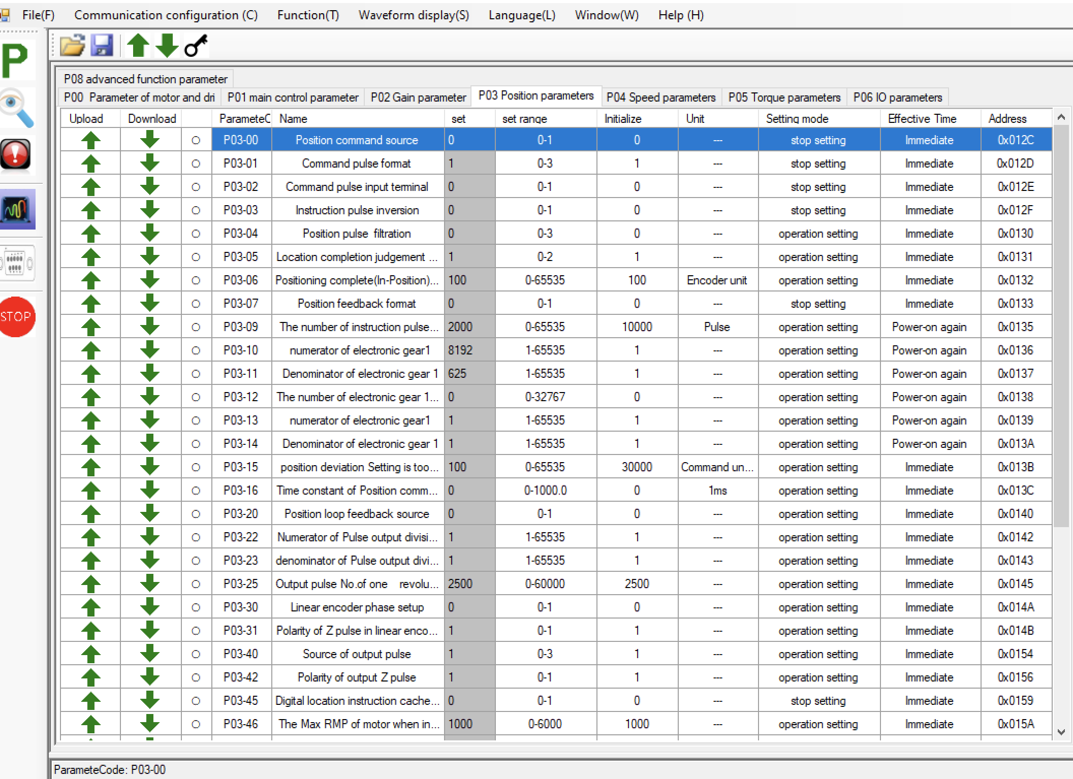

Here are some screenshots of the drive settings as I got them now. It's an AC 750W JMC servo. I mainly played with settings in the gain tab, mostly with the 3 first ones, which I understand as the P parameter. I'm not sure what the derivative would be here. It's pretty confusing. I also added a slight filtering in the advanced functions tab -> torque command filtering constant, to remove the last slight vibrations I had left. I also reduced the step amounts per revolution from 10000 to 2000, in order to be able to get a bit more velocity and acceleration out of LinuxCNC, I have a belt reduction between the motor and the axis of 2/3. Half a turn of the servo moves the table 1mm.
I also add a capture of the driver scopes. It shows a following error of +3 -3 units max at a speed of 1800mm/min. As I understand units are in encoder steps. If that is true and the encoder is 10000 per turn, then a millimeter movement of the table is 5000 units and so 3 units are under a micron following error.
Is that a problematic tuning? If so what would you change?
Thanks a lot I'm very new to this.

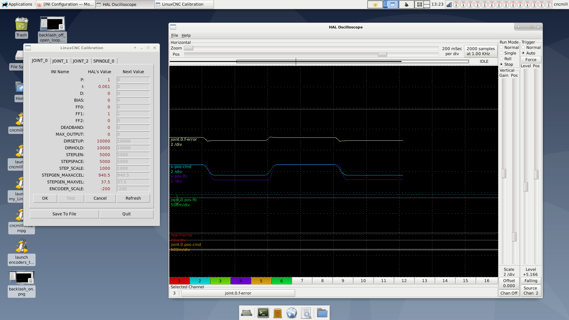

Is the servo being controlled in position mode or velocity mode?
If the step-dir is position then I would start with an FF0 of 1.0 and everything else zero. That should be identical to not having the scale feedback at all.
Then slowly increase the I gain (not the P) to pull out the accumulated error.
With a position to position loop I would expect a very small amoiunt of P to act like D on a position-velocity loop, and I to act like P.

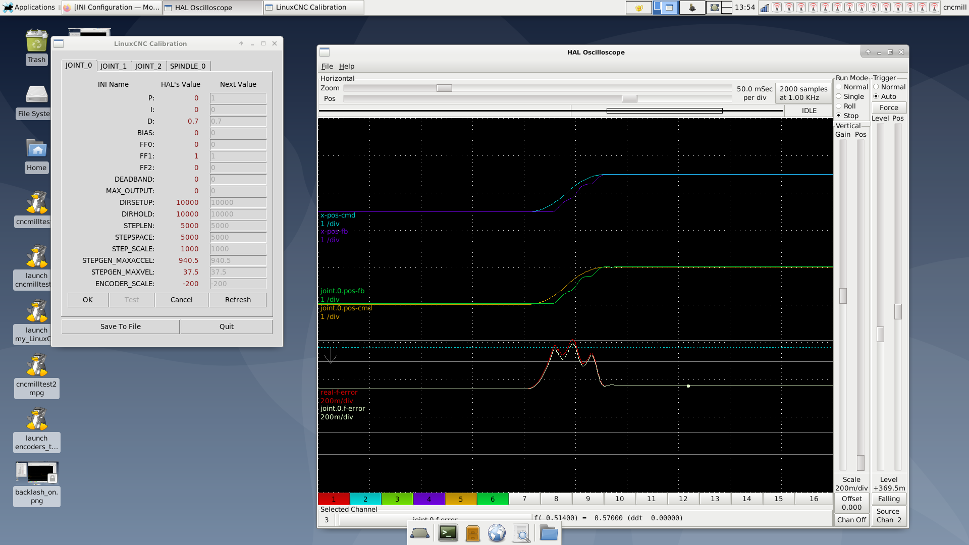

I ran some test as suggested by AndyPugh.
Basically once I connect the scale to the feedback, which I do this way, let me know if wrong:
So once they are connected, if I put anything else than 0 for FF0, P or I, the axis starting running away. I doubled check that the encoder scale is in the right "orientation", it is.
FF1 at 1 and some small amount of D seems to help fight backlash and doesn't run away, but the axis becomes too stiff very fast and vibrates on long moves.
I really don't quite get what's going on with it.
any idea?
adding some scope captures with respective settings in calibration.

net x-pos-rawcounts <= hm2_7i95.0.encoder.00.rawcountsSo once they are connected, if I put anything else than 0 for FF0, P or I, the axis starting running away. I doubled check that the encoder scale is in the right "orientation", it is.
any idea?

I think you are on the right track with FF1=1, (that is what my setup uses.) Some small amount of D to help tame the oscillation at reversals due to backlash,
Use as much P as stability will allow, Also a little FF2 might help with the delay cause by the backlash.
So did adjusting the drive's tuning fix the big oscillations you were seeing with the open loop position commands like in the first Halscope traces you posted? I suspect that was the main source of your problems before. These last traces do look a lot better. Try following the steps for an ordinary velocity loop tuning tutorial. I think you should have better luck this time. But the delays from the backlash will still limit your systems potential. In other words you won't be able to tune it as stiff as you could if the backlash wasn't an issue.
Last edit: 05 Oct 2022 12:39 by Todd Zuercher.
