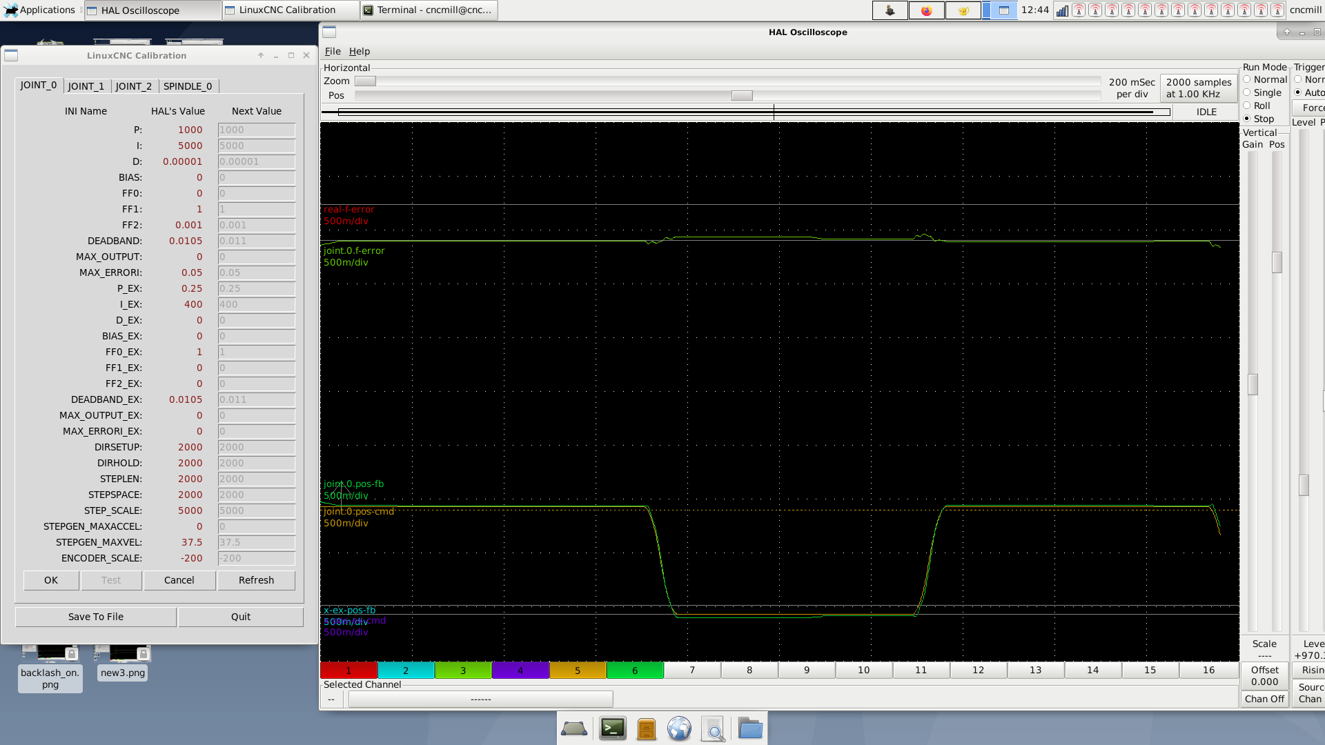

If you open a couple of halmeters on pid.x-external.command and pid.x-external.feedback and then add a tiny amount of I gain, does the feedback tend towards the command, or away?
You can do this from the tuning GUI or command line, I prefer to open a hal prompt where I can manipulate the hal pins directly with tab-completion.
for example.
In the data you show there is about .25 mm (inch?) difference between commanded and the scale feedback. Does that sound likely?
(I assume that you have not homed? I think that there may be problems to fix with homing)
halcmd -kf
loadusr halmeter pin pid.x_external.command
loadusr halmeter pin pid.x_external.feedback
setp pid.x_external.Igain 0.0001In the data you show there is about .25 mm (inch?) difference between commanded and the scale feedback. Does that sound likely?

Ok, I did this test. I was about to write something else because I was basically misinterpreting the data. Essentially when I add substantial I(ext) gain, the motor does move to compensate the backlash. If i increase it all the way to 150, it even does this rather fast. (at 0.5 it just shoots the 0.75mm and then moves very slowly towards the commanded position and reaches the 0.25 gap in a couple of minutes, which I intially interpreted as running away).
However, at 150 the axis does rattle a lot in longer moves. Like it's way too stiff. Which is very similar to the results I was getting with the single loop feedback: either too slow to compensate either too stiff. The main difference I would say is that in the current setup it doesn't tend to overshoot (it does at 150 but by 5um).
Yes, the trapezoidal screw backlash is about 0.25mm (metric machine).

You might be able to manage a higher I gain if you limit the max-error.
Look at pid.x_external.maxerror and pid.x_external.maxerrorI
The value is the distance in mm at which you want the max correction output. So possibly something like 0.05mm.
You can also try adding a bit of Pgain, that should speed things up a bit.

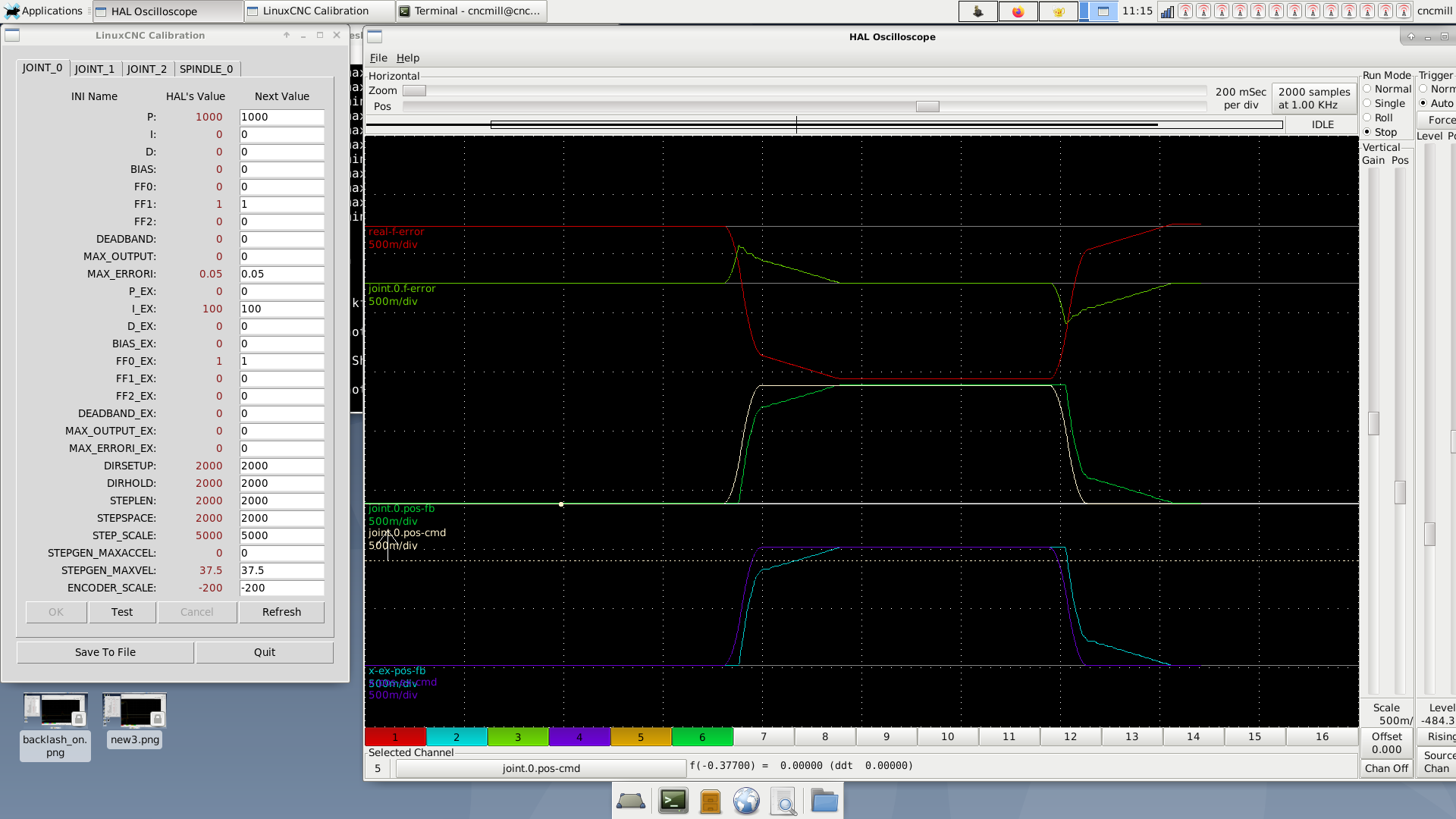

I got here, with much less rattling (though still a bit at some points on long rapid moves).
And a bit of overshoot on moves with no direction change.
I dont understand what the vertical divisions of the scopes actually show. It's kinda dump question, but thus I don't get what the error scale actually is in the real world. Would you enlighten me?
(also I tried to activate software backlash comp, thinking that it could maybe operate only on the interior loop, and thus give a result close to idea in my earlier drawing, but it doesn't seem to actually have any effect)

The f-error scale is 500m/div, which is 0.5 units per division.
You can change this for each channel with the gain slider on the right.
It looks to me like your f-error is around 1/10 of a division now, so about 50 microns / 2 thousandths of an inch.
But this looks like a step-change? It might be instructive to halscope some actual G-code at cutting speed, it will probably look a bit better.
18 Oct 2022 11:16 #254392
Replied by andypugh on topic linear scale and AC servo set up - sanity check
Also, bear in mind that this error is along the line of cut, so only sometimes does it translate to a part geometry error of the same magnitude.

alright, yes, I wasn't getting what unit. so millimeters yes?
yes for now i'm just jogging back and forth 1mm.
and doing some long rapid moves every now and then to check the stiffness (rattling).
all this at 1800mm/m
