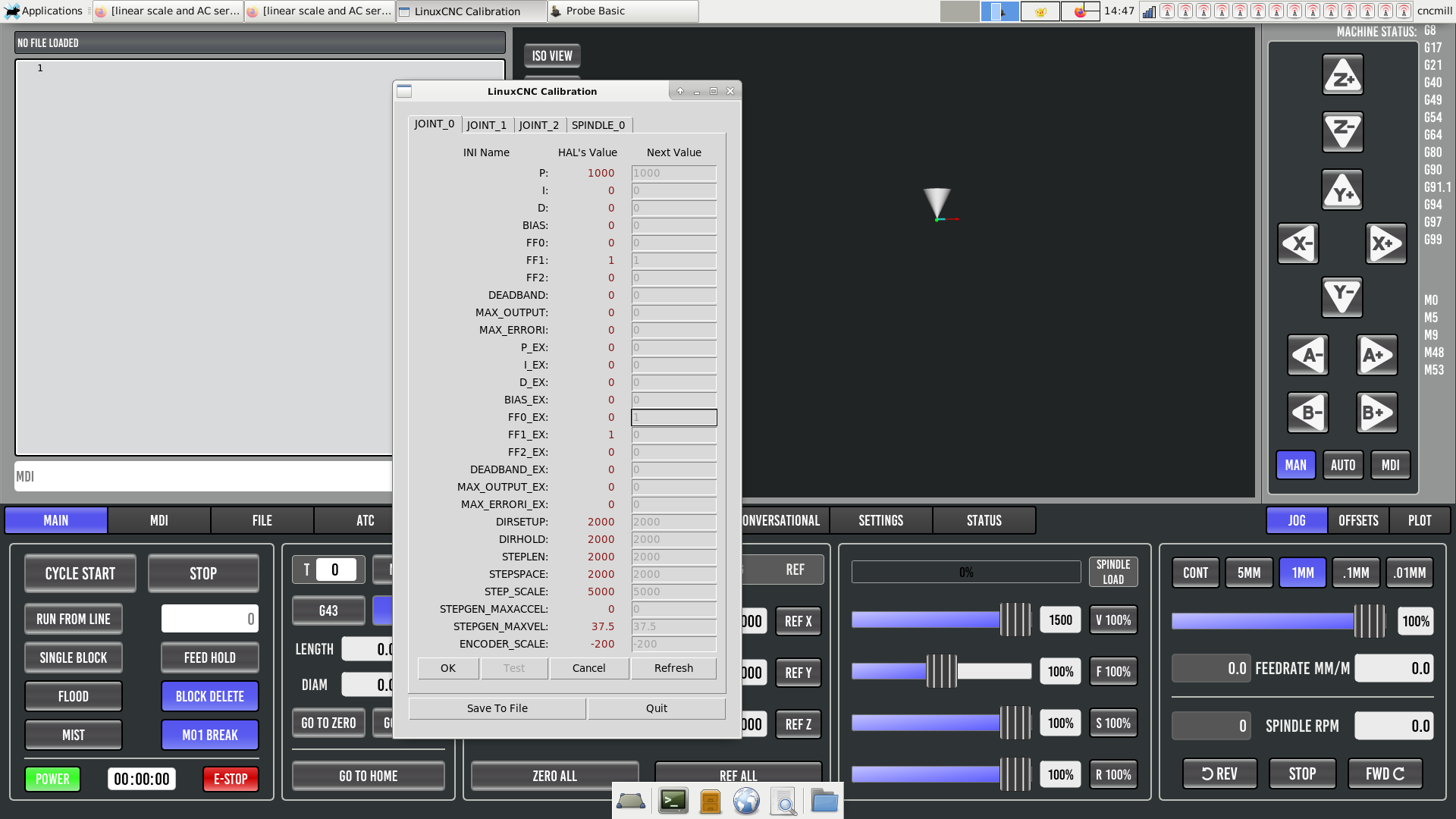

09 Oct 2022 16:16 #253813
by chienMouille
I tried now to clean up and follow your sketch here precisely. But servo still doesn't move. Any idea?
That's how I've connected it:
Replied by chienMouille on topic linear scale and AC servo set up - sanity check
Im running in step/dir from a 7i95 mesa card, with the servo driver set in position mode.
Yes, but you have the stepgen running in vocity mode, so the PID needs to output a velocity.
Now, what you could do (and it would be an interesting experiment) would be to run the normal Mesa-style velocity PID to close the stepgen position loop, and then add an outer loop like I described with the linear scale as feedback.
Parport setup:[/code][/code]joint.N.motor-pos.cmd -> stepgen.N.position-cmd stepgen.N.pos-fb -> joint.N.motor-pos-fb Common Mesa config, using external velocity PID: [code]joint.N.motor-pos.cmd -> pid.N.command pid.N.output - > stepgen.N.velocity-cmd stepgen.N.position-fb -> pid.N.feedback -> joint.N.pos-fb Alternative with scales: [code]joint.N.motor-pos-cmd -> pid.M.command pid.M.output -> pid.N.command pid.N.output - > stepgen.N.velocity-cmd stepgen.N.position-fb -> pid.N.feedback scale.M.position -> pid.M.feedback -> joint.N.motor-pos-fb

- Thank you received: 4654
10 Oct 2022 11:51 #253867
Replied by andypugh on topic linear scale and AC servo set up - sanity check
Sorry to abandon you, I had a bit of a busy weekend.
The first thing that I notice is that I don't think that the pid.x_external PID component is being enabled.
Both PIDs can share the x-enable signal.
change
to
Does the linear scale have index marks? Those would be the best way to home, if they do. Otherwise you might want to remove the x-ex-index-enable net.
change
net x-ex-index-enable <=> pid.x_external.index-enable
net x-ex-enable => pid.x_external.enable
net x-pos-fb => pid.x.feedback
net x-ex-pos-fb => pid.x_external.feedbackto
net x-enable => pid.x_external.enable
net x-ex-pos-fb => pid.x_external.feedbackDoes the linear scale have index marks? Those would be the best way to home, if they do. Otherwise you might want to remove the x-ex-index-enable net.
