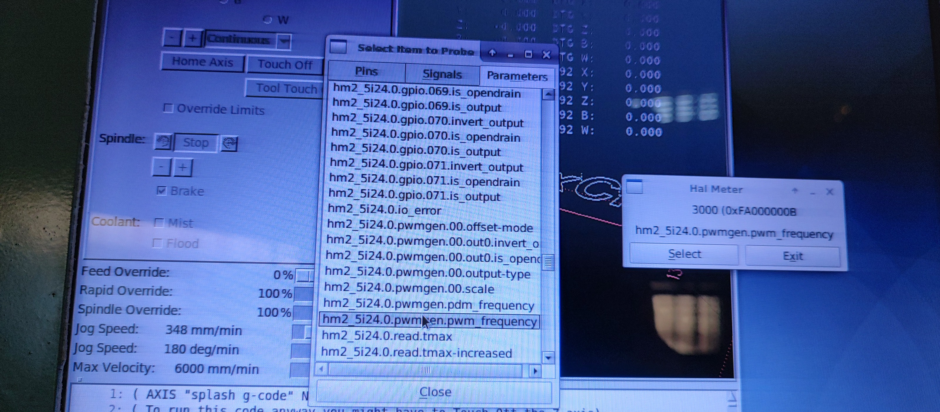

So it is probably hm2_5i24.0.pwm_frequency. But as I said, have a look at the pins of the running config to find out.
The following user(s) said Thank You: yrsiddhapura
- yrsiddhapura
- Posts: 134
- Thank you received: 5
17 Dec 2022 17:13 - 17 Dec 2022 17:36 #259742
by yrsiddhapura
Replied by yrsiddhapura on topic How to configure Horizontal Boring mill
i tried to set
setp hm2_5i24.0.pwmgen.pwm_frequency 20000
to
setp hm2_5i24.0.pwmgen.pwm_frequency 3000 and even 2000 but its still same i am getting 60khz frequency and very minor changes in duty cycle as mine multi meter says(i dont have access to oscilloscope right now) i have checked PWM value and is 1100(mine required RPM) and Output rps is 18.36 (about 1100 RPM) but frequency cycle is above 60khz. And "halcmd show pin *pwm_frequency" shows nothing.
As following readhmid PIN 23 is PWMgen and as following 7i52s manual Pin 23 is TX5B and as following it i have connected PWM connection to P2 PIN No 21 of 7i52s and GND to P2 PIN No 17 of 7i52s for mine PWM to Voltage converter(Chines Generic module).does mine connections are wrong or i am missing any thing ?I am attaching mine HAL and INI files and readhmid output file.
to

47 71 IOPort NoneAs following readhmid PIN 23 is PWMgen and as following 7i52s manual Pin 23 is TX5B and as following it i have connected PWM connection to P2 PIN No 21 of 7i52s and GND to P2 PIN No 17 of 7i52s for mine PWM to Voltage converter(Chines Generic module).does mine connections are wrong or i am missing any thing ?I am attaching mine HAL and INI files and readhmid output file.

Maybe it is using PDM mode? (though from this line in the HAL I would expect 6 MHz)
Add
linuxcnc.org/docs/stable/html/man/man9/hostmot2.9.html#pwmgen
Replied by andypugh on topic How to configure Horizontal Boring mill
...setp hm2_5i24.0.pwmgen.pwm_frequency 20000 setp hm2_5i24.0.pwmgen.pdm_frequency 6000000
Add
setp hm2_5i24.0.pwmgen.output-type 1linuxcnc.org/docs/stable/html/man/man9/hostmot2.9.html#pwmgen

17 Dec 2022 18:53 #259755
by yrsiddhapura
I think it's type-1 is pwm according to manual
output-type
This emulates the output_type load-time argument to the software pwmgen component. This parameter may be changed at runtime, but most of the time you probably want to set it at startup and then leave it alone. Accepted values are 1 (PWM on Out0 and Direction on Out1), 2 (Up on Out0 and Down on Out1), 3 (PDM mode, PDM on Out0 and Dir on Out1), and 4 (Direction on Out0 and PWM on Out1, "for locked antiphase").
As novice i am not sure which type is suitable for me could you pls suggest ?
output-type
- Thank you received: 4654
17 Dec 2022 19:41 #259763
Yes, you want type 1.
Also try just deleting the PDM frequency line.
- yrsiddhapura
- Posts: 134
18 Dec 2022 06:16 #259799
by yrsiddhapura
No changes after deleting pdm line still not able to get 2khz pwm afters settings pwm_frequancy to 2000 it's still got about. But according to mine volt meter it change voltages 0-5v so it is safe to use it as analogue my drive supports both 10v and 5v analogue input or i should connect/TX5B => pwm in and TX5B => GND , currently i have connected TX5B => pwm in and GND to GND of 7i52s
18 Dec 2022 10:09 #259810
The multimeter is averaging the PWM. The drive _might_ accept the 60kHz, but really you should set the PWM frequency to what the manual says.
With LinuxCNC running, what is the value shown on the pwm_frequency pin? (Use halmeter or "show hal configuration" from the "machine" menu to check this.
How are you measuring the PWM frequency and duty cycle? Maybe the measurement is wrong?

18 Dec 2022 18:25 #259842
by yrsiddhapura
Hal meter shows value of pwm_value 1100 @ 18.35 rps(1100 rpm) spindle out and to measure pwm frequency and duty i am using mine kaiweets ht118a which supports 10mhz frequency and duty cycle. Well yes I am also believe measurements are wrong so try to get access to ocilloscope
19 Dec 2022 23:21 #259909
I asked about the pwm_frequency pin, to see if it really was being set to the right value (and not being set to another value elsewhere in the HAL files)
