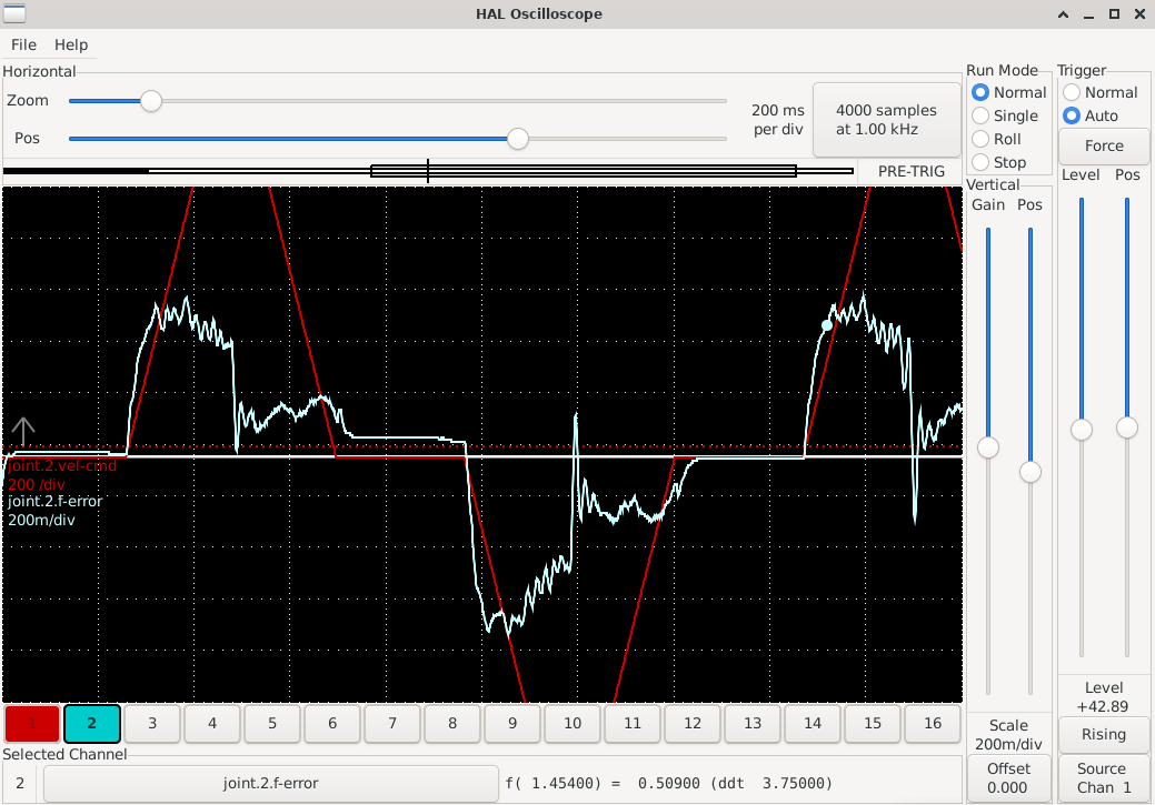

Adding some "D" made a huge difference.
I also confirmed that, at least in my config, rotary axis values are in degrees per minute, not seconds. Needed to bump all the values way up before the C-axis performed properly.
So the basic scheme is:
Latest halscope below during a G0 C0, G0 C360 tuning program.

Current (working) PID values:
MAX_VEL = 2880
MAX_ACCELERATION = 15000
P = 85
I = 50
D = 2
FF0 = 0
FF1 = 0.144
FF2 = 0.00665
FF3 = 0.000015
maxoutput = 500
deadband = 0.01
MIN_FERROR = 500
FERROR = 500
MAX_VEL = 2880
P = 85
I = 50
D = 2
FF0 = 0
FF1 = 0.144
FF2 = 0.00665
FF3 = 0.000015
maxoutput = 500
deadband = 0.01
MIN_FERROR = 500
FERROR = 500

After a few days of creating a stupidly complicated M-code switched spindle-orient-axis scheme, I've come to the conclusion that Andy's caxis.comp simply works better than anything I can come up with. I'll live with the automatic return-to-position behavior.
So... back to the remaining issues with caxis.comp:
Thanks in advance for any suggestions.
- Acceleration
- I don't really understand the acceleration settings, and that's probably hindering my ability to tune the setup.
- Here are the cases
- Homing
- G0 axis moves
- M3/M4 spindle ramp up/down
- M5 return to position caused by caxis.comp
- Part 1: initial re-position gets really close
- Part 2: pid.c takes over to get it exactly in position
- I've got the following pins/parameters/values
- INI - [TRAJ] MAX_ANGULAR_VEL (7200)
- INI - [TRAJ] MAX_ANGULAR_ACCEL (30000)
- INI - joint/axis MAX_VEL (2880)
- INI - joint/axis MAX_ACCEL (15000)
- INI - spindle MAX_ACCEL_RPM/RPS (300/50)
- caxis.0.spindle-maxaccel (parameter in caxis.comp)
- if low (~50) - M3/M4 ramp up/down is really lazy, as well as the initial return-to-position
- if high (~2000), M3/M4 ramp up/down is brisk but not 'banging'
- What's got me confused is that the return-to-position accel & speed are not the same as a G0 move.
- G0 moves are much 'softer' than the return-to-position or initial homing.
- Is this because the commanded vs position error is much greater during 'Part 2' of the return-to-position move than with a G0/G1 axis move?
- Fundamentally... I can't seem to get the same accel/speed for all cases.
- Tuning
- It's not settling down in axis mode. Once the spindle is turned off and it returns to last c-axis position, pid.c seems to continually hunt back and forth around the commanded position.
- Not fast, not vibrating... but creeping back and forth +/- 5 or so encoder counts (40k/ppr encoder).
- I've upped the pid deadband a bit but that doesn't seem to settle it down.
- I can't get the following error down to what I think an axis (at least this one) is capable of. It's probably good enough for my use-case, but I'd really like some help... or at least someone smarter than me to say "it's not getting any better"
- Do I need to up the gains in the drive and then re-tweak the LCNC PID?
- Axis/Spindle disable
- As I've mentioned this is a servo spindle, so I can't manually rotate the spindle without disabling the drive. Once I disable and rotate the spindle the c-axis f-error goes banannas and errors out when I re-enable the spindle.
- The only thing I can think of (right now) is to have the amp-enable de-asserted signal unhome the c-axis, and force a re-home on amp-enable.
- I can't imagine a situation where I'd want to manually rotate the spindle in the middle of a program.
- Multiple instances
- I'd really like a second caxis.comp instance for my subspindle. I'll repeat my earlier plea for help: how is a comp written (more specifically edited) to permit multiple instances?
- If it a hard no-go, I'll fall back on spindle orient.
