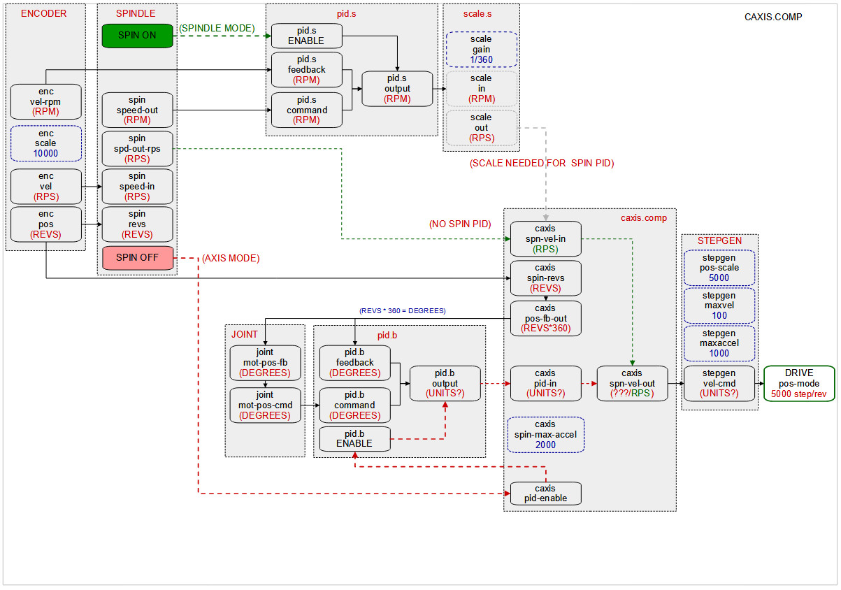

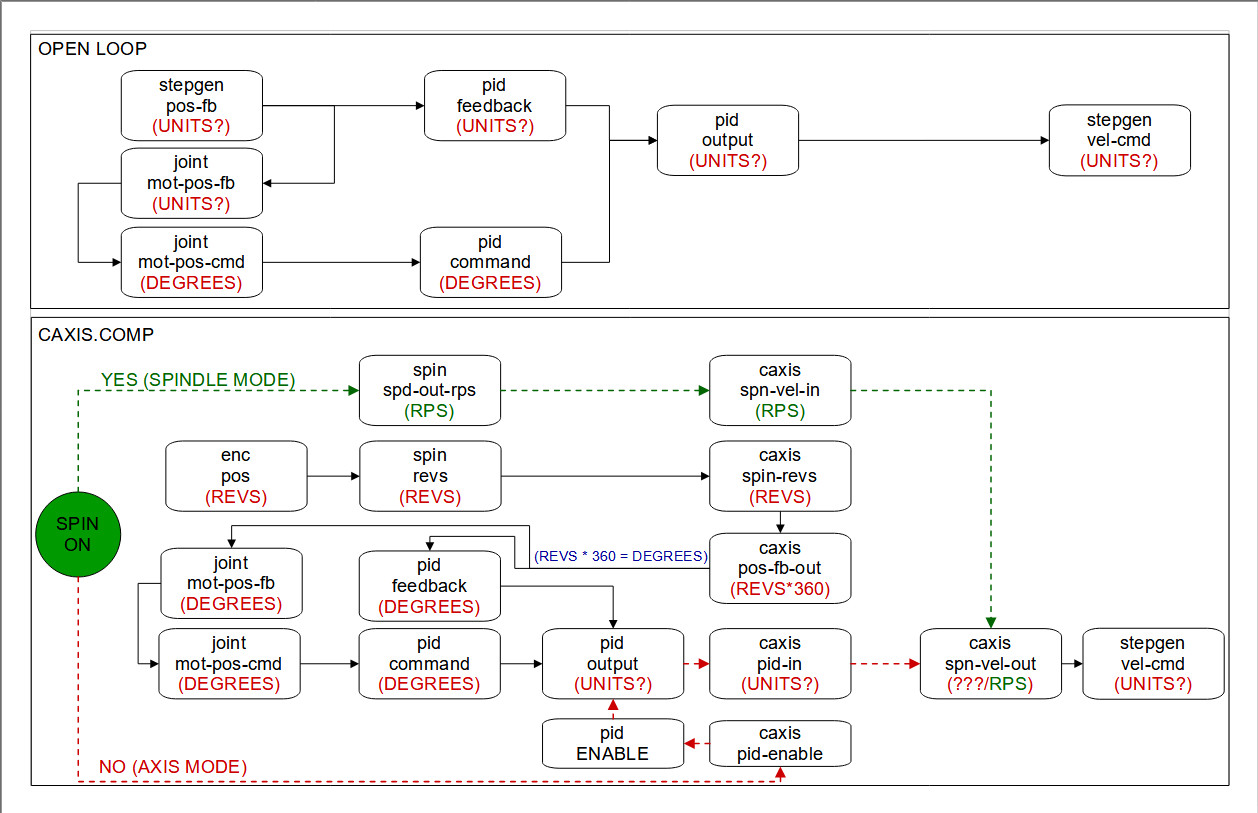

On the graph I would not link joint-mot-pos-fb with joint-mot-pos-com, but in the hal i do not see such connection.
- spumco
- Posts: 2180
- Thank you received: 905
31 Jan 2024 13:50 - 31 Jan 2024 13:52 #292066
by spumco
The chart shows them linked, but they aren't actually linked with a signal in HAL. The chart is a representation or approximation of the internal LCNC logic and is intended to help me identify if I've made an improper connection or scaling mistake.
Given this:
joint.N.motor-pos-cmd OUT FLOAT
The commanded position for this joint.
joint.N.motor-pos-fb IN FLOAT
The actual position for this joint.
My brain thought it reasonable to connect the two, at least in spirit.
I've just reviewed Nojo's config for about the thousandth time and checked his connections & pin/parameter values against mine. The only value with a significant difference is caxis.0.spindle-maxaccel... but that only controls the spindle accel/decel when transitioning between spindle mode and caxis mode. That should have zero effect when axis commands are being executed.
I guess my next step is to go back to an open-loop axis-only config, but with the [AXIS] TYPE=ANGULAR issue (now) resolved. Assuming that works, I'll then see if I can get caxis.comp working open-loop.
