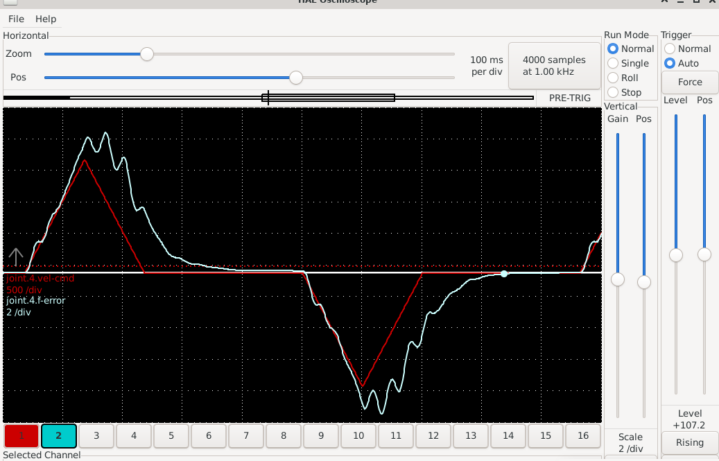

Ok, back on track with caxis.comp.  Still struggling, but the speed clamping issue is gone (thanks again Phil).
Spindle commands work fine.
PID tuning is, as usual, driving me nuts.
Right now I've got the values as such:
P = 0.23
I = 0
D = 0.01
FF0 = 0
FF1 = 0.00125
FF2 = 0.00002
FF3 = 0
maxoutput = 0
deadband = 0.1
stepgen max_vel = 100
stepgen max_accel = 2000
[AXIS] / [JOINT] max_vel = 3600
[AXIS] / [JOINT] max_accel = 3600
[DISPLAY] max_angular_vel = 3600
[TRAJ] max_angular_vel = 7200

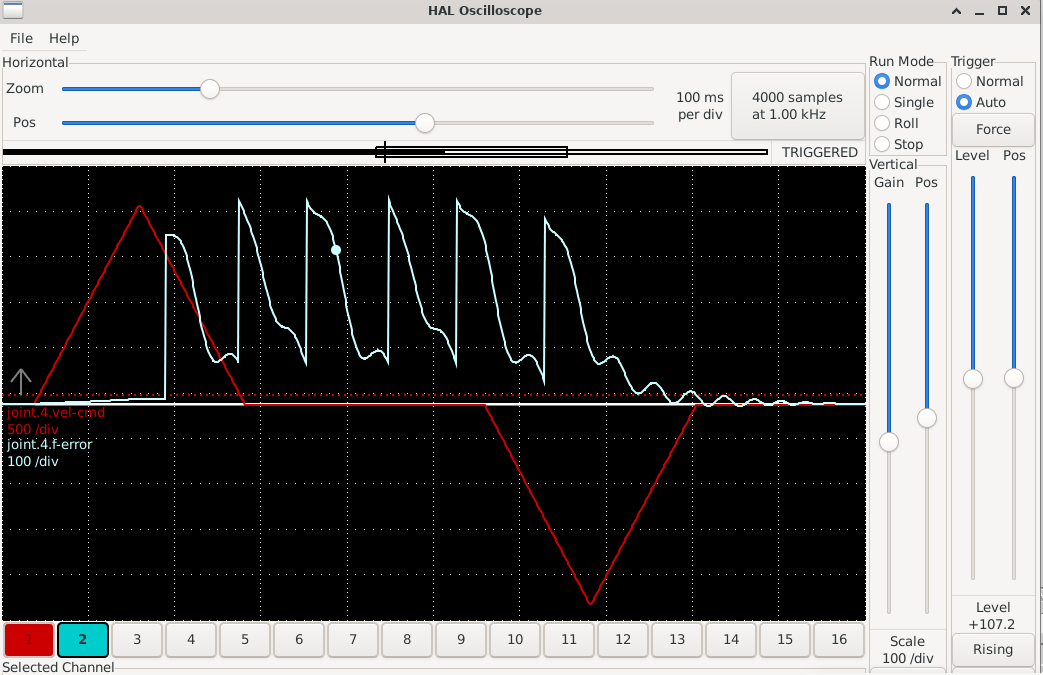

If the deadband is set lower, it behaves oddly.  A B90 or B179 command works fine and settles quickly.  But a B180 or greater result in the axis reaching position and then after a brief pause it keeps going all the way around and pausing again at B180.  No faulting, but it'll keep repeating that until I stop it.  Strange.
The FF1 value is suggesting (to me) that something is still wrong with various scaling or values.
Haven't really be able to get the f-error better than below without it going unstable.
30 Jan 2024 03:56 #291954 by spumco
Replied by spumco on topic caxis.comp - problems
Minor addendum...
Any I-term results in unstable, wild moves.  Increasing P or D results in huge f-error increase.
With deadband = 0.1, it'll stay put at B180.  But B270 results in the pause-and-keep-going routine.
If I set deadband to 0.09, it'll sit there for a minute or two and do a single flip.  Then do it again a minute later.
A back and forth program B0-B180 seems to work fine with the above PID values, but B0-B270 causes this:
30 Jan 2024 04:28 #291955 by smc.collins
Replied by smc.collins on topic caxis.comp - problems
does your drive have a deadband ? can you see if the encoder is giving you a bit twitch in hal show ? what the count value see what it's doing when this occurs. I have seen some issues with twitch. I am still working on a different way to control the c axis, but it's going to take a while.
30 Jan 2024 04:46 #291956 by spumco
Encoder counts are stable with no input command.
Encoder is 2500ppr, so 10k post-quad.  That's 27.11 counts per degree.
If pid deadband is degrees (not sure about that), then 0.1 degree should be ~2 counts.
I'll bump it up to 0.2, but that still doesn't explain why it doesn't try to servo back or just dither a bit instead of freaking out and whipping around another rev.

Can you see the position cmd and position actual in degreees ??? See if anything odf there. Set a hal scope trugger for the index pulse, see if it's got noisy signal ? If index was triggered i could see it dumping the known position and rolling over unexpectedly
30 Jan 2024 14:49 #291983 by spumco
@Tommy,
Re-reading the PID manual, deadband should be set slightly greater than 1/2 count to stop hunting.  Your example is (I suspect) referencing a linear axis where you've got a very high count-per-unit (like thousands of counts per mm or inch).  Just like my X/Z axes with 1um encoders where I've got ~25400 counts/inch.
My subspindle is a direct-drive rotary axis where units = degrees.  So I've got ~27 counts per degree; significantly coarser feedback per unit.
The encoder signal is output from the drive, and I've got it set as high a resolution as possible.
@Aciera,
I tried the PID autotune a couple times on my Z-axis a while ago and the results were just dumb.  While I may give it a try, I haven't read a single report on the forum where someone was pleased with the results.
@smc.collins,
I have the pos-cmd and pos-fb up in halshow, but haven't yet scoped them.  Nothing odd or way off during a programmed back-and-forth move.  It homes to index fine and the counts/position/velocity all look like they should even when it flips out.  Doesn't lose track of where it is.
I'm going to try connecting it like an open-loop stepper tonight - connect stepgen pos-fb to pid.b.feedback and joint motor-pos-fb.  That should help me see if my issue is with the PID or not.
