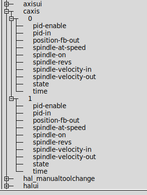

Have to force a switch to manual mode first, but even if I get it unhomed the c-axis PID still generates a following error while rotating the spindle by hand. One it hits the ferror limit it trips the machine off even if the drive is disabled.
Really need some way of editing the comp so that the feedback-fandango it's doing to reduce the ferror can be applied while the amp is disabled.

What I need is a way to change this:
switch state{
case 0: // C-axis mode
if (spindle_on){
state = 1;
pid_enable = 1;
spindle_velocity_out = pid_in;
// detect index-reset
if (fabs(position_fb_out - (spindle_revs - offset) * 360) > 180){
offset = round(spindle_revs);
position_fb_out = (spindle_revs - offset) * 360;
break;
To something like this:
case X: // amp-disable mode
if (amp-disable){
state = N;
pid_enable = 0?
spindle_velocity_out = 0
position_fb_out = spindle_revs (maybe?)
break;
Or something like that. Some way to let pid.c know that the current position is the commanded position.

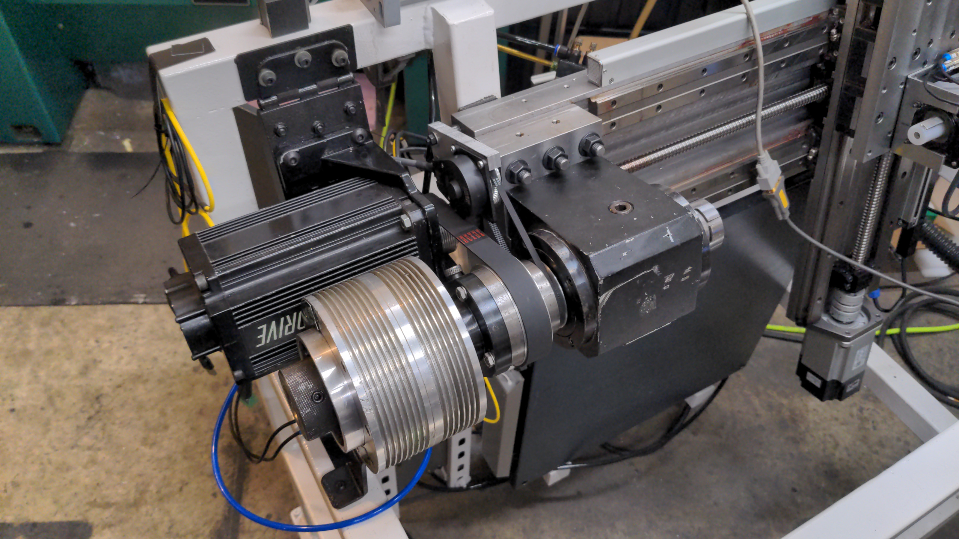

One drive, one motor.
~1.44:1 poly-v belt drive (didn't want to listen to a timing belt screaming)
Separate 1:1 GT2 belt driven spindle-mounted encoder
Based on a Dunham 5C spindle, so it's really low inertia and can accel/decel on a dime.
Air collet closer limits me to about 3kRPM at the spindle, but if this works out I can get one good for 4500rpm continuous.
Subspindle will be similar, only step-dir (instead of PWM-velocity), and with a 1kw servo instead of the ~2-3kw main spindle motor.

And because it outputs to two different pid's, it'll control two different amps as it's written now.
I think it just needs some additional features and/or pins to cover various hardware configs and situations.
OUT - caxis.N.mode-is-axis
OUT - caxis.N.mode-is-spindle
IN - caxis.N.spindle-ready
IN - caxis.N.axis-amp-enabled
IN - caxis.N.spindle-amp-enabled
The out pins could be used to turn off/on other components (so you can't jog the axis and change the FB position while in spindle mode). The in pins could be used to adjust the component state, or delay the spindle output if a separate axis motor needed to be engaged (clutch, air driven swing gears, etc.).
