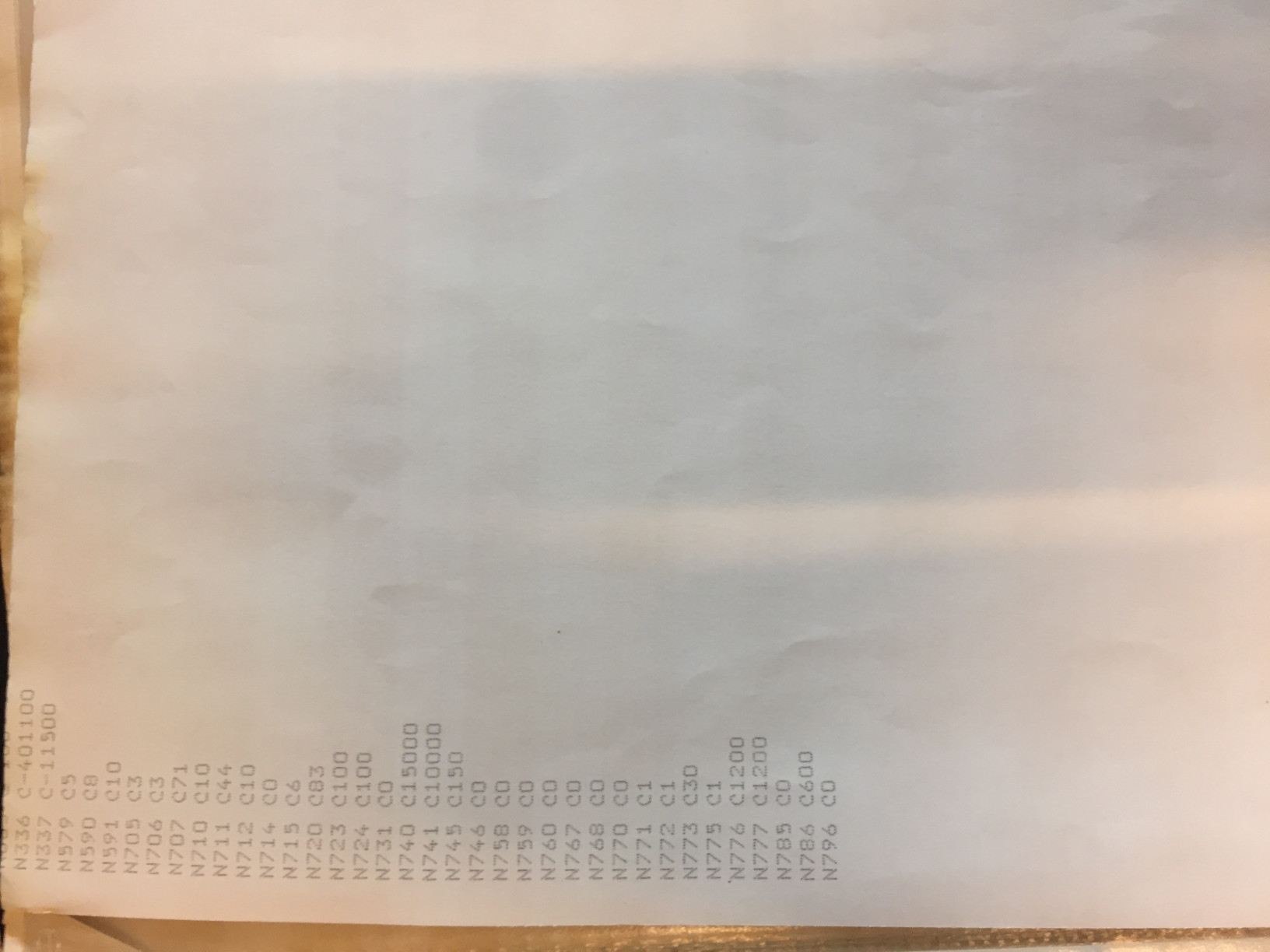

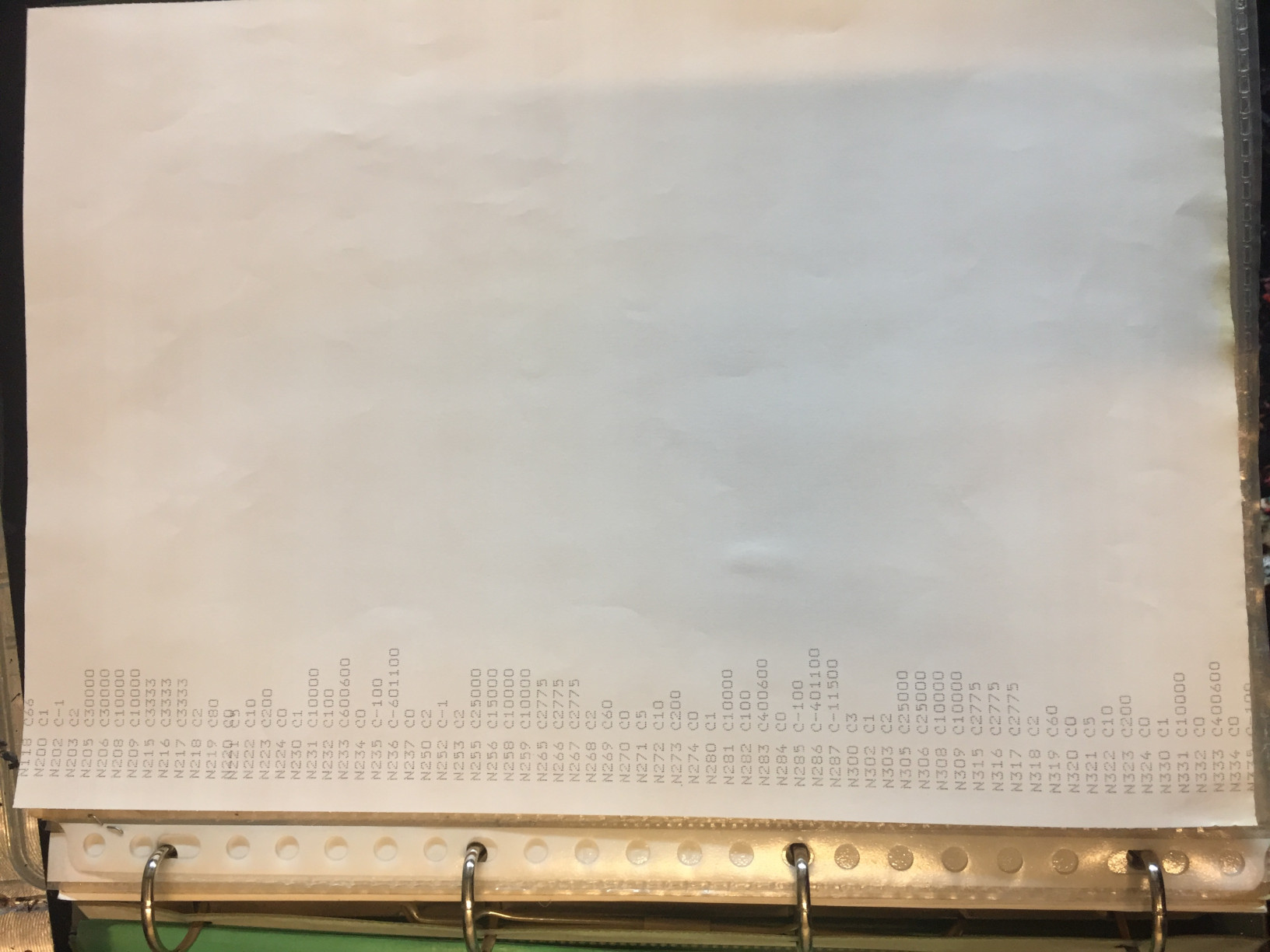

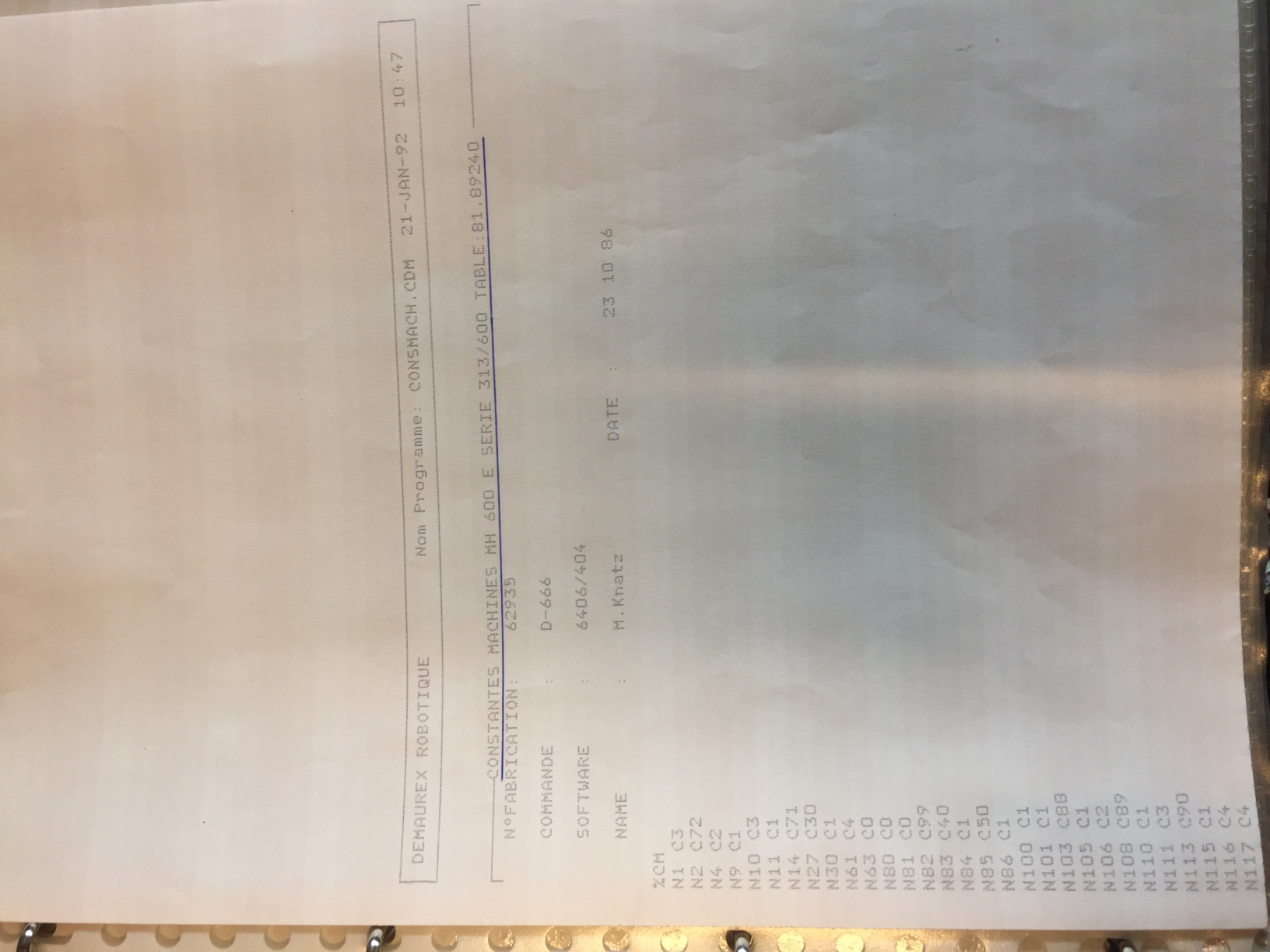

If anybody can check from their computer whether their website is available, it's heidenhain.com. Then you have to click on documentation, then mauals and finally O.M.A. controls. I don't know why it won't work for me, it used to in the past.
I'm attaching a picture of my old machine constants printout which has the software version of the controller listed at the start. Checking these against the manual is my best idea for getting a glimpse into what the engineers that made these machines thought about tuning servo drives.

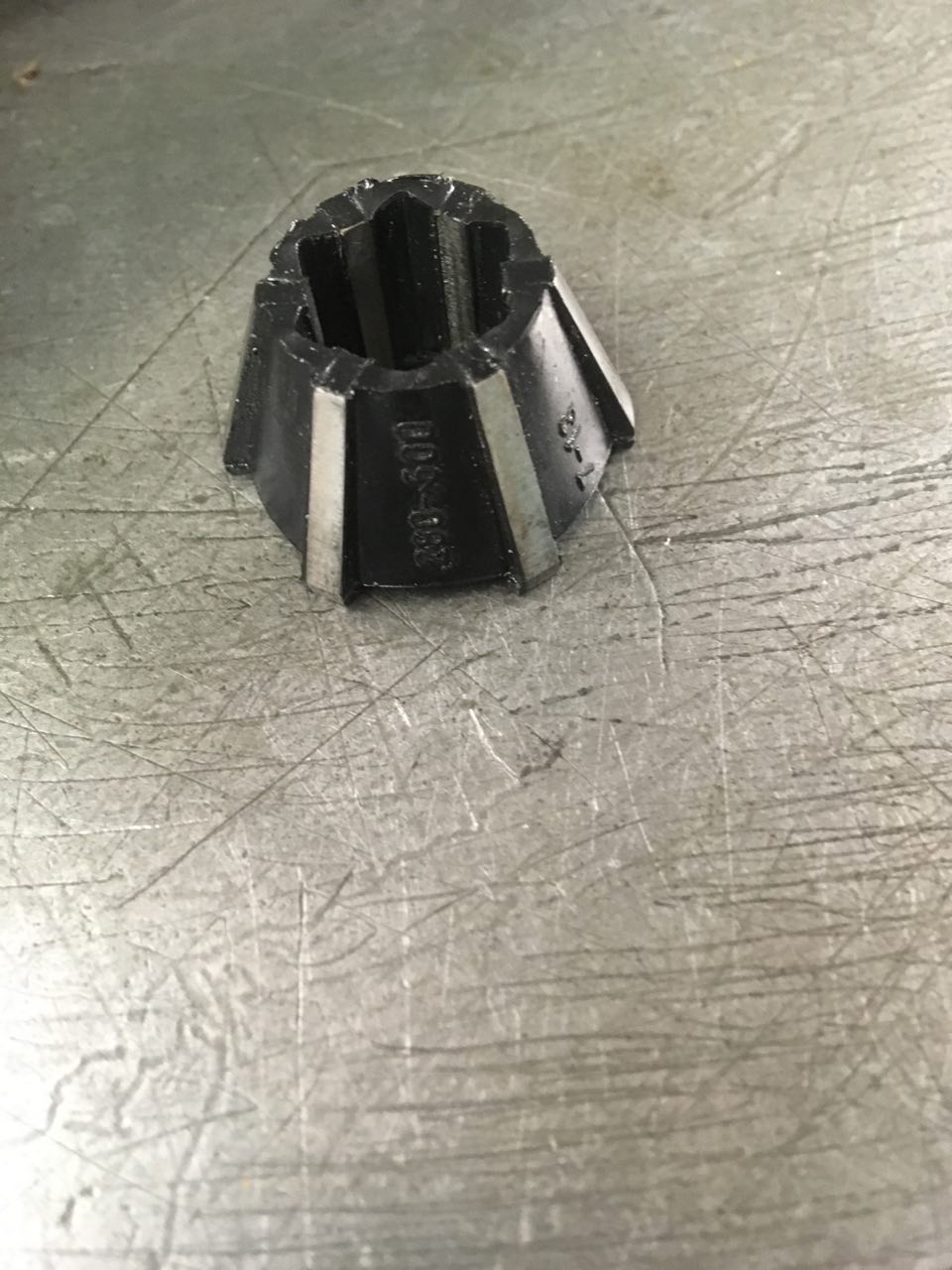

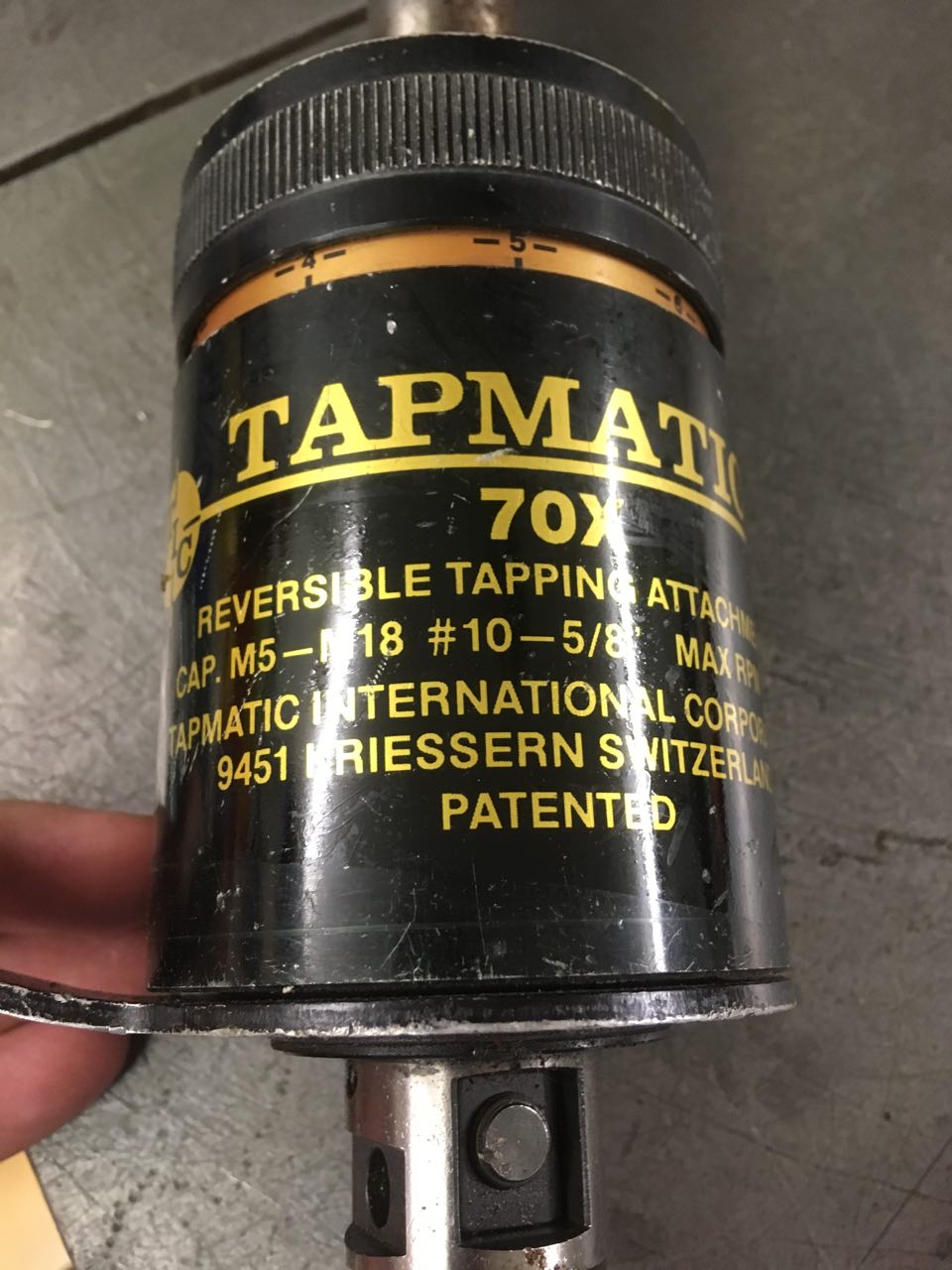

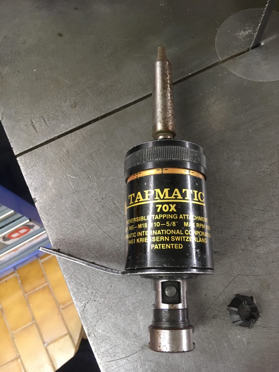

A tapmatic 70X came up locally for only €99, so I took a chance on it sight unseen
When it arrived I was pleasantly surprised that it had a J441 collet in it.
This is a Swiss made one, with a B18 taper in it. I'll need to buy or make a BT40 - B18 shank, and the wedges for pulling the #3 morse shank currently fitted. It seems to work in that it drives forward with axial load on the output, and then reverses to a higher RPM when you pull on it. I have nothing with a MT3 taper to test it, as the Boleys tailstock is MT#2.
Mark
Mark
