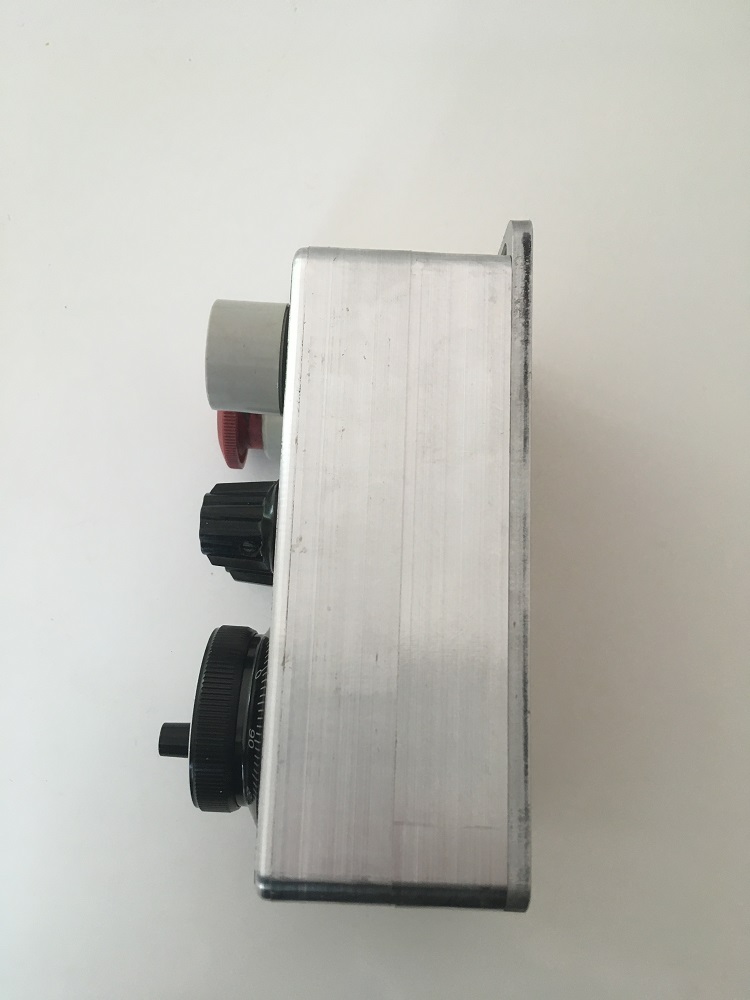

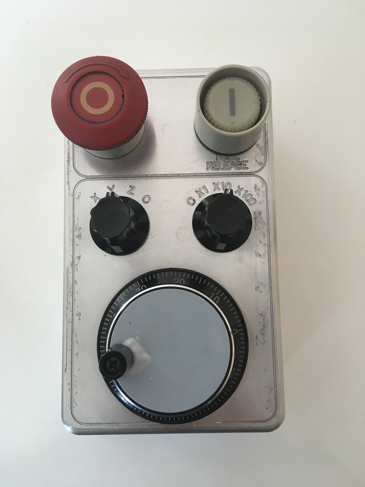

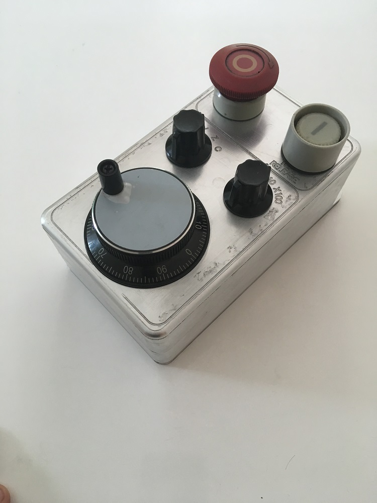

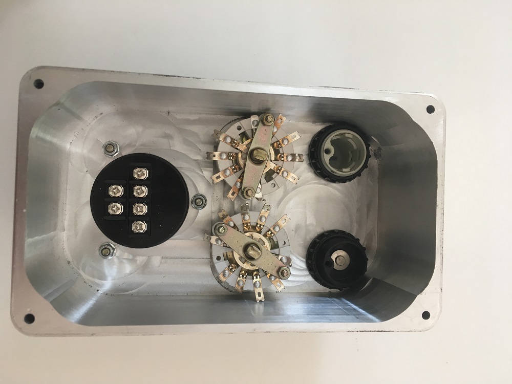

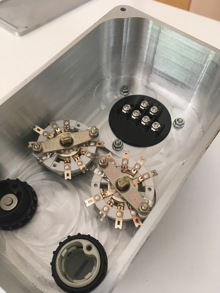

Good point that my sluggish tuning is probably bad for cutter life. My presence is generally bad for cutter life :)
I can help you with your feeds and speeds for the new endmill, but first please check it for manufacturer and catalog number, or tell me whether the endmill is HSS (probably not), HSS-Co (cheaper) or HSS-PM (more expensive, superior performance). Also check for coating. These things make for a world of difference in setting the correct feeds and speeds.
EDIT: the tool info is usually there in some form on the cutter itself, you don't need the original box.
Too late, I already milled it out. Worked fine at 240 mm/min. The cutter is a Chinese end mill from CTCtools.biz. No info on the type of HSS (Assume no Co),no coating and no recommended cutting parameters. At €6 pop, you can see why I am pretty relaxed about killing them. I figured I'm better off using cheap cutters, until I get enough feel for the machine to stop doing the really stupid beginner mistakes (I killed two carbides - one be jogging it into steel, the second by letting it bounce lightly on work during tool release.

Oh yeah! Now get a backplate, wire this bad boy up and feel the freedom :)
Normally, German HSS cutters of this diameter are in the 20-35€ range, now I get your easy come easy go attitude about all this. You can sometimes buy tool lots at good prices from places like surplex, which I think would be a pretty good deal if you have a tool grinder.
With this pendant design I would recommend getting a Haimer/Mahr 3d taster for work offsets. You'll be able to stand close enough to the touchscreen to select axis and offset values since these devices have large dials. It saves you from having to see the material edge and distance, while the pendant still allows for precision control in small increments. The original pendant was similar in that regard (but with Linux it's not necessary to memorize values before entering them to the offset table; big win in my book, standard feature on all modern controllers).
