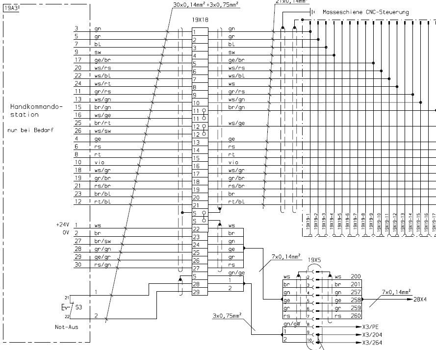

Since you still have the Maho pendant attached, why not just connect a pendant physical key to a mesa pin through to the hydraulic pump pin output.

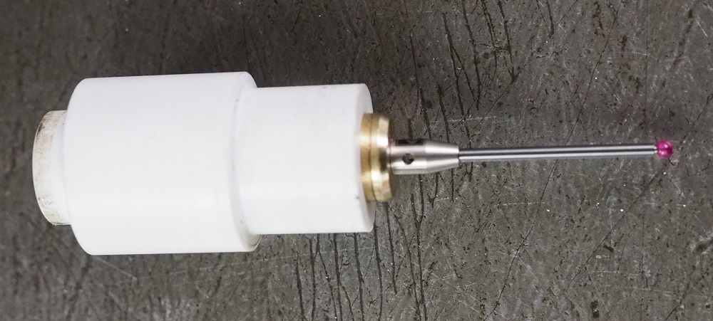

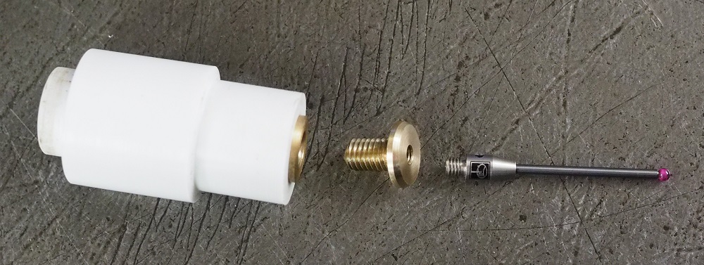

Wait, you're building a probe?
That's pretty ambitious I think and will be a fanstastic help when you manage to set it up with the correct macros.

- RotarySMP
- Posts: 1524
- Thank you received: 562
21 May 2019 17:11 #134503
by RotarySMP
I hope it works. I can't afford/justify a Renishaw or Haimer, and there are few guys on the internet who have made 3D touch probes, and if you put in some adjustment screws, it seems like +/-0.01mm should be doable.

Meanwhile, in Homer Simpson land, I have no idea how to check which wires from either the control panel or the pendant are attached to the tool release key. It looks like a completely different philosophy of wiring (that multiplex thing?).
Is there any easy way for me to get the tool release working without a separate physical button to get some sort of input signal that would connect with the tool change relay?

21 May 2019 17:51 - 21 May 2019 18:29 #134512
by RotarySMP
How about this work around? Use the "Mist" coolant virtual button, as your tool release button.
net toolrelease halui.flood.on [hm2....mesa pin address]
edit: that is not a momentary pin, so you would also need to finish the tool change by hitting the coolant off button. Not a problem, but be very sure not to have an M7 in a gcode program.
edit 2: The more elegant but time consuming method would be a glade VCP.
www.linuxcnc.org/docs/html/gui/gladevcp.html
edit 3: I have no information on the MAHO pendant, but looking at the wiring diagram...
When you have time, pull 19x19, release E-Stop (the pendant is on that same bus which only powers up on E-stop release. The pendant should then be powered. Then try probing the pins of the 19x19 connector, while pushing each button, and see if you get lucky and the buttons have discrete wires.

21 May 2019 19:34 #134522
by Glemigobles
Replied by Glemigobles on topic Retrofitting a 1986 Maho MH400E
Thanks Mark, your solution with the mist coolant control worked.
I had to additionally connect the tool release signal with iocontrol.0.coolant-mist:
net toolrelease iocontrol.0.coolant-mist
and
net toolrelease hm2_5i25...
I tried using a button from a broken bicycle light but it didn't work. This solution will be a bit stressful since my kb has a touchpad which outputs clicks if you touch it (no need to press button).
