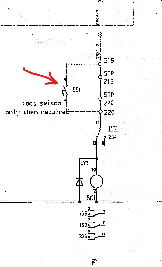

Hi to all, sorry to hear for the machine crash. You had set the machine with positive z travels, so you can actually measure and verify the work offsets with a simple caliper or rule. This makes sense but is prone to accidents.
The same debate exists for positive or negative tool offsets.

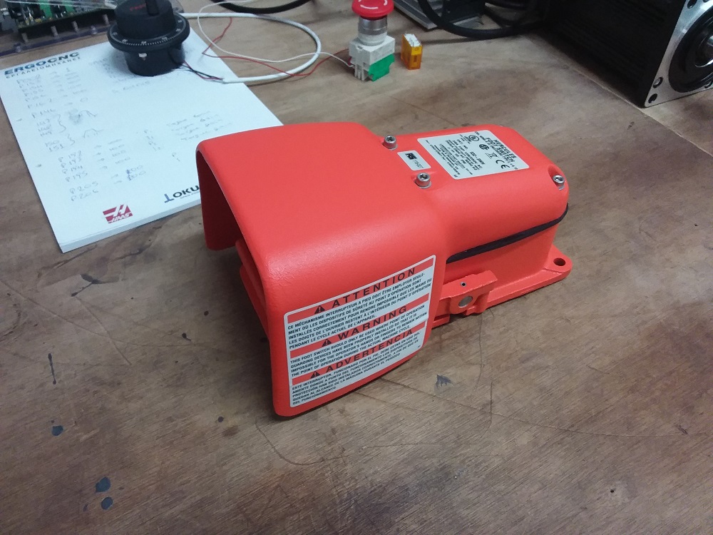

Hey John, I was actually thinking about a footswitch solution using a footswtich from my guitar amp. But after opening it I decided against the idea. I could go with a dedicated footswitch, purchased separately, because the Maho pendant I still have uses a system whereby you have to press two buttons with one hand to activate it, and simultaneaously use your other hand to press the button you want. That leaves you with precisely zero hands left for holding the released/inserted tool. I used to press the tool release button with my chin to get the system working
Since there are a lot of pins on the Mesa 7i73, I will consider adding a footswitch. I will also work on a GladeVCP panel that will interface LinuxCNC functions with the Philips control panel. But all that after I make all the outstanding parts on backorder since the beginning of May.
