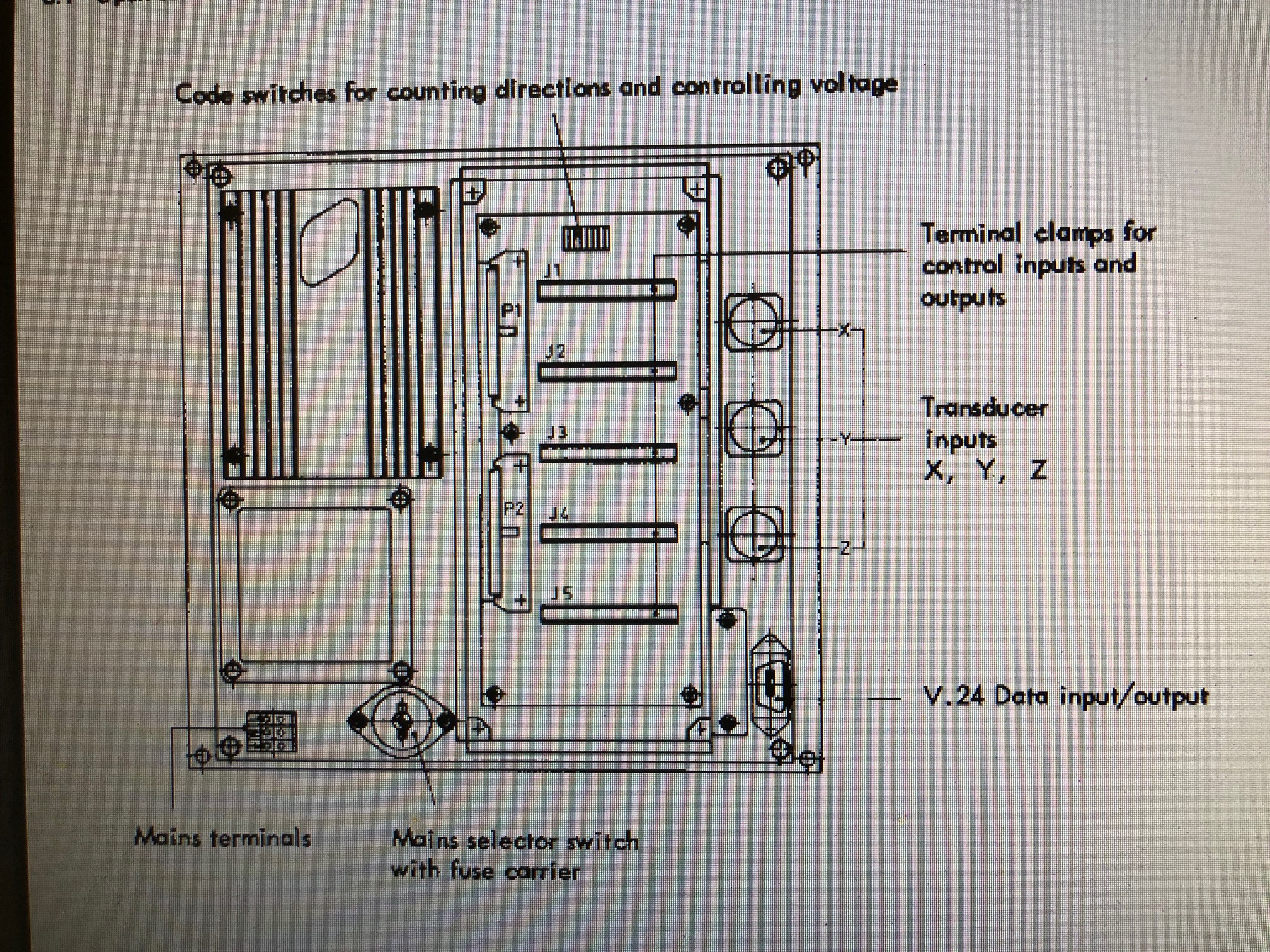

Hello,
After power on the TNC has to display "Stromunterbrechung".
we have to test a few things:
on your user control cabinet there is an cover on the down side, after you opened this, you have an view at the back of the
TNC.
-check the Input Voltage to the TNC, and if it is fitting to the switch position, (!never turn the switch, with machine powered up !)
if this is ok, first disconnect all the black connectors to prevent from an extern failure, power up again and look if something in the displays has changed. if yes go to the point "Checking Machine connections", if not:
disconnect the centronics connector to the Monitor, disconnect the three round axis scale connectors.
power up again. Something changed?
If not you have to deattach the haidenhain from the machine and open it.
check for loosen connetors, check if the eprom chips are fitting right in there sockets (maybe transport failure). Inside the TNC there is on Circuit Board for Power Supply, its an old school discrete circuit with transformer to get +- 15Volts and 2x 5Volts. An electronic guy who is not born in the tablet and smartphone area can check and repair this.
if the PSU is ok, there will be some other error inside the TNC, i have a few schematics from the boards, but not all. But this can become much time effort, even some of the ICs are not available anymore.
If somethings changed, and you get the Display "Stromunterbrechung". Step by step reconnect the axis scale connectors and the monitor connector to find the one which causes the failure. Then we can go further.

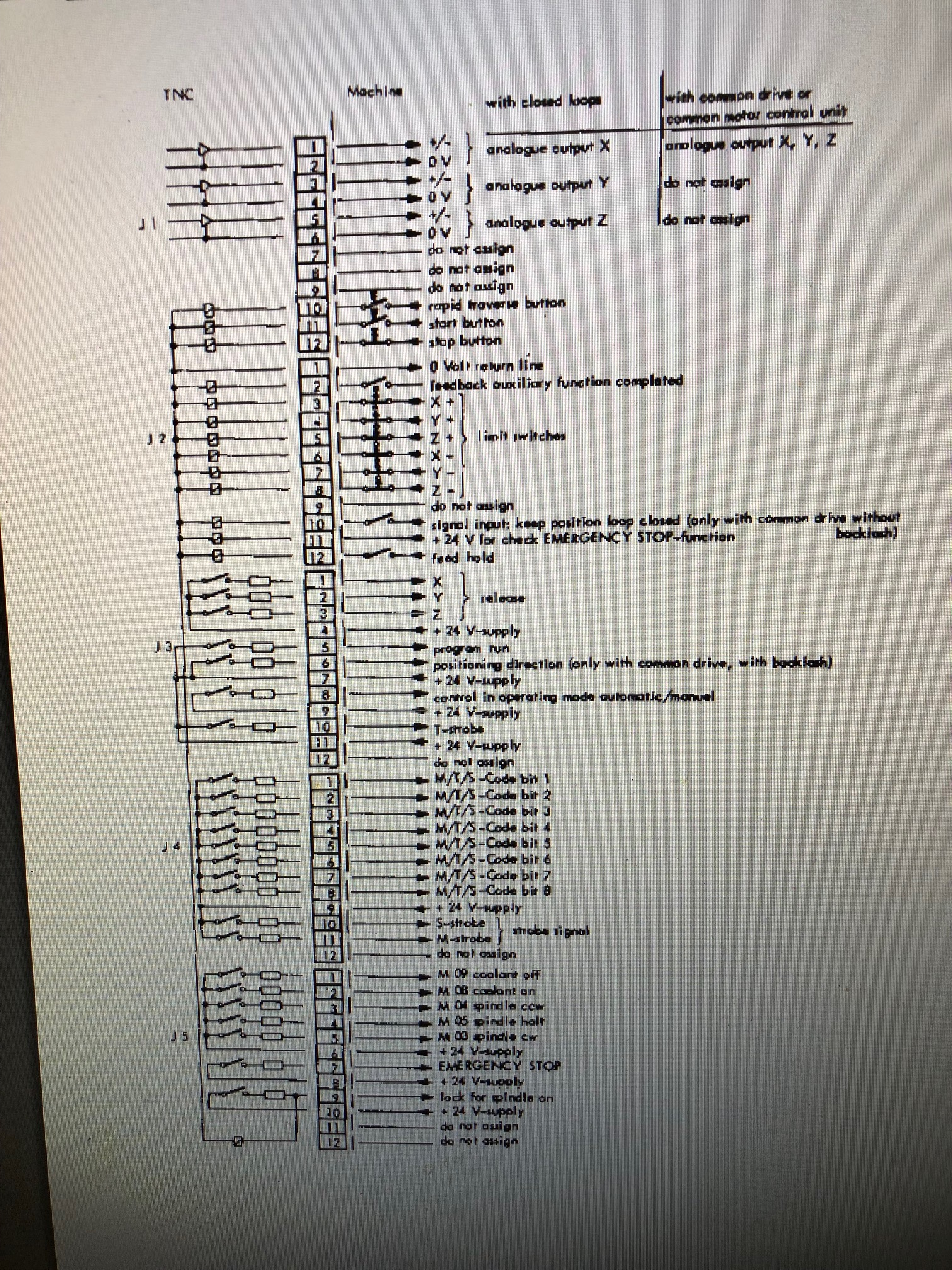

Checking machine connections
first check on every connector which has pins for 24V and 0V if there are present and not open circuit.
After this, Step by Step reconnect the connectors, to find the one which causes the fault, then we can check the wire from the connector.
My guess is, that the intern power supply from the TNC has gone faulty, maybe due to wrong inpult Voltages. What are the Mains Voltages in your country?

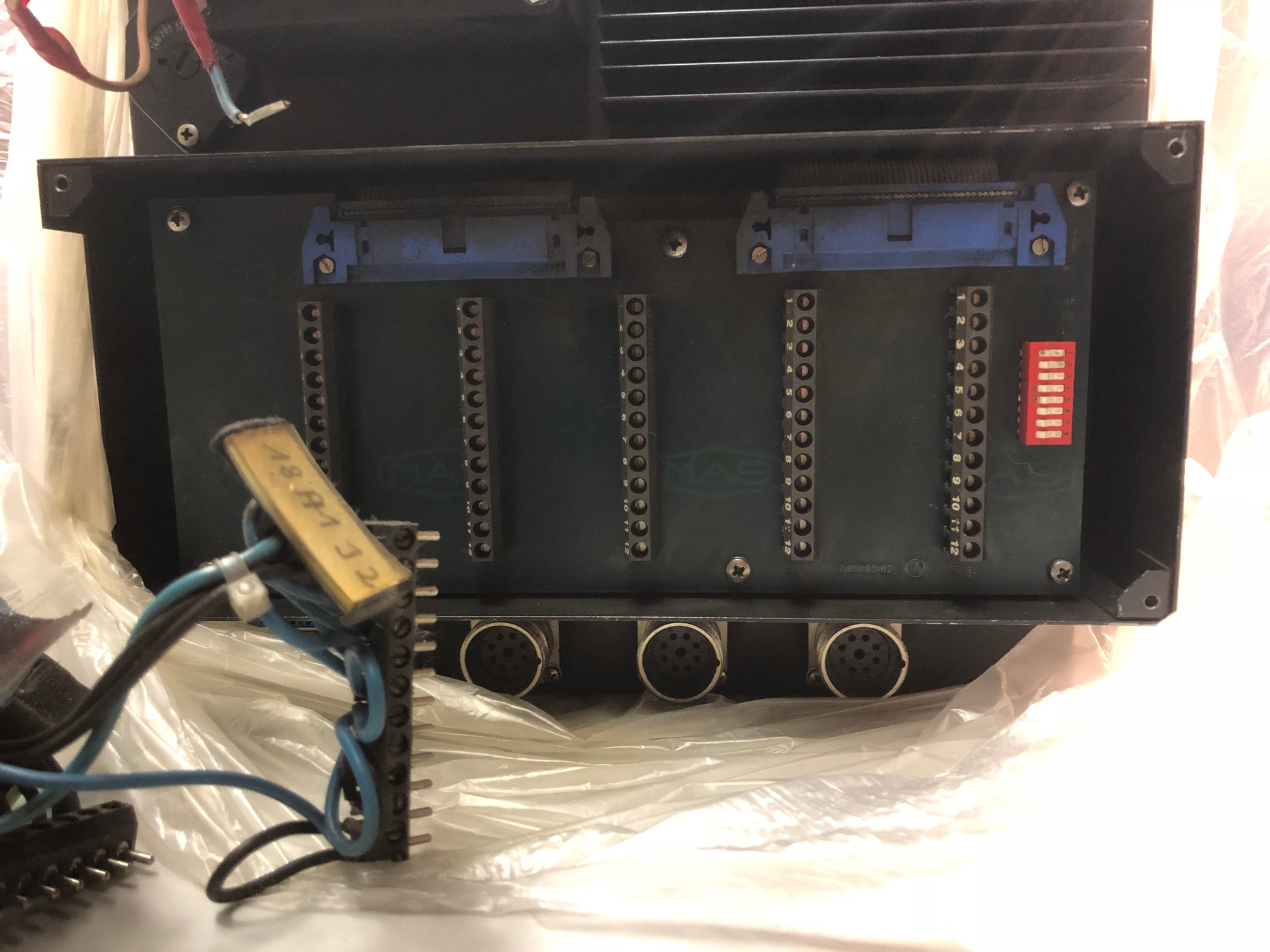

- BradMck
- Posts: 7
11 Nov 2019 18:36 #150145
by BradMck
Replied by BradMck on topic Retrofitting a 1986 Maho MH400E
Hi All,
I have already had the TNC to my electronics serviceman, He has replaced capacitors and found the 5V Rail was down to 4.75V, he has fitted an external 5V supply to the internal 5V Rail.
The TNC would not complete the startup sequence while it was being bench tested without the Maho Connected to it.
Brad
Brad
- db1981
- Posts: 790
- Thank you received: 275
11 Nov 2019 20:18 #150153
by db1981
Replied by db1981 on topic Retrofitting a 1986 Maho MH400E
Hi Brad,
this sounds like bad eproms to me, but chris wrote that the eproms are already exchanged....
Did you have an look on the service manual from the tnc.
In this you will find test routines for the single boards, and description of the leds.
