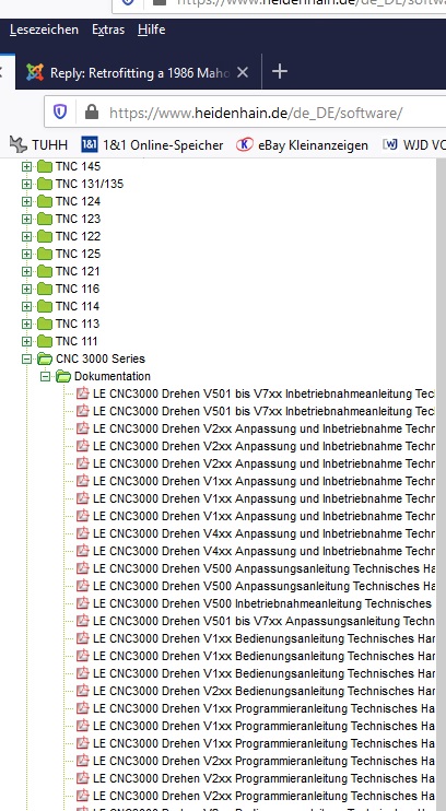

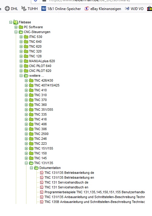

Hi there,
I finally got a place for my MH 300 C and have it running still using the 432/9. Unfortunatly the conversion sill suffers from a lack of spare time.
You should definitely have a look on this website:
www.heidenhain.de/de_DE/software/
Information on the TNC135 is more or less complete, also in english:
And for those of you fiddeling around with the Philips you have to know that this system was sold as CNC 3000:
V1XX to V4XX will fit to most of the 432/9, V5XX to V600 to 432/10 running a 80286 processor and V7XX for the 80386.
Good luck!
