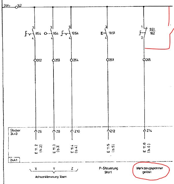

On my MAHO, there is a provision to add a foot switch for the hydraulic tool release. I couldn't find this in your schematics, but you could just add it in parallel with the existing hydraulic tool release button.
Basically just add a switch between pins 265 and 142. Something like this Industrial foot switch
If you retrofit this, you will have some things to deal with which I didn't have to. For example, I didn't have to give LinuxCNC control over axis brakes. The MH400E only has one of Z, and it's release is hardwired. LinuxCNC can do this (it can do just about anything), but you do have to get down and dirty with learning some new skills. If you really just want to use it as a manual machine with a DRO, try and get the TNC working, and keep it working.
