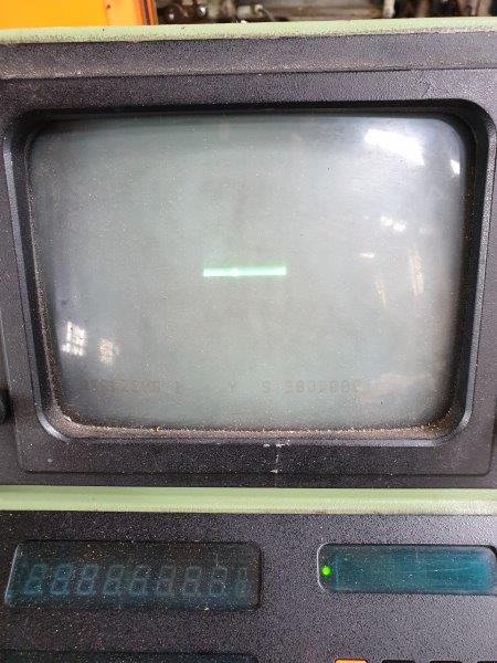

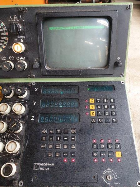

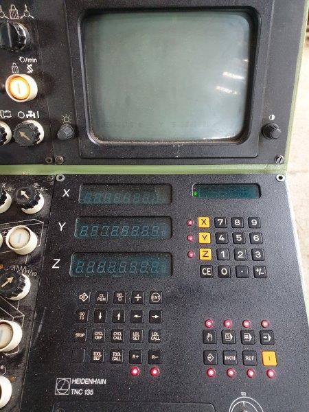

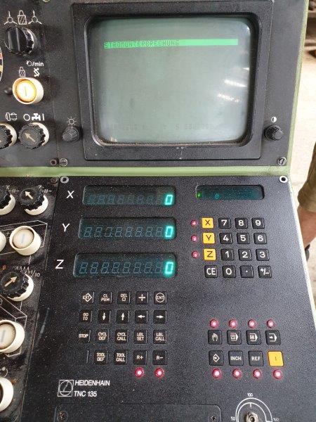

- BradMck
- Posts: 7
21 Nov 2019 17:45 #150851
by BradMck
Replied by BradMck on topic Retrofitting a 1986 Maho MH400E
Hi All,
Regarding ChrisMcM Maho MH 700C, the LS807 are connected directly to the TNC135 via a plug and socket located in the cable way of the machine.
I powered the machine and pressed the CE button twice and no changes to the display. We powered up the machine while pressing the CE button (Chris found this note somewhere on this site) and got some action on the display. . We cycled the power (left off for approx 30seconds) to the machine and let it complete the start-up without any buttons pressed to see the result and got no information on the Display We cycled the power again with the CE button pressed and got the following message We left the machine at this state for 30 minutes to see if the display would keep displaying the information this time there was no information. We managed to get the TNC to get stuck in a cycle photos.app.goo.gl/V4HRLgBcpmt2kFx49.Cycled the power again and got an image for a short period and then it faded away
Regarding Bob's reference to boilers, my background is boiler Automation nothing too big (up to 25MW).
Brad
Brad

21 Nov 2019 19:50 #150855
by J Green
Replied by J Green on topic Retrofitting a 1986 Maho MH400E
Brad
I think db1981 is the most knowledgeable as he has a TNC 135.
To me with the change over that time frame ,I would be checking the DC voltage buss of the several different supplies during the 30 minutes. Think I would leave the Heidenhan scales disconnected until the TNC 135 is in a more usable condition. The scales read heads do not need over voltage, also will show if a read head is causing the problem. Can you somehow have the TNC 135 opened up such you can lick a finger and probe for overheated IC , regulating transistor ,Tantalum capacitor (orange drop appearance) ? A finger is great for quick heat compare an contrast checking. Hope it is just a tantalum cap .transitioning into a high leakage state.
25MW boilers Guess you arn't referring to Mill Watt ! Walking around with a long handled broom checking for leaks is something I only want to hear about ,not do.
Bob
Bob
