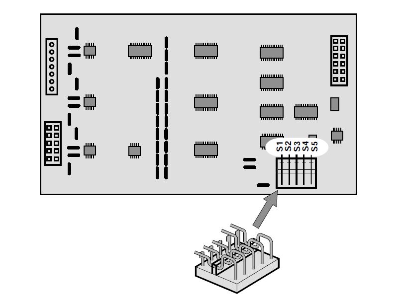

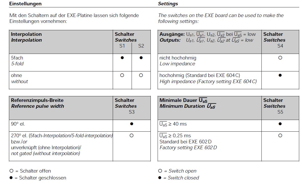

check pages 18/19 of Mark's manual. Switches S1/S2 are used to change between 1-fold (=5µm) and 5-fold interpolation (=1µm). I wonder whether they used the same PCB for both versions? If your 602/1-F has these switches it might be worth a trial.

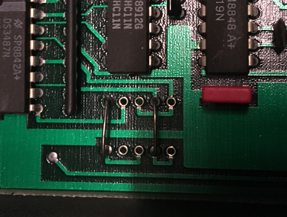

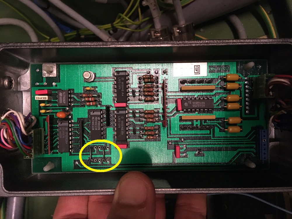

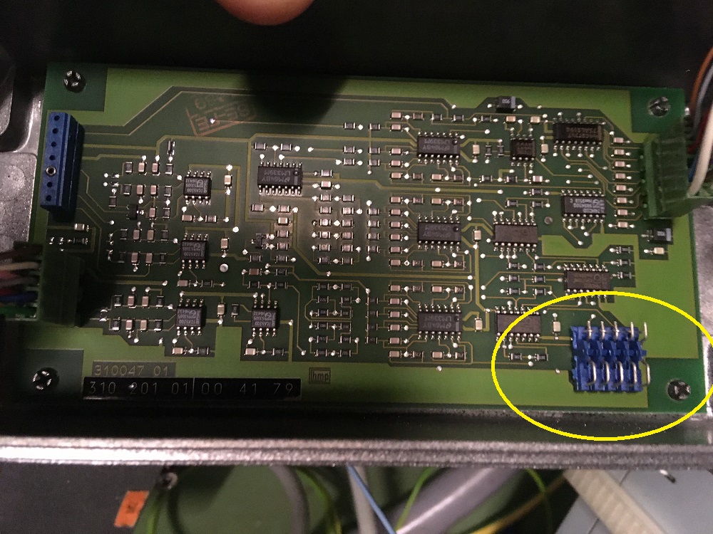

That is a great input Anders. Thanks. Given that a MESA 7i77 and 5i25 has no speed problem processing the higher resolution, this would be the way to go. If you want to get really crazy, the 660B series can be configured for 400x interpolation.
My 1µm 602D/5-F has the internal switches for selecting 1µm or 5µm resolution.
... whereas the 602/1-F is obviously older from the size of the IC's and has a row of soldered jumpers.
I would bet that a different configuration of jumpers would provide the higher resolution. There is provision for 5 jumpers, which matches with the later series 5 switches, but the change need to modify it from 5µm to 1µm isn't obvious, given that the jumpers from each end are currently one connected and one open, this does not map to the switch configurations of the later EXE's.
Mark
Mark
