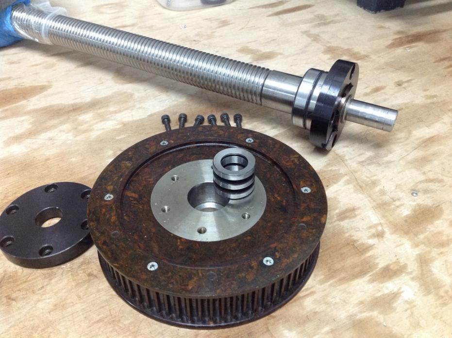

Replied by andypugh on topic Retrofitting a 1986 Maho MH400E
My 600E uses SPETH clamping sleeves type DS but noted that "Spieth" has a Type AK / IK an AL / IL clamping sleeve that may be what was used in your 400.
They look very similar too:
www.ame.com/clamping-sleeves-al-il
www.spieth-maschinenelemente.de/en/the-principle/
Says that they can be released and re-used at any time.

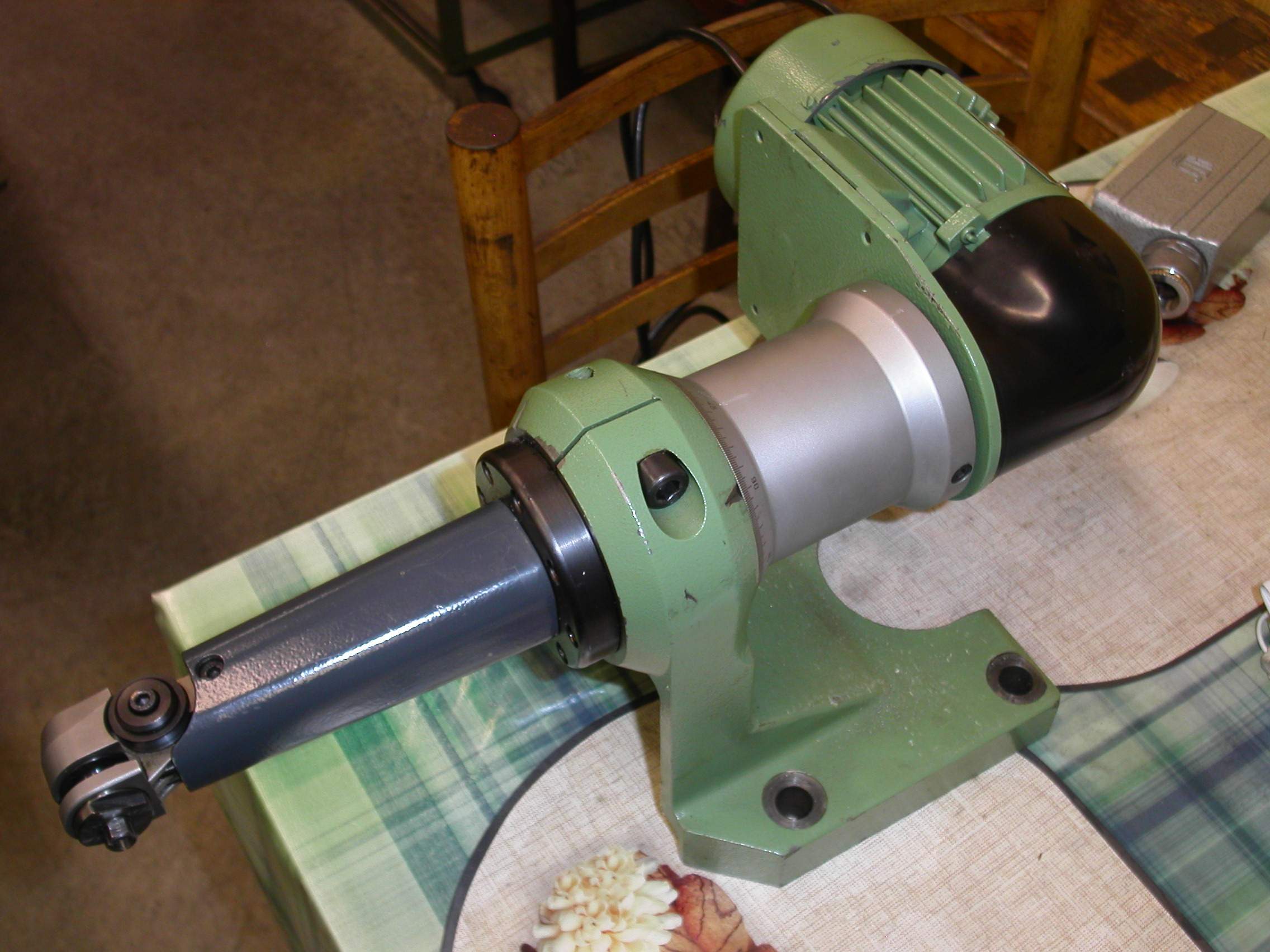

by RotarySMP

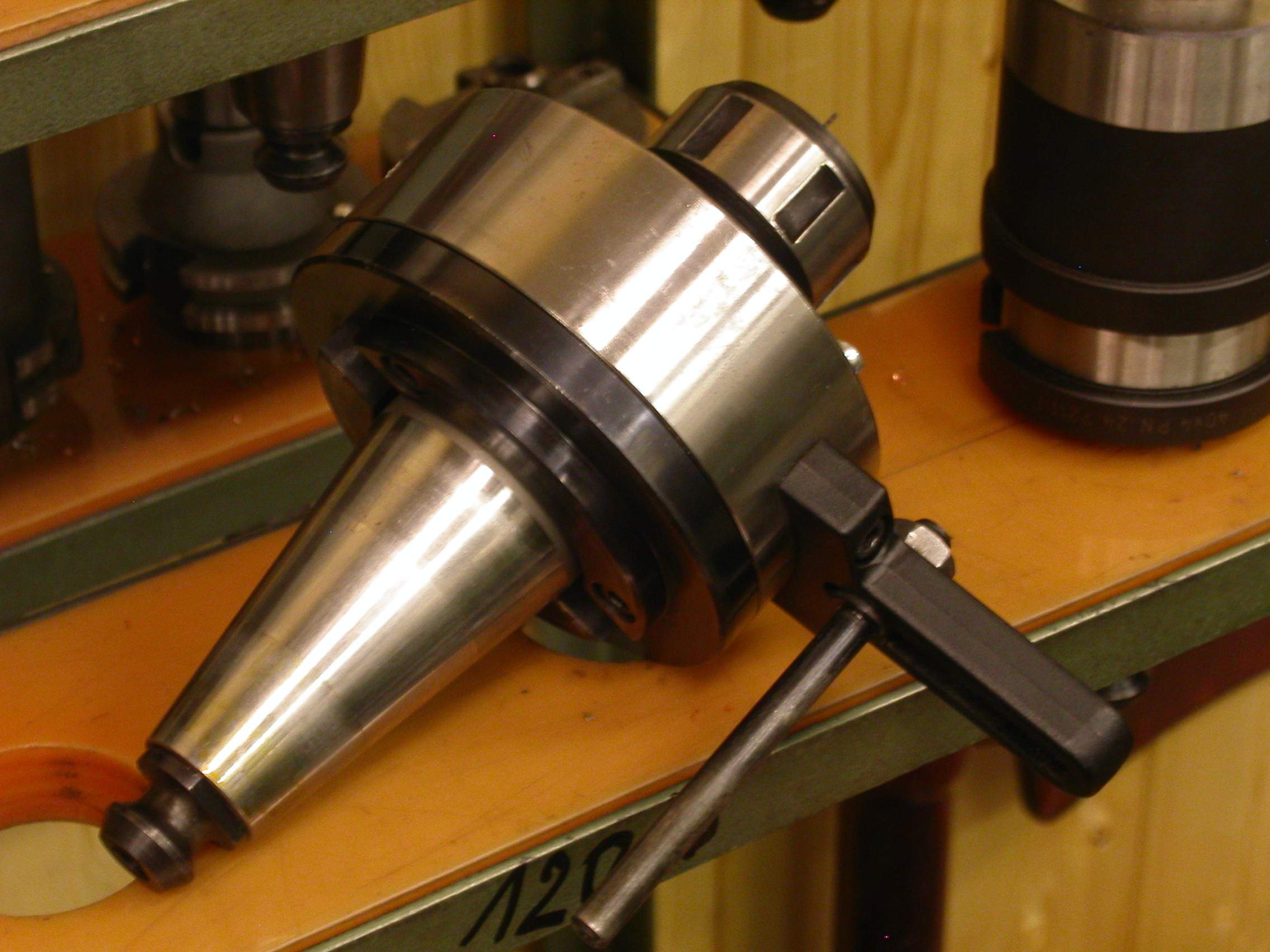

Must resist temptation...
A MAHO spindle speeder came up locally for a good price, but it had the DIN 2080 pull stud and not replaceable.
If anyone needs Vertical axis Ballscrew or bearings for an MH500, there is a set on Willhaben (Austrian Craigslist)
www.willhaben.at/iad/kaufen-und-verkaufe...l20df030t-355827960/
www.willhaben.at/iad/kaufen-und-verkaufe...l-y-achse-350696401/
Mark
