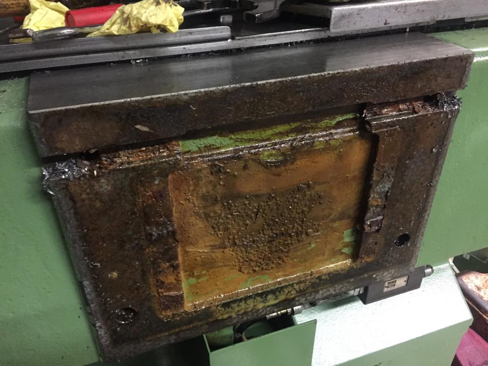

"no worries mate", I don't take your criticism personally
I just didn't know that the access is restricted in "cncecke" as I'm permanently logged in there.
A short explanation:
The screw came of a little bit too easy with no pre-tension.
The metal flakes seem to be of a cracked 3.5mm (measured 3.495) ball.
I ordered 3.506mm and 3.510mm hardened steel balls from "kugel-winnie"
Here they are:
Cleaned the table yesterday and will clean the glass-scale today.
Cheers

Wonder where that chrome came from? I hope it is not damage to the nut ball races.

I'm sure the flakes were much too thick to not be a cracked and mangled ball.
The surfaces on screw and nut are both "perfect".

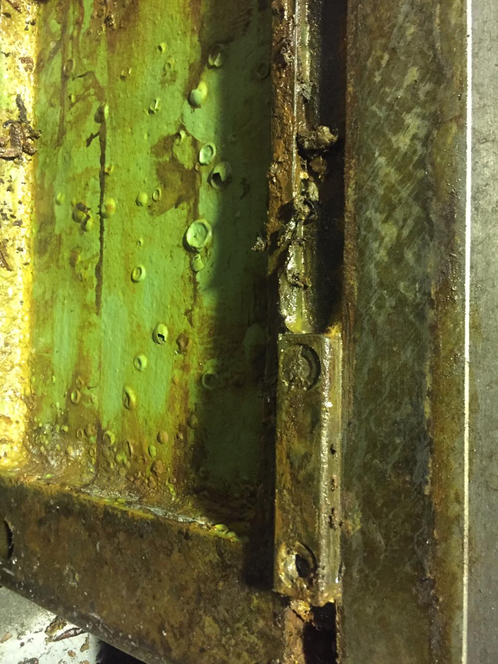

found it:
cloud.monschan.de/index.php/s/r8rZNKZYqLsJDw4
No comment !!!!!!
The same on the other side, still within range of travel:
Cheers

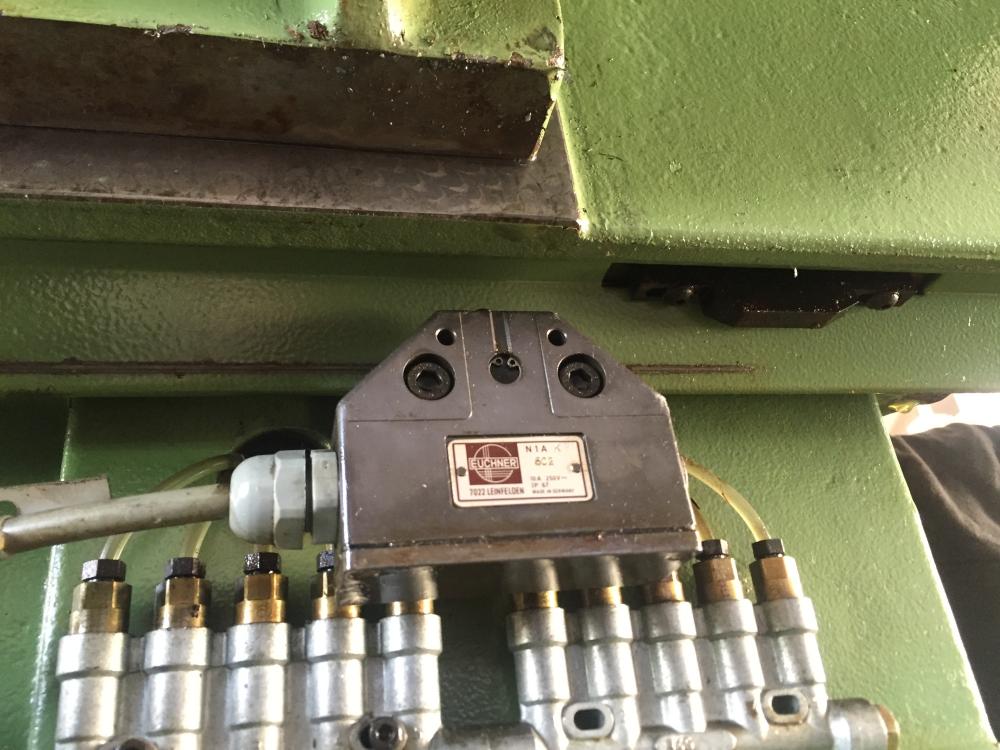

Hi there,
counted my balls today
240, exactly. As the ballscrew nut has 7 ball returns I expected the Number to be a multiple of 7 minus one or two cracked balls. I don't know how to interpret that result.
Anyway, I'll keep on reporting.
edit: FYI:The glass-scale was loose. I still wonder how my first parts came out so precise.
Cheers
