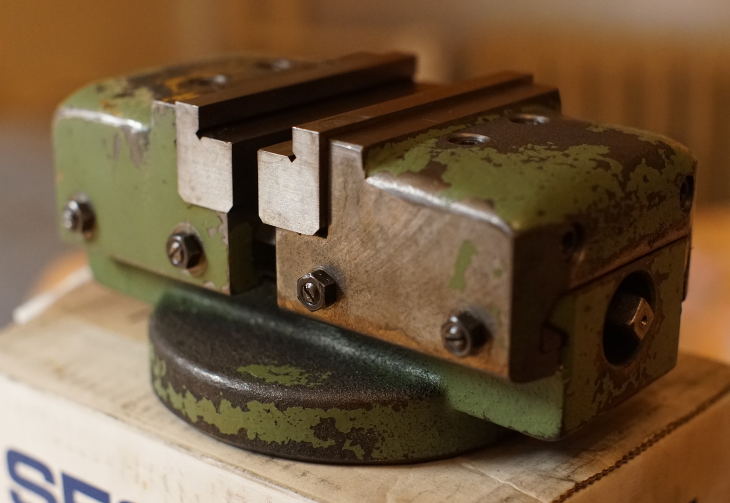

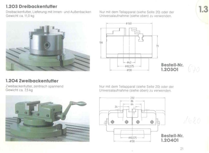

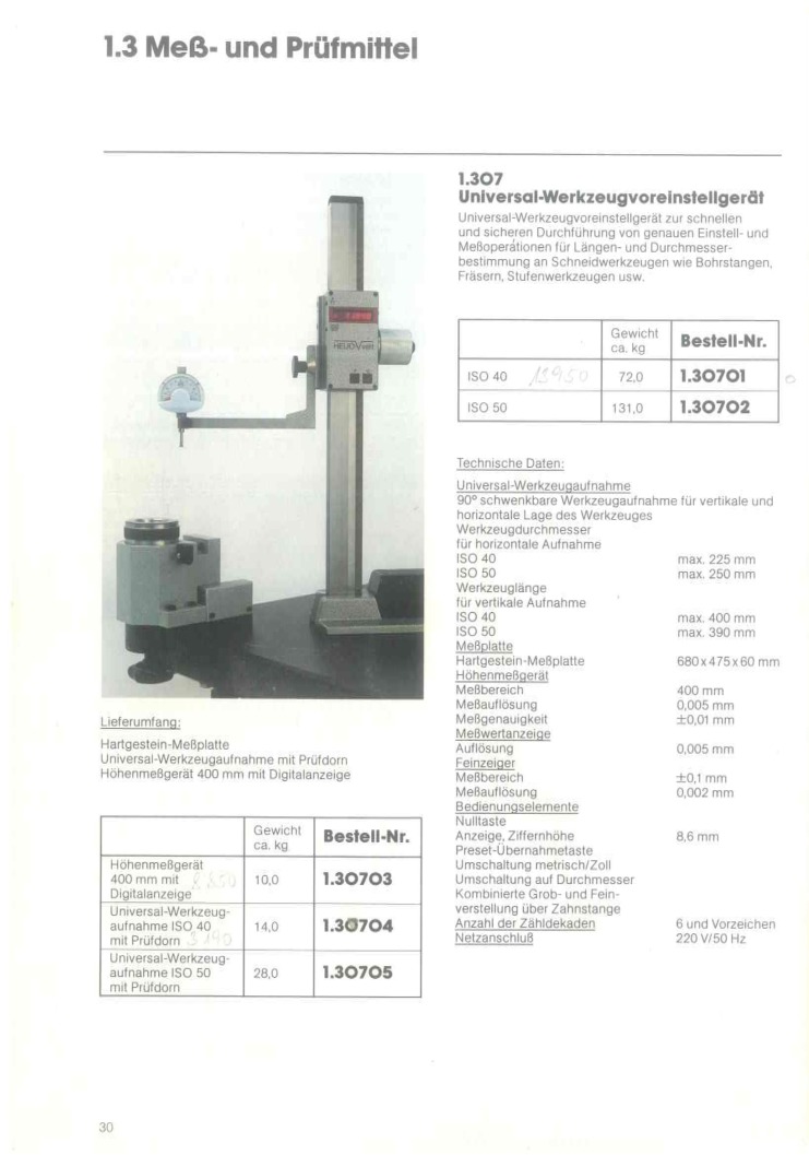

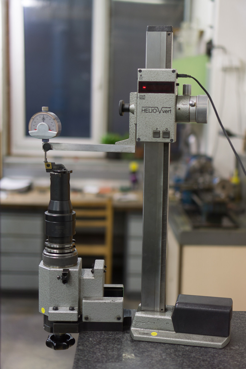

All real, used in the workshop .
J.N.
I have more brochures, larger than 1.6mb, where should I upload?

Some great pieces of kit there, thanks for posting Jannovv!
It reminds me of just how little stuff I have for my machine, though it's hard to justify the cost of getting accessories without having a concrete plan of action for them.
I still have a 1:6 spindle speeder that needs a toolholder...
