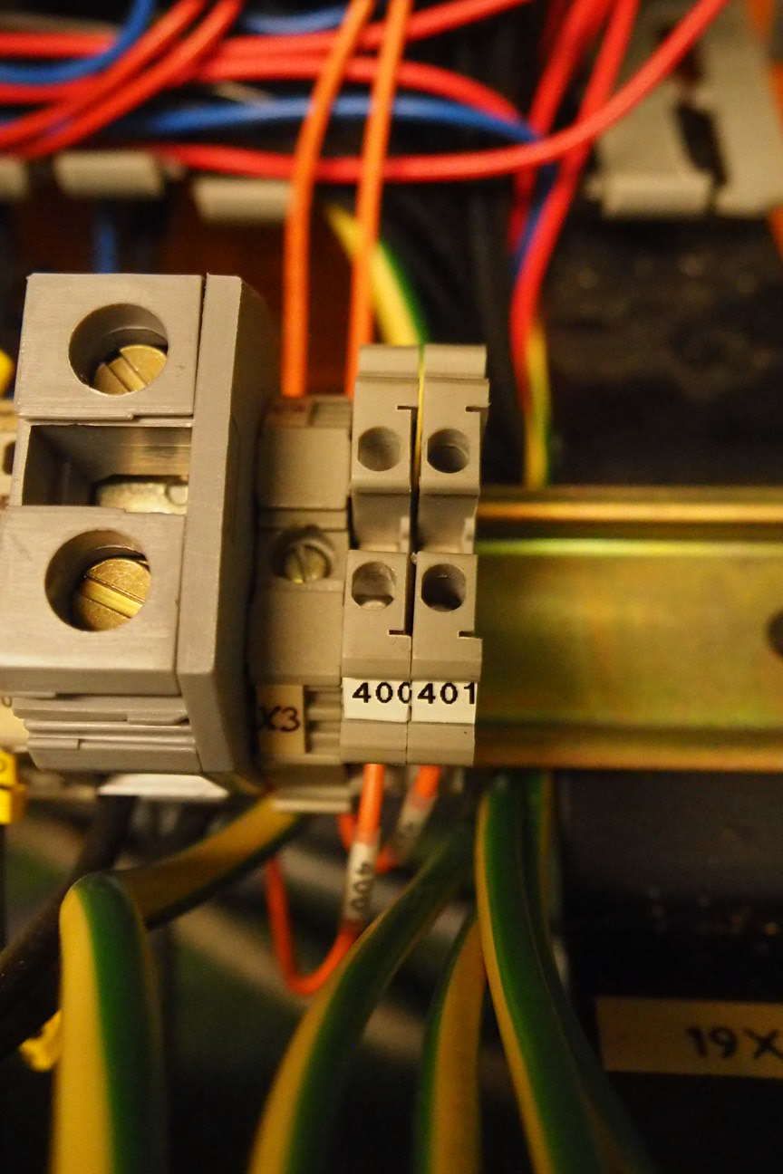

I installed that 204-264 jumper to replace the S3 Pendant E-Stop, and installed a switch to simulate the NC-Ready circuit between terminals 200-209.
The behavior is exactly as we discussed in this post.
forum.linuxcnc.org/12-milling/33035-retr...00e?start=150#100478
This works fine.
Mark
This works fine.
Mark

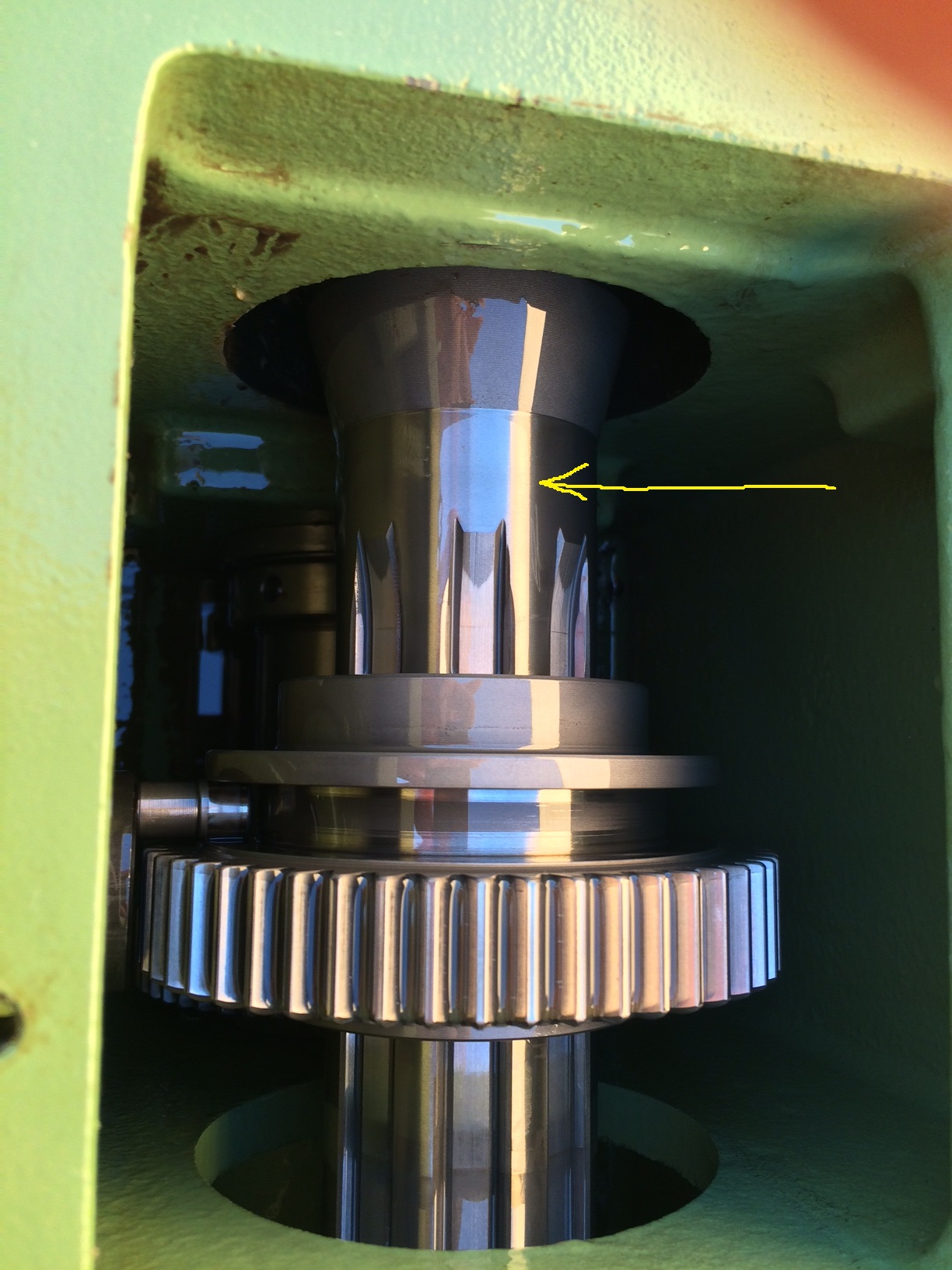

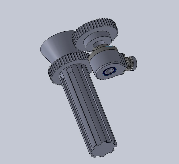

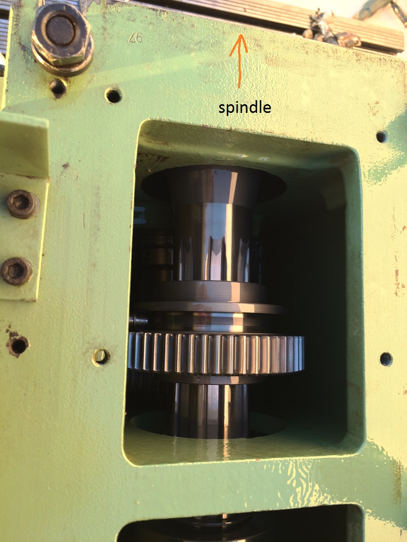

Hi guys, Bernd welcome to the club.
Good news with the test. This weekend I will check the estop and others circuits to detect any modification from the previous owner. I have found the perfect spot for spindle encoder if the encoder at the motor won’t work for rigid taping. I will put a pulley in there
And I will drive another pulley above with timing belt. This way i can use it for the horizontal spindle too

Looks like you modelled that in Catia. Nice. So is there an access panel there, and you mount the encoder on the panel, or do you have to some surgery on the casting?
Your 600E is incredibly clean.

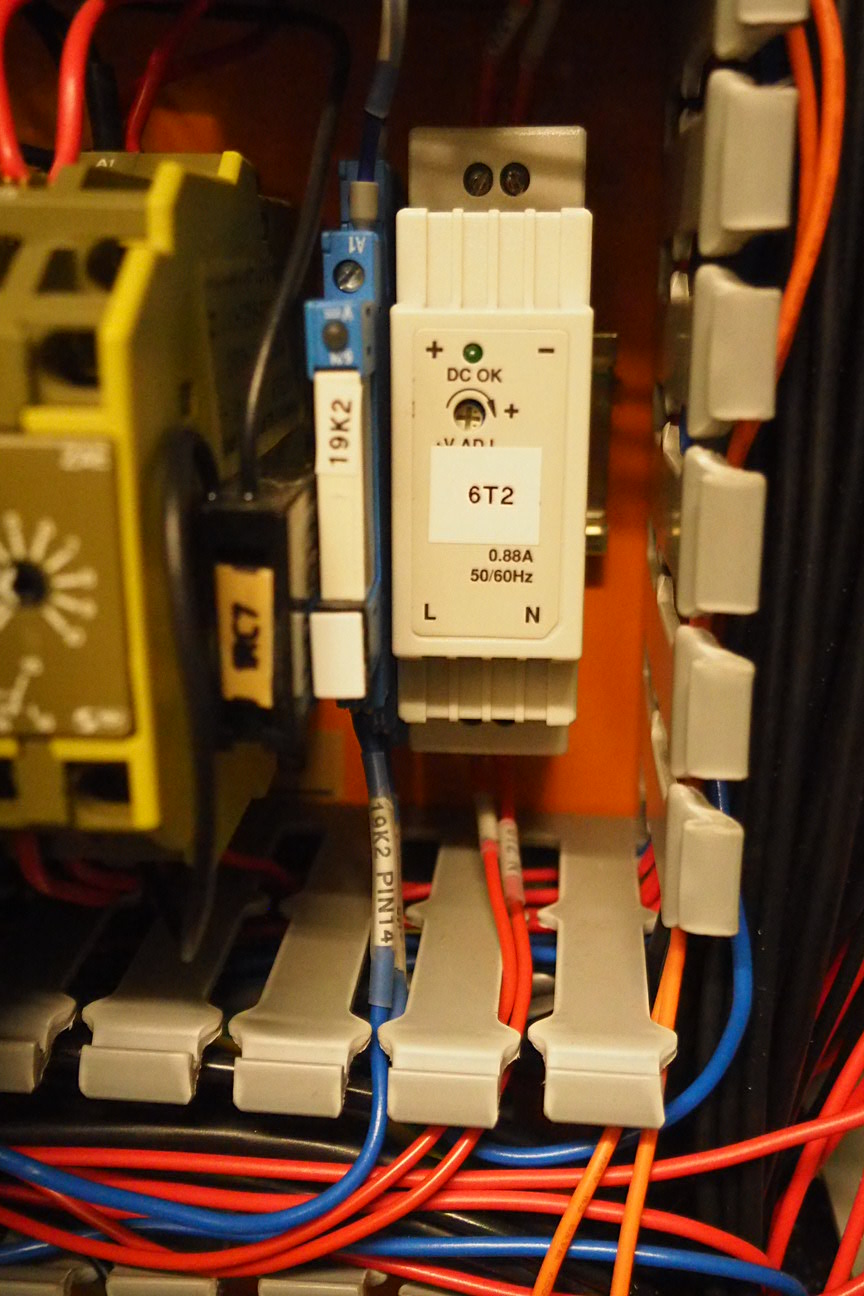

I did find a few minutes to finish wiring up the 5V PSU (6T2) and the "Drive enable" relay (19K2).
Mark
I have a busy weekend replacing the lounge balcony door and windows, so I won't have much chance to make progress on the MAHO.
Mark
