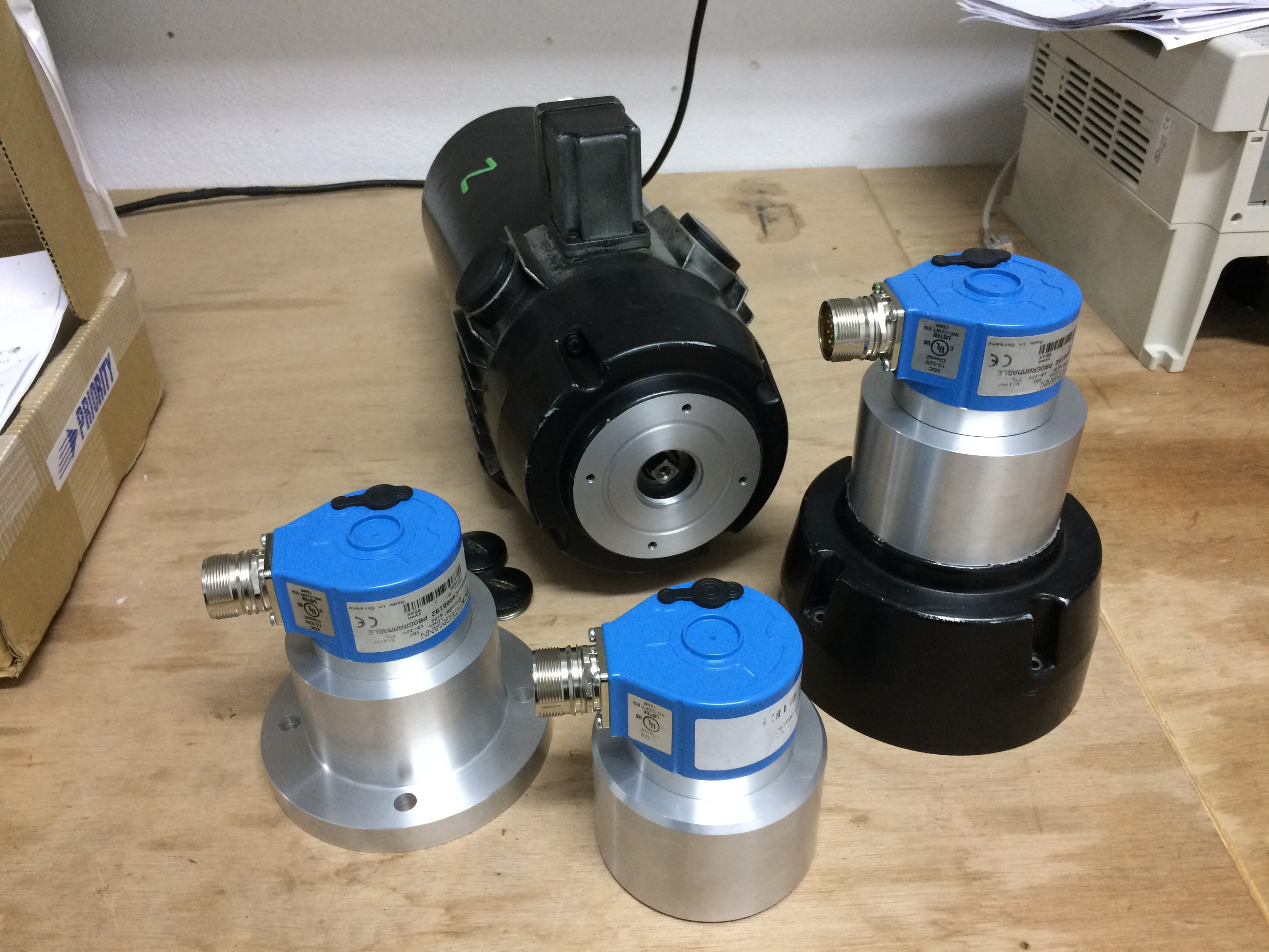

05 Nov 2017 18:40 - 05 Nov 2017 18:41 #101364
by drimaropoylos
I will post my configuration, with only 5i25-7i77 to test this, if it works in your pc than we will find what is wrong with the other.
Last edit: 05 Nov 2017 18:41 by drimaropoylos.
- drimaropoylos
- Posts: 265
- Thank you received: 39
05 Nov 2017 18:51 #101365

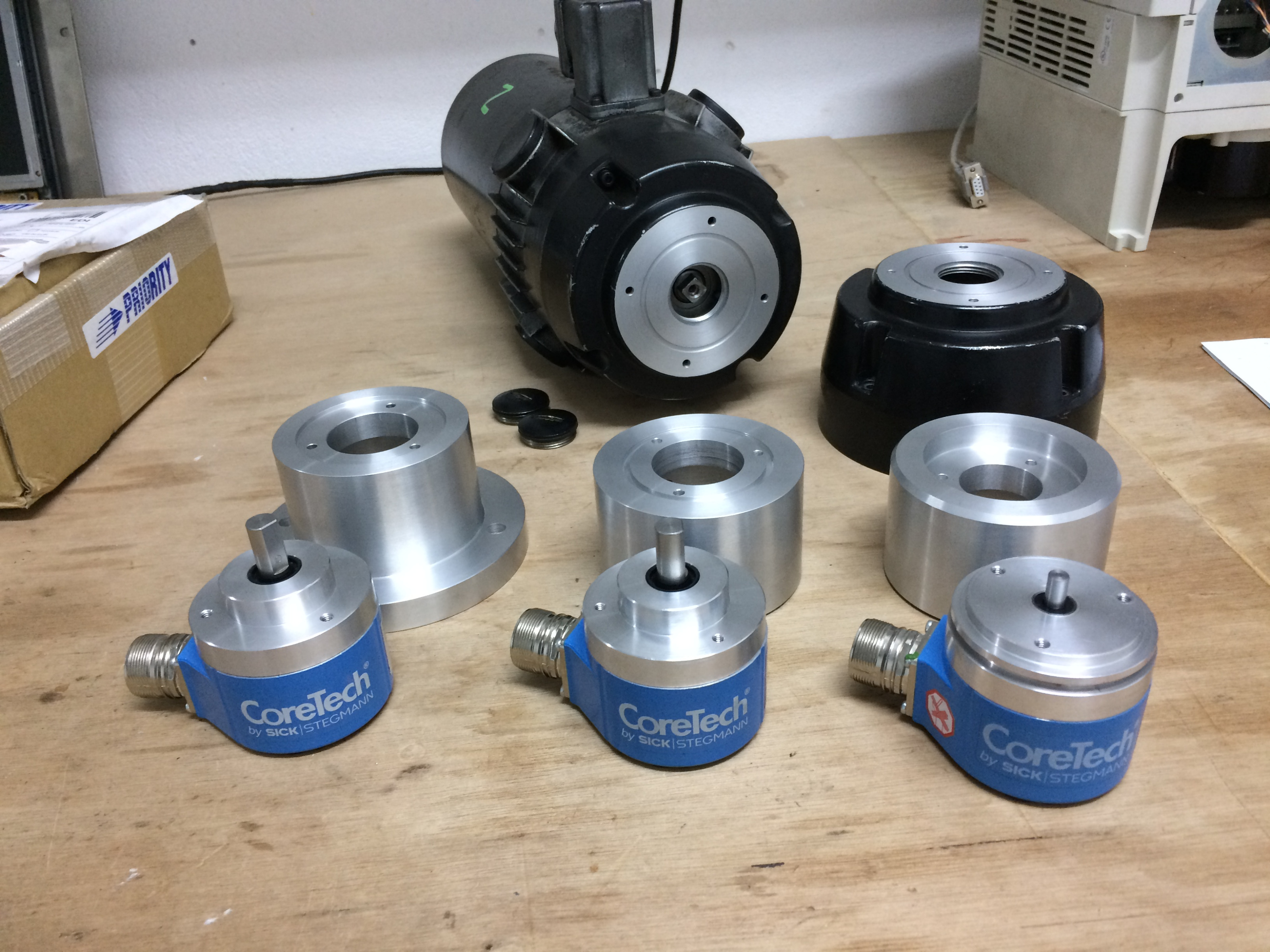

06 Nov 2017 09:06 - 06 Nov 2017 09:20 #101394
by drimaropoylos
Last edit: 06 Nov 2017 09:20 by drimaropoylos.
- drimaropoylos
- Posts: 265
06 Nov 2017 09:17 - 06 Nov 2017 09:18 #101397
by drimaropoylos
Last edit: 06 Nov 2017 09:18 by drimaropoylos.
- RotarySMP
- Posts: 1511
- Thank you received: 559
06 Nov 2017 09:20 #101399
by RotarySMP
Nice workmanship.
Is there any performance concern if I comment every line of my HAL file? I am guessing that a bloated HAL is no problem, as it is only read once, andI really want to build my current knowledge into my HAL as I expect in 2 years to have forgotten everything.
