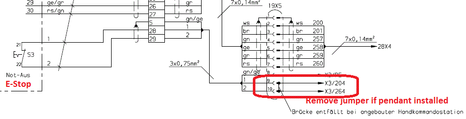

I now understand what the 7S1 switch is doing. When one terminal switch on an axis is triggered, the machine is disabled and the indramat can’t move the axis, but the L1 and L2 going into the Indramat with the 1.5mm² wires, gives the necessary power for the brake to release when the 7S1 is energized manually.

Thanks. Good call. I should have caught that, since I only just pulled that 19X5 terminal block a couple of days ago. Mine had no pendant, but that jumper was on the terminal block. Looks like I need a jumper between terminals 204 and 264 until I build a pendant.
Thanks also for the explanation of the 7S1 brake release circuit.
Mark
you probably have removed the maho pendant, and the estop on it is not closing the circuit to activate the K1. So the circuit for 7K1, 7K2, 7K3 can’t activate.
John
